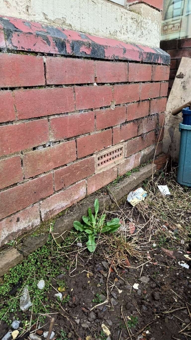

Intended to pave out the little front terrace but for the life of me can not figure out where the DPC line is so I can build it 150mm below it. It is a property built in the 1920's with a cavity wall.
I've dug out patches of soil expecting to find a visible dpc line, slate or different coloured bricks but so far don't see anything that resembles a DPC line.
Does anybody know based on the picture and age of the property where the DPC line would be?

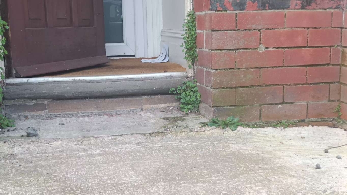

The DPC might be easier to see beside or under the doorstep

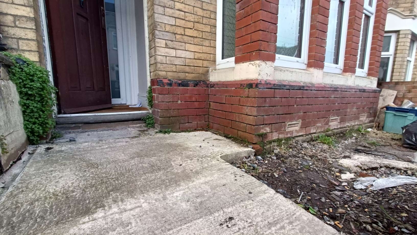

Stand back and take a wider pic. Clean out some of the mortar joints with a hose so you can look inside. It might be immediately under or above the airbricks.
Looking at the bricks, the lowest ones seem to have lime bloom that does not seem to show on the course above, so it might be the dpc is between them. Are any of the bricks very hard and shiny? Are you anywhere near a canal to Accrington?
Hi John. Thanks for the reply. Yes I'm on a hill and under the doorstep I can see the bricks are a different colour than the bay window. Theres a single row of yellow bricks under the doorstep. Would that be the DPC line?

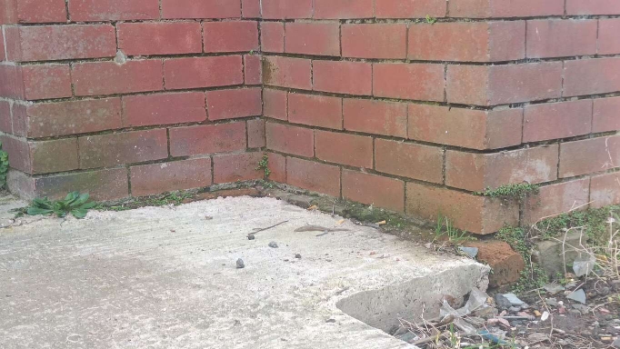

Got late last night but here are some more pics.

I can't see it, but I think your existing concrete path is already too high. This is a very common mistake. I think it is flush with an old stone step, so the original ground level will have been around ten inches lower. The mortar joint fractionally above the path may be a little thicker than the others, and looks long-term damp, from the colour, the vegetation, and I think I can see a drill mark where a futile attempt to use silicone injections has been made. So I think you need to dig out another foot, and hose out the mortar joints. Old lime mortar is prone to wash away over time if it is wet, and needs repointing.
It's possible, but IMO unlikely, that your house was built without a DPC. In London they were compulsory from 1875. There were regional variations but your house build looks quite ordinary. The quality of the original brickwork on the front elevation looks high.
The air bricks do not look original to me, I think they were an attempt to reduce a long term damp problem. Have a look under the floor. Plot the route of the incoming water supply pipe, which will often start leaking when 60 to 100 years old. It may run under the hall floor. If you are on a slope the source of water may be running down. Do you have a water meter?
Look for any source of water encouraging that lush vegetation, such as a gutter, porch roof or downpipe. The roofs and gutters on bay windows are often in poor condition. The stone (?) wall between the front door and the bay looks dark, as if there is water coming from above
Some of your neighbours with similar houses may show the original ground level, or an old path. Or old drains, gullies and manholes will show it, though if they have been leaking they may have settled into the ground or had concrete incorrectly laid round them.

Thanks Johnd. I've had a look around a lot of the neighbours houses and they all seem to have this one course brick under their doorstep and then a ramp path leading to the pavement.

I think you should dig against the house wall until you can work out where the original gound level used to be, and lay your new paving to match. While digging, look for any broken drains or leaking pipes. If you find the footings are very shallow, you can dig out short stretches and pour concrete.
I think there is an extra problem, looking at the vegetation growing in the wall, that there is a source of water, likely a leak, that needs to be repaired.
Additionally, the brickwork needs the joints washed out and repaired. You can clean out the dirt and perished mortar with a strong hose, but the brickwork is very fine and deserves a skilled and careful workman to restore its original beauty. To my eye the joints look too narrow to use a pointing gun, and lime mortar is preferred as original. I would use cement mortar below the DPC (if you can find it) as it is more durable when wet.

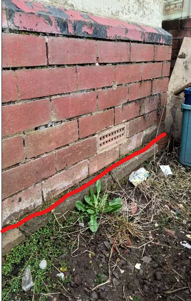

May well be. Or the joint above where the lime bloom abruptly stops. Give it a squirt with a jet washer, or a nylon brush.
OP,
Use a very thin broad blade screwdriver to scrape a few mm's out each mortar bed until you hit a bed with some kind of a DPC.

The (official) DPC will be directly above the airbricks. There will also be a subsidiary internal course DPC below the timber floor joists, sitting two courses lower than the (official) DPC. However, it also can depend upon how the builders foresaw external ground levels in relation to floor joist height positioning as to whether they kept internal and external DPC positions the same. A lot of these timber floor houses had a large step up into the property hence the lower (beneath the joist) position of the DPC, inside AND out.
