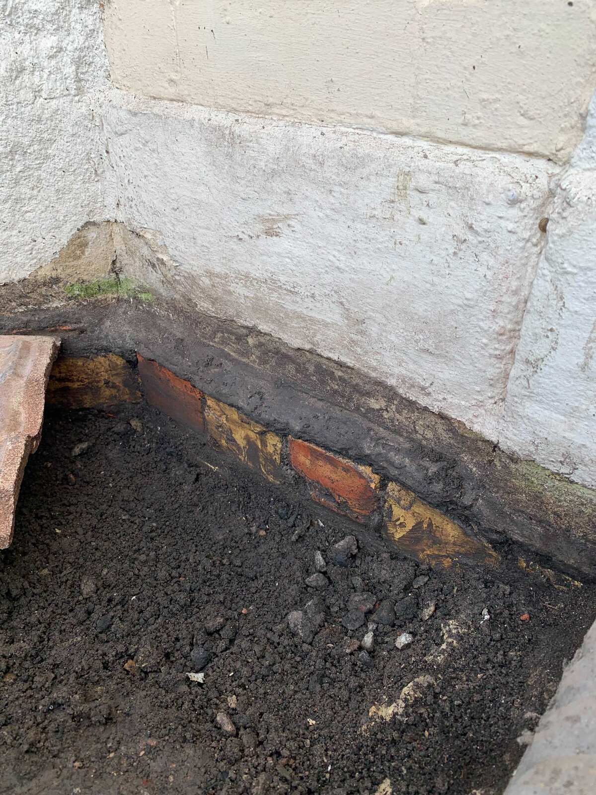

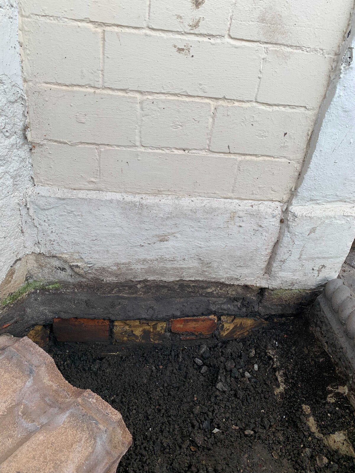

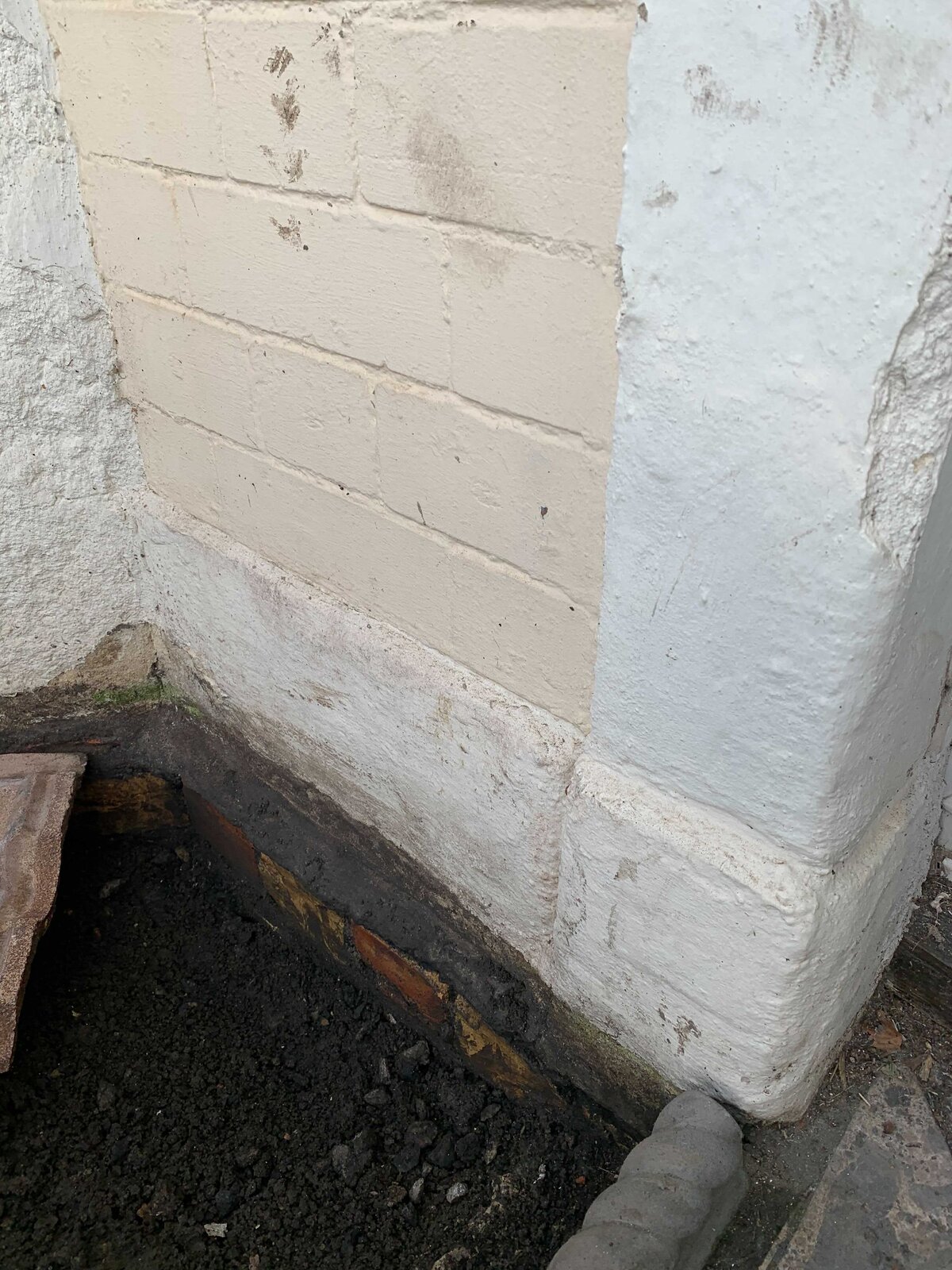

Situation
I am currently renovating a 1901 Victorian terrace house. It has all the classic problems with a property of this age such as damp in rooms etc. The front bay is particularly bad with damp.
The soil level was extremely high at the front of the house (bay) when we moved in. The soil was even a little over the airbricks.
I have dug down to see if I can find the old DPC (if it even has one!) and definitely have found what appears to be a black horizontal line going across the brickwork.
Question / Advice
Can anyone confirm if this is indeed slate DPC? I believe a house a this time would have used slate.
The Plan
If this is the DPC, my plan is dig a channel (150mm away from the house) and at least 150mm below the DPC (general building guidlines). Line the channel with a geomembrane and re-fill with pea shingle (to stop splashing of the rain and help with drainage). I will then slope the rest of the front garden away from the house.
Any thoughts, advice would be most appreciated :)

It looks like the fillet of mortar on top of the brick plinth is what you call the dpc, so you could chip away at that to reveal the slate dpc, if there is one, and then decide how to reinstate (150mm depth as you say). The fillet was likely added to throw rain off the brick, or as a feature before someone decided to build up the soil. Is the floor inside solid or suspended? If the former there may well be damp coming up from the ground if it was not protected by a membrane. If the latter, there might be rot in the floor joists and beyond. Just some pointers….

Your images don’t show any dpc, you may have to inspect the mortar fillet to see if you can see slate or probably bitumen For that year.
As for the trench you are suggesting, it won’t hurt, just don’t fill it in with pea shingle, it’s too small and in a year or two will be solid again.
Use large pebbles, not 20mm gravel either.

I have inspected the mortar fillet and it's pretty tough. It looks like and feels like coal or asphalt (which makes sense as I am in Bristol in a coal mining area). How would I tell if it bitumen??

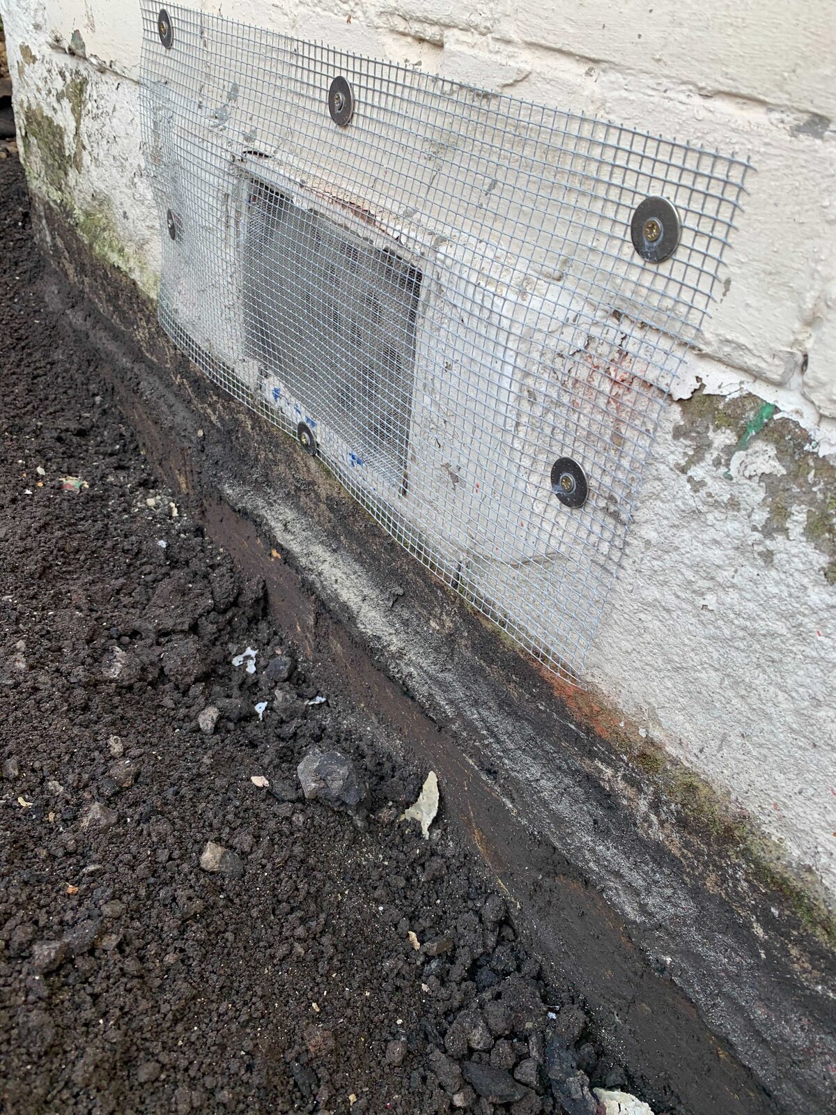

Regarding ventilation, I haven't dared take up the floorboards yet. There is evidence of worm on a couple of floorboards downstairs (but no present evidence) looks like they had an issue and had it resolved. The airbricks are most likely in need of clearing out on both sides of the house.

On further inspection, I think it is Bitumen. Mainly as it looks like its been layered on like a liquid... still unsure how I can be certain that is the dpc :/
Yes, think You’ve found it. Sounds like mine, 1900’s.
Don’t worry about unearthing the bricks.
The air bricks want attending to, as does lifting a floorboard to see what’s what.

With regard to the air bricks make sure they are below internal floor level. It sounds odd but occasionally they don’t line up

1. I can confirm that Bitumen was definitely used as the DPC, I chipped away at it, I also confirmed with builder who was walking by and worked on houses of a similar age (I also confirmed once I lifted the floorboards)
2. Lifted the floorboards around the bay, the previous owners stuffed insulation (non-breathable) on all the air bricks from the inside (no wonder there was damp inside!) so no air was finding it’s way to the sub floor
3. I’ve cleared out the air bricks, the air is flowing loads into the sub floor now
4. Plan is lower the soil level still and lay some slate tiles sloping down away from the house
5. I’m going to replace the air bricks wi the modern styles that allow more air to pass through (I may even fit a telescopic one to ensure air makes it right under the sub floor void

The bitumen DPC is probly in good condition but its maybe being bypassed by capillary action on the outside wall surface.
The fillet might need removing or renewing. can you pic where you've chiselled it away. Pic to show the bitumen and any brick ledge that the fillet sits on?
The plinth was installed to help prevent rising damp - plinths cause problems with damp not solve them.
Can you post pics of the whole bay at ground level and the bay at floor level inside the house?
