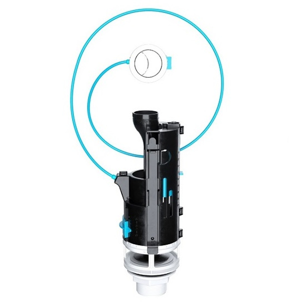

Longest I have found is 570mm. Does anyone know if longer is possible and where to get it? I need about 1.5m...
Saw one at 800mm... https://www.toiletspares.co.uk/nis-long-cable-valve-800mm.html
Pneumatic flush valve operating pipes may be extendable that long?
(Mind, we found the new pneumatic Torrent valve in our ensuite was hard to depress so I bought a battery-powered contactless unit for it. Longer pipes I suspect would make it even harder).
1.5 metres is some 4 foot away from the cistern .... Why that long? Just curious.
Was going to have a back to wall toilet in the smallest even ensuite with the cistern in the neighbouring bathroom. I actually found that some macdee cisterns have 1.5m pneumatic tubes, so hope that helps anyone who is googling for a similar thing
