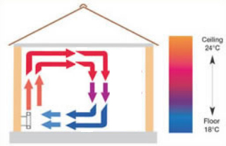

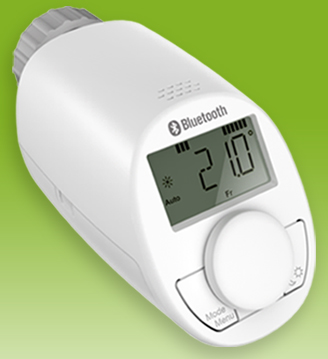

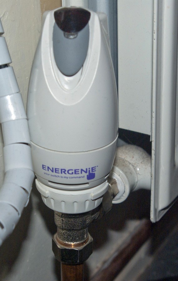

Also you must realise the TRV sets room temperature, air circulates in the room, so the temperature of the return air is the best temperature to measure to reflect the whole room temperature circulation3.jpg and the TRV is ideal placed to measure that. I use cheap electronic programmable TRV heads 61dmtMm13BL.jpg cost me £15 each, only down side is 18 x AA batteries every year. There are more expensive versions, this one IMGP8035.jpg connects to wifi, so I can see room temperature when away from home, and also use geofencing, I do check room temperature in the summer and decide if I want the AC on before I return home, and am told I can use IFTTT to get it to auto turn AC on, but heating wise I rely on the wall thermostat to turn whole boiler on/off so really being able to alter using wifi rather than blue tooth is very little advantage.

Looking at geofencing, to be any good, it needs to reheat rooms which are going to be used on arrival home in the time it takes you to travel home, so it will need to hold the room at a temperature which relates to your distance from home, if your travel time is one hour, then it needs to reach target in an hour, if it can raise temperature 5°C in an hour, and target is 22°C then it has to hold the room at 17°C while your out. If however only 2°C in an hour then 20°C while your out, this means often simple time is often better. So with the TRV head I have IMGP8035.jpg the anti-hysteresis is OTT so set at 22°C for an hour then 20°C to get room to 20°C so don't need the clever algorithms.

So we use a compromise to suit our home, and to do that you need to understand the system, I was intending to fit Nest in mothers house, first was to be Energenie MiHome TRV heads then Nest which at that time worked with those TRV heads, but the heads worked so well, never bothered with Nest, when house was sold new owners did not want the electronic TRV head so they were brought here, and I needed a wall thermostat so got Nest, however in the mean time Google had taken over Nest and it no longer works with Energenie MiHome TRV heads support has been withdrawn, so the cheap £15 bluetooth 61dmtMm13BL.jpg actually work better than the Energenie MiHome TRV heads. I keep repeating this I hope people learn from my error. Don't get me wrong Nest Gen 3 works well, and once the remote temperature sensors are released in UK it will work better.

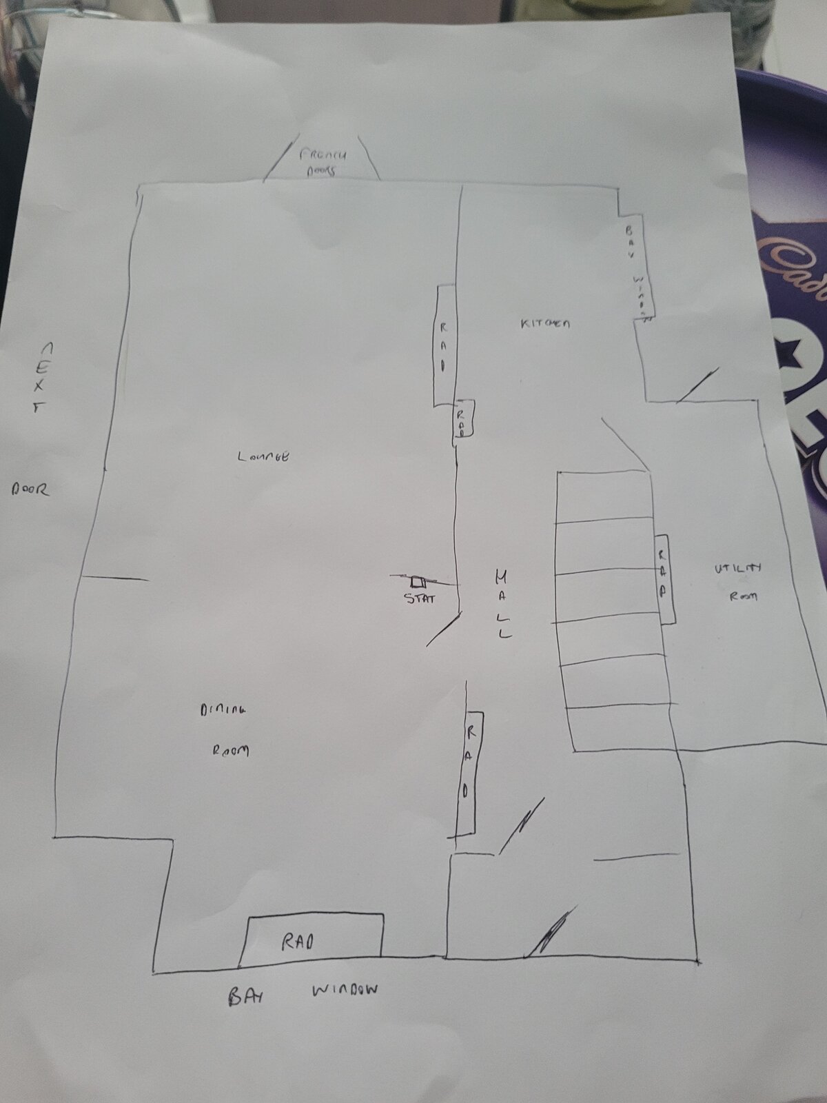

All the rads have trvs except the bathroom and kitchen and utility room. They are lockshield. Il do a drawing of the downstairs as to where the stat is and doors and openings. I've moved the thermostat into the hall today to monitor what the temp is during the day when the heating is off. It's a wireless thermostat which I'm guessing you've guessed because it's easy to move. It's a condensing boiler. The stat is programmable as to times when heating comes on and when it goes off. So we have it set from half 6 until 10 in a morning at 21.4 in the living room. Then 10 until 3 is set at 19. Then from 3 until 10 It's 21.4. You can't set it to off you set times and times. Through the nights it's set to 12 but the heating never comes on which is what we want. So from 10 until half 6 it's set to 12 degrees. Il do a drawing of the house layout
The space where the stat is located, should not be fitted with a TRV. Failing that, you can simply removed the head of a TRV and it will have the same effect as no TRV being fitted.
I forgot to say all trvs are fully open and set to max. Here is a pic of the house layout
