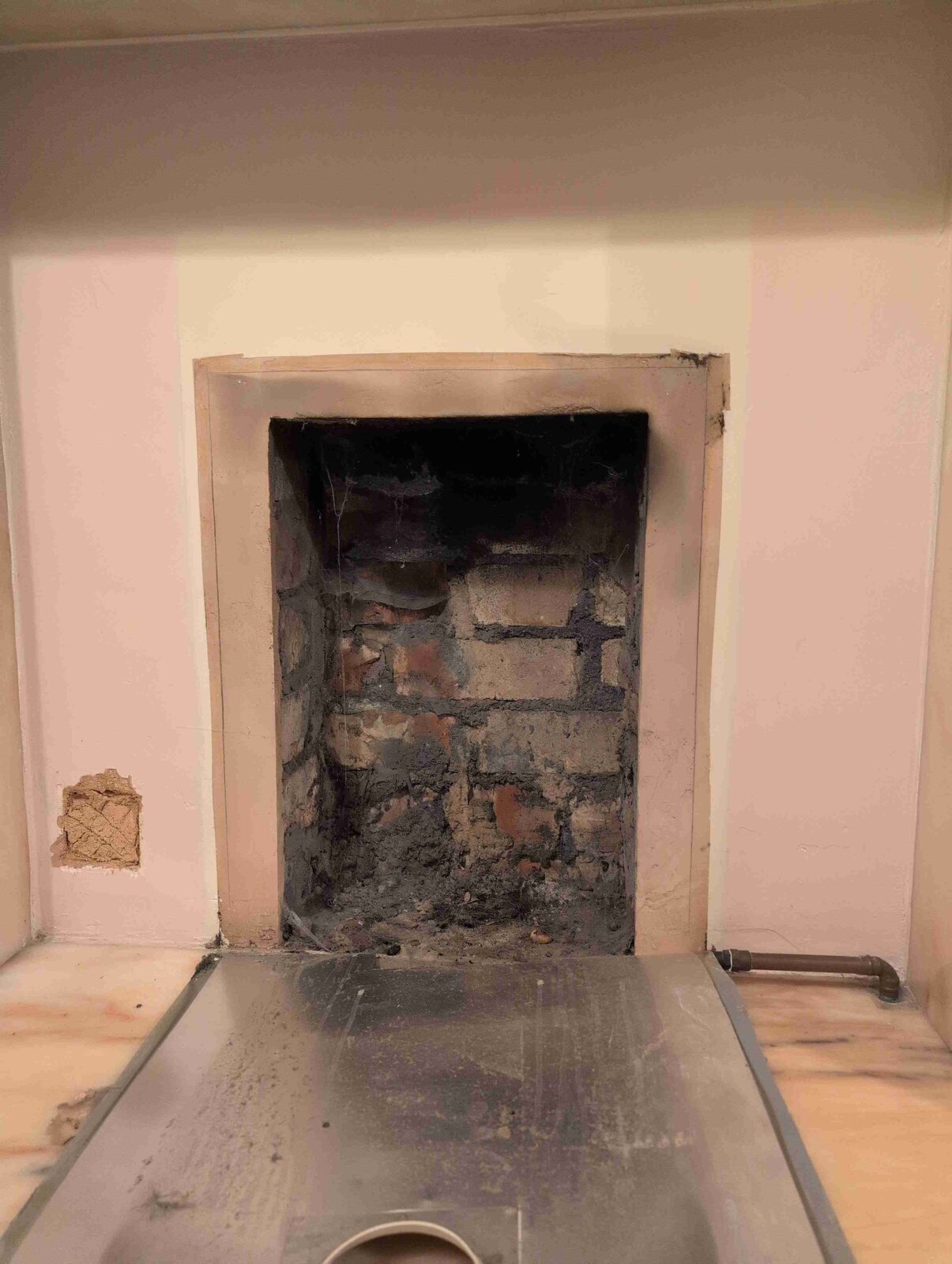

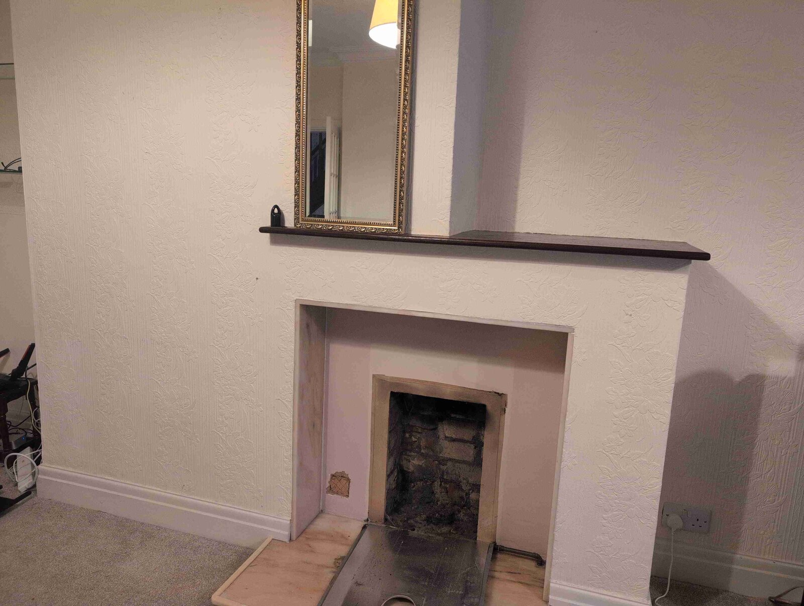

- In the 1970s the owners moved their gas fireplace in the living room a little away from the chimney so it would be centre of the room after an extension. I had hoped to swap this out for a log burner but two tradespeople advised that this is not possible. The original chimney would have to be reopened but this would be both expensive and up the wrong end of the room. I am planning on getting the extended bit removed, leaving the original fireplace blocked up.

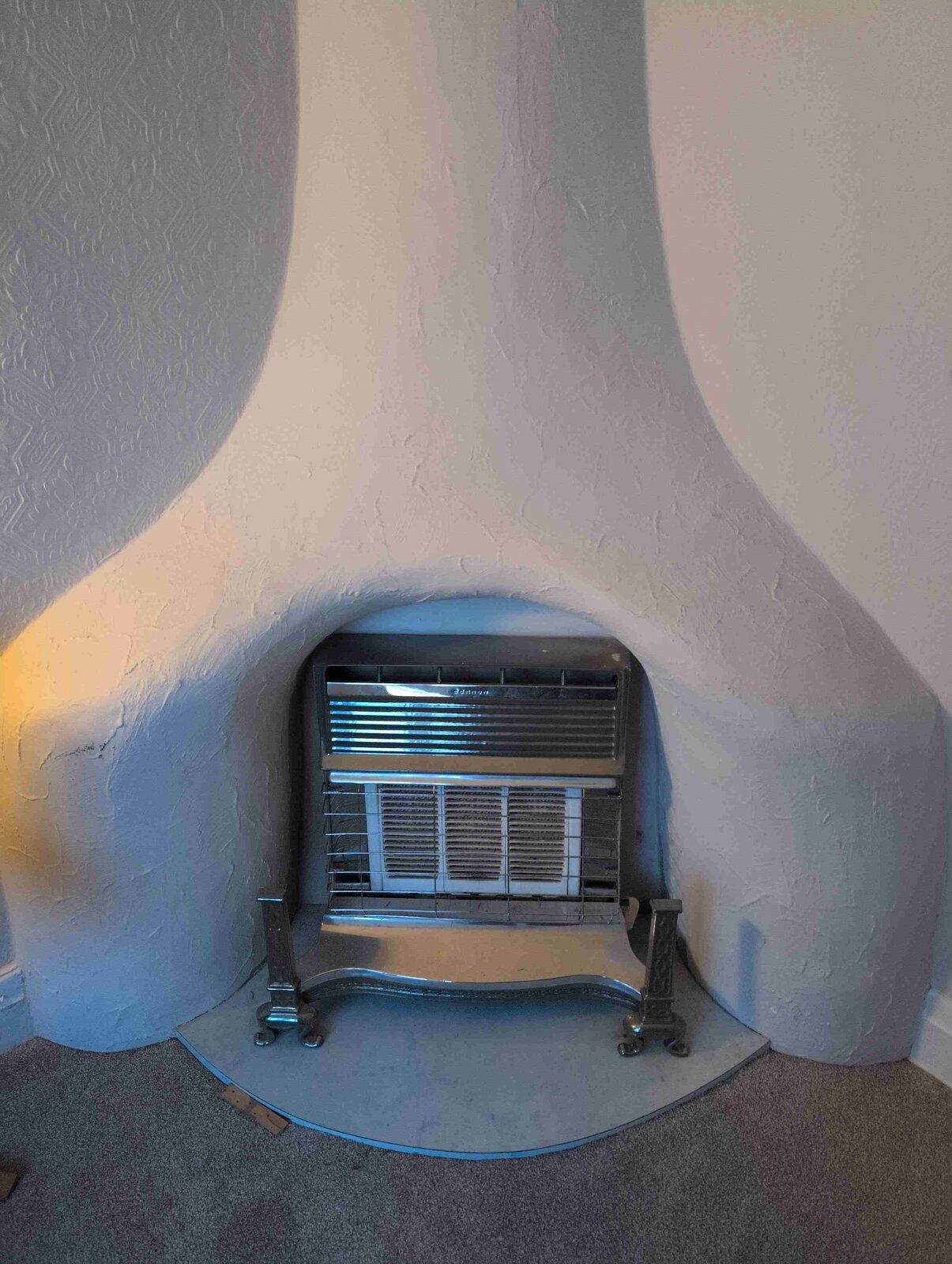

- In the front room there is an odd feature build around a non-functioning gas fireplace. Seeing as we can't get a log burner in the back room it would be great it we could swap out the gas fire in the front for one. Is it worthwhile getting people in to quote?

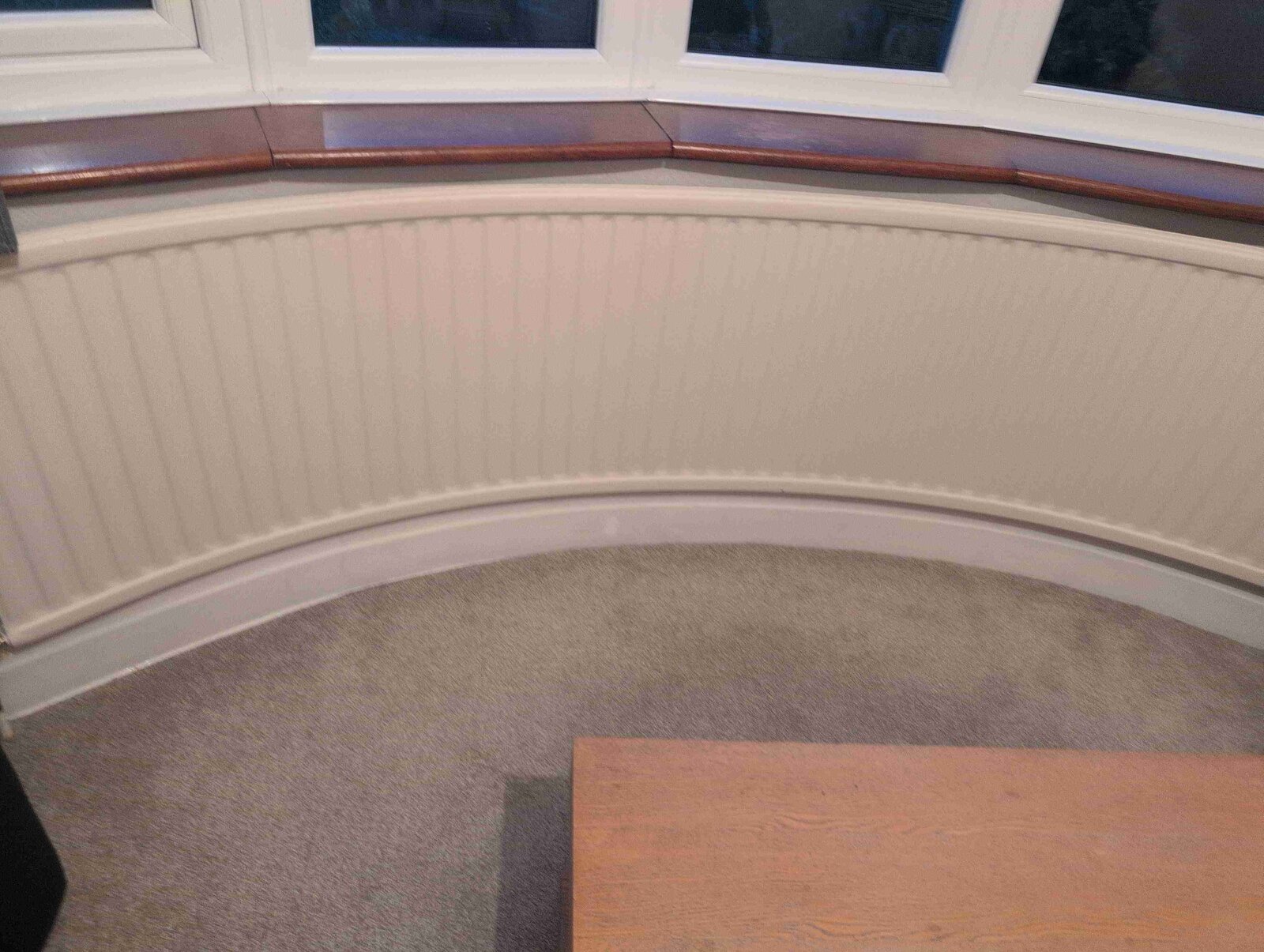

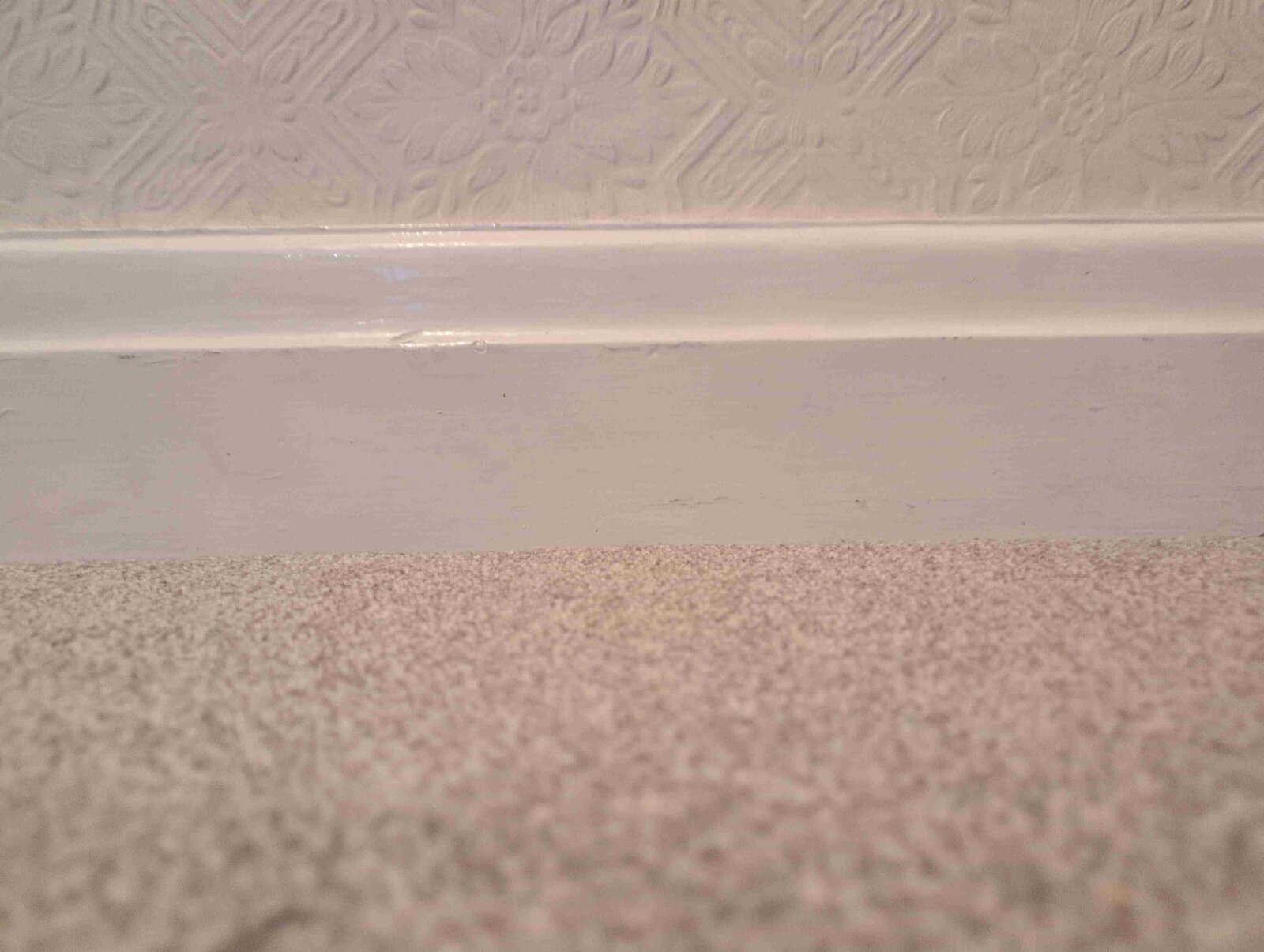

ii) We hope to get wooden floors installed in the sitting room and front room (maybe the hall too but there are old tiles underneath at least some of it that we would like to keep if they are in good enough condition). We have tall old looking skirting boards throughout the house, I am not sure if they are the original. I imagine these will have to be removed for the flooring. In the front room we have a bay window.
Yes, get a recommendation for an installer/builder from a stove company, or even a chimney sweep.
Flooring can be butted up/scribed to existing skirting, or a small fillet place over the gap. Or remove the skirting and push flooring underneath, however this will raise the skirting height unless you trim the base. Old skirting might be difficult to remove in tact in some places because they were often fixed with nails into wooden wedges in the brick.

i) That sounds like a good approach. Now I think about it further I am not sure how interchangeable the gas flue will be for a log burner one - it currently runs up through boarded off corner of a cupboard inside a white flue of some sort. I'll get local chimney sweep/sintaller in as a you suggest to advise.
ii) I think you are right about removing the old skirting being a big job, but my concern is that going up to the skirting seems to be discouraged and looked down upon in forums like this. If we did get the skirting up, is it easier to trim the old or get new skirting installed?
If the skirting can be saved it is worth keeping to match what is the rest of the house. It is also likely to be deeper and thicker than the stuff you get in the sheds. You should be able to save it with careful prying.

You mention a log- burner, but these are very polluting and regulations preventing their use keep getting tighter.
You can get multifuel stoves with clean burn that are much more efficient. I used to have a Swedish one they called a "smoke eater." I think it was a Morso. Somehow it prevented the glass getting sooty. I was in the country and could dispose of some kitchen waste in it, and in winter kept a couple of sacks of smokeless fuel to use if weather was bad. Mine also heated the hot water cylinder and bathroom radiator, but you will not need that if you have a gas boiler.
As technology and regulations are changing, look into it. Find a reputable local supplier. Chimney sweeps often know reliable firms.
