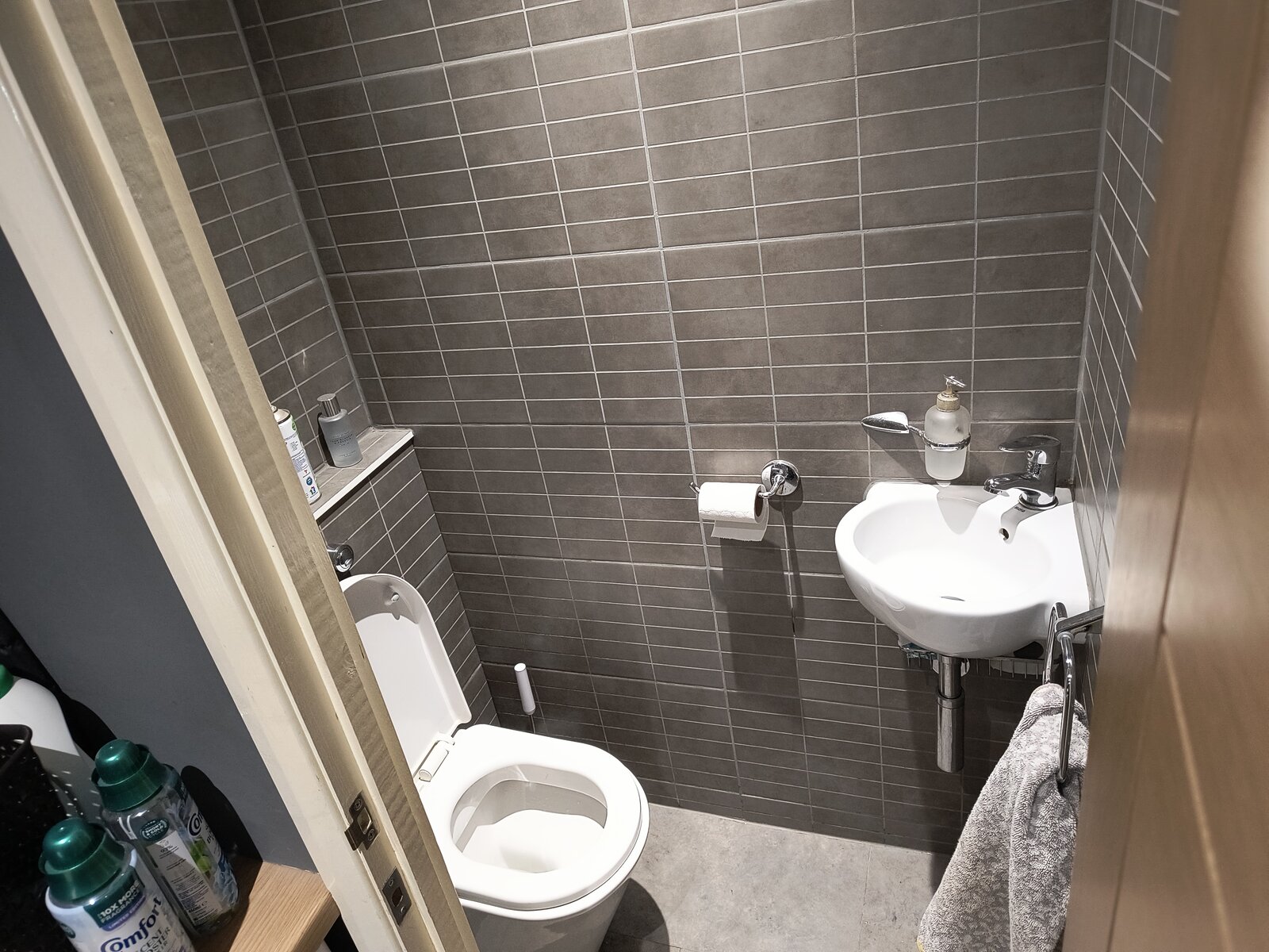

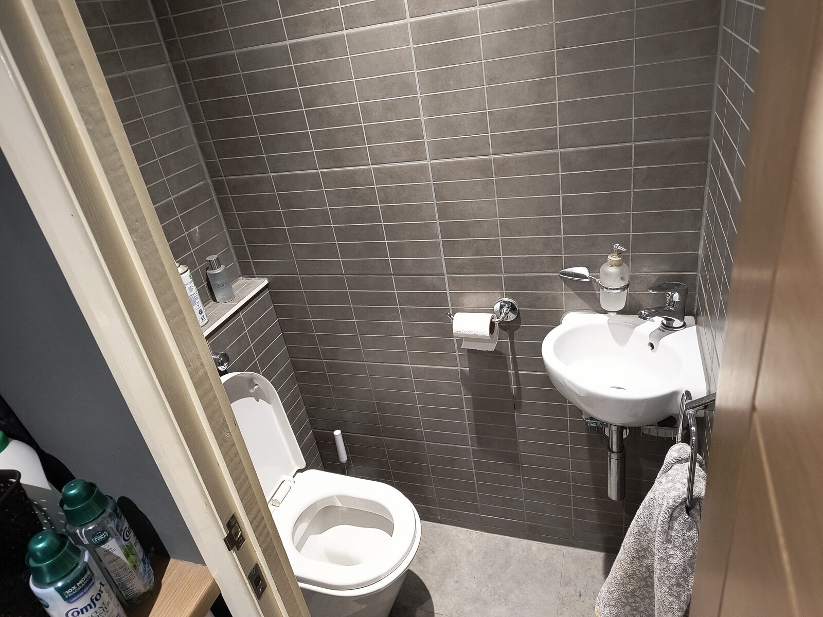

And you don't need much space for a usable WC - mine is 135cm x 87cm, including the 2 new stud walls.
I'd do cupboard/corner of master. Soil pipe can be run under ground floor ceiling and boxed in. The idea sounds preposterous but I've seen it and you barely notice it after a while - especially if you have reasonable height Victorian ceilings.
