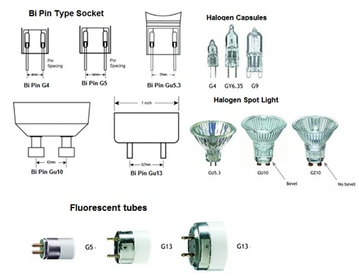

Give us a clue
When narrowed down a bit, we can further refine.
Sorry, didn't realise there was so much variation.

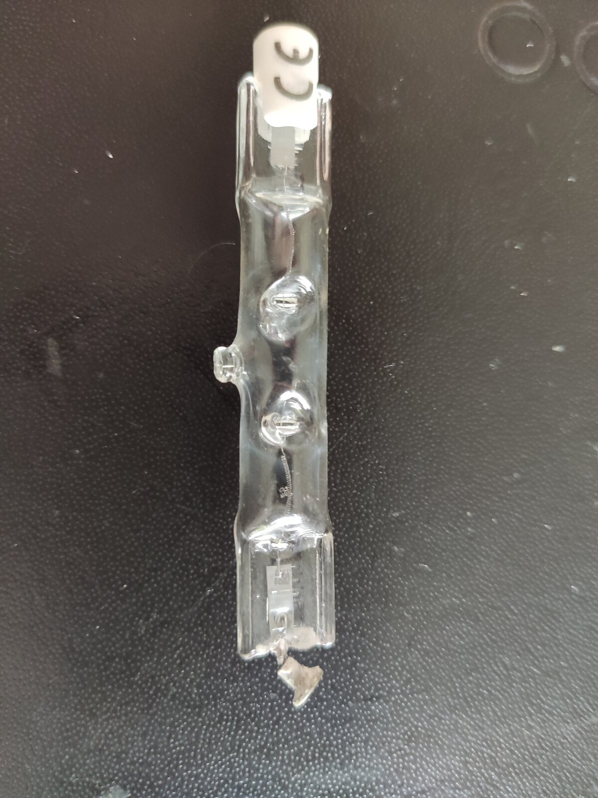

Here's a photo, the right-hand end fell off and I can't find it!
Likely RS7, you can get both quartz and LED versions, the LED however looks very different
measure length.
The R7 halogen lamp is a long shaped bulb that is normally used in floor lamps, wall fittings and garden flood lights. There are two sizes available in 78mm being the smallest, and 118mm the largest. Wattages range from 100w to 500w and the average lifetime of an R7 is around 3000 hours.

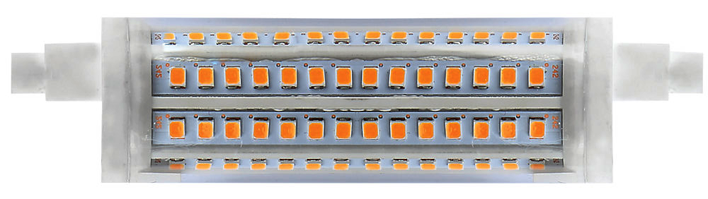

My wife bought a outside lamp requiring a R7s tube for Aldi, and it lasted around a day, but moved into this house around 3 years ago and there are two lamps using R7s tubes, and they still work, although not used much. But the Aldi one the bulb was replaced for an LED version 1657788320862.pngand it only just fitted, the reflector no longer works as a reflector, but hold the replacement unit facing outwards, but the cost of lamp plus LED tube worked out more than whole LED lamp, so fitted something like this 1657788653919.pngat my mother house as cheaper, also the Aldi unit got water in it, had to drill drain holes, the Screwfix unit worked until house sold, I will admit I prefer a lamp where the bulb can be changed, but so often when it comes to change them you can't anyway as no longer sold.

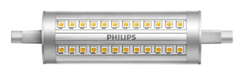

LED "Par" lamps (and their ES fittings) are a good choice.
I bought the ones referenced in post #4, they work just fine.
