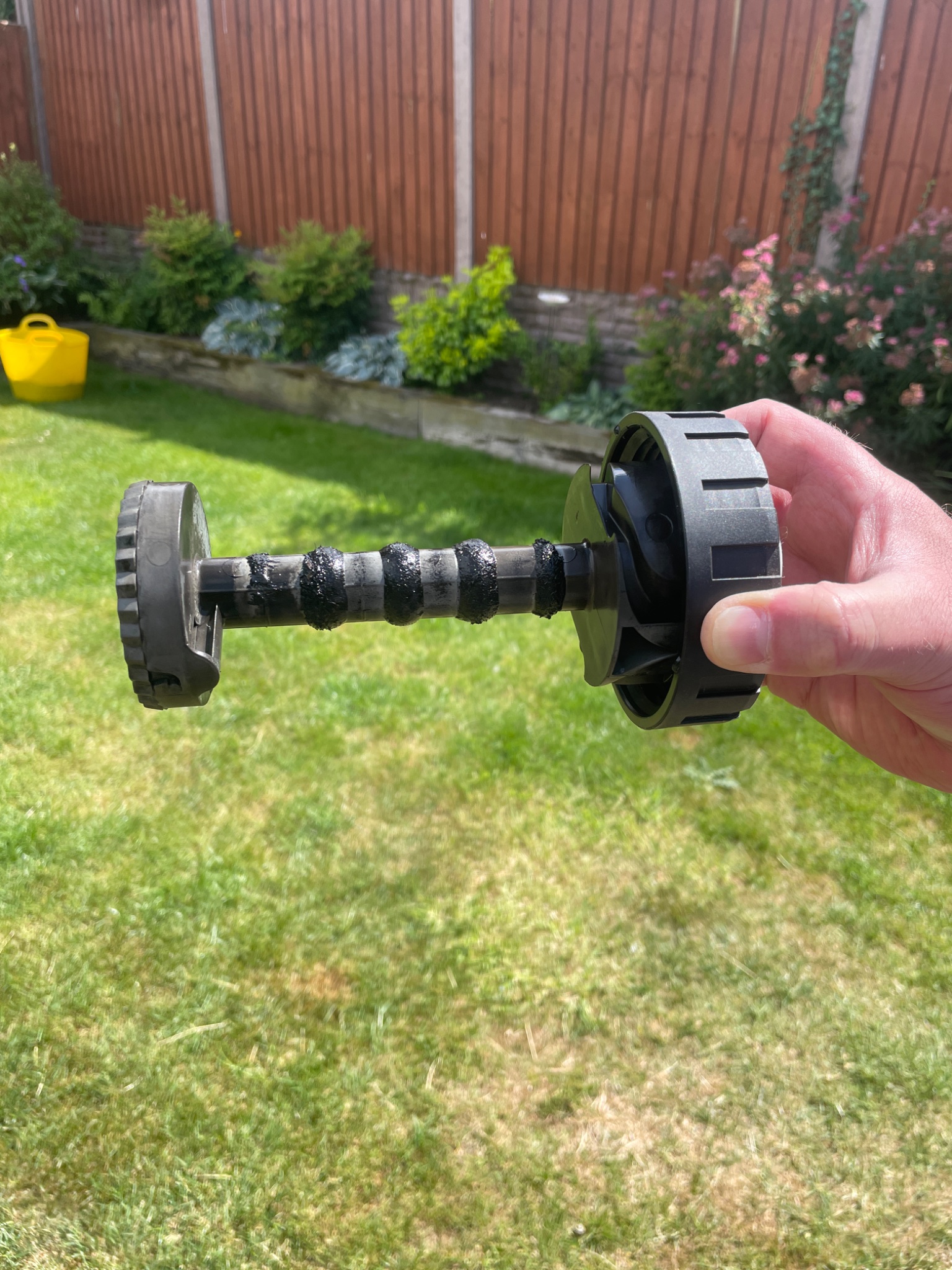

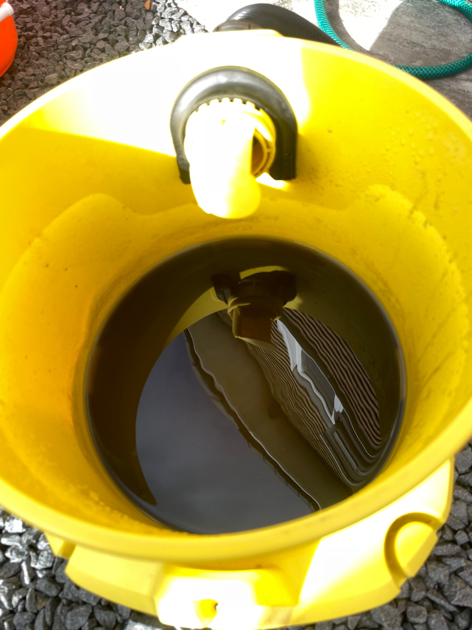

So yesterday I drained the system to put the latest radiator on and the water was running pretty clean however when I used my wet dry Vac you will see from the attached photos. The water was pretty muddy.

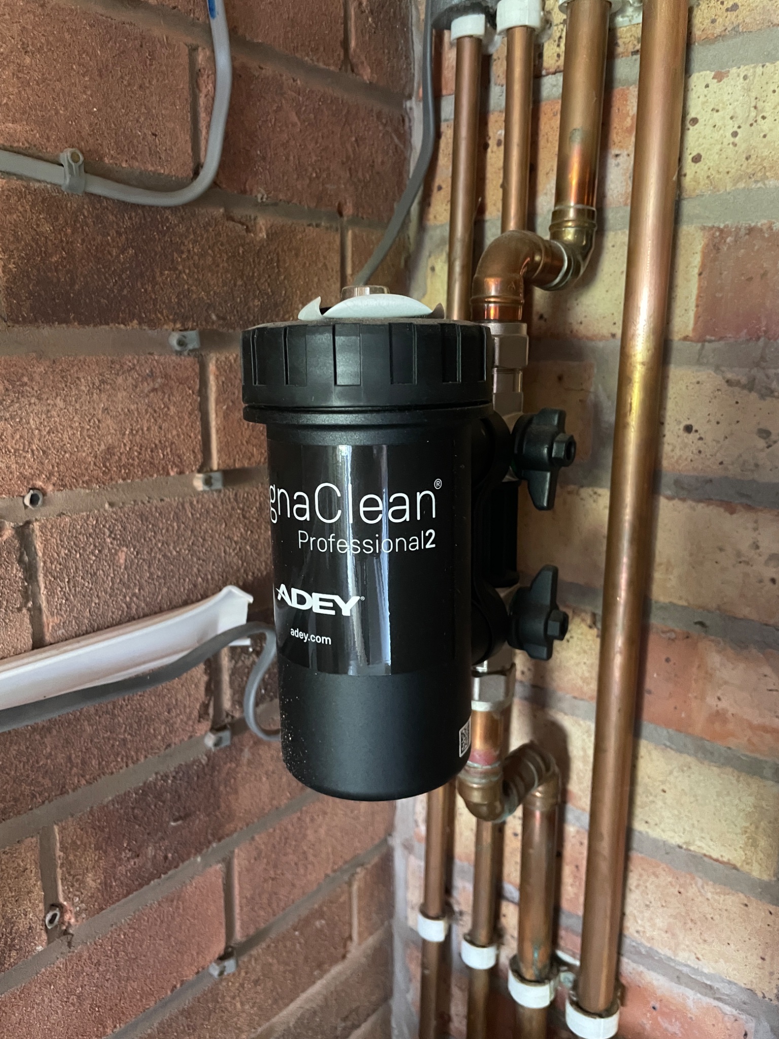

My Adey Magna clean pro 2 had minimal magnetite residue on it
So it’s worth mentioning at this point that the system hasn’t been blessed with having regular inhibitor in the system for quite some time so I am now contemplating running a cleaner through before adding some inhibitor

Trouble with just draining is that you get a lot of sediment settle and semi-harden at the bottom of the rads that will not come out with just using a flush additive. That sediment will only come out with a proper power flush that involves power flushing (obviously) whist using a special vibrating tool on each rad to loosen the sediment.
I sometimes wish I had the equipment to be able to cut open old rads and see what's going on. The system I had that problem with had been leaking underfloor for such a long time and the client had just constantly added water to re-pressurise, this had been going on for a long time and the system got so bad that the pump started to go, the boiler started kettling badly and the system was as black as tar, no filter etc. I cleaned and flushed that system about 6 times over 2 years and eventually had to say enough as it always went back to black and ended up renewing the whole system.
I have only had that issue twice in all my days of doing this. Usually a good run with cleaner and then a good flush and the system can be made to behave and will condition properly. I have had such filthy systems that the rads were flushed individually, then filled, cleaned and flushed, then inhibited a number of times before it would then started to behave itself. The only thing I could put it down to was that the rads were so bad internally, no amount of inhibitor was going to stop it corroding.
