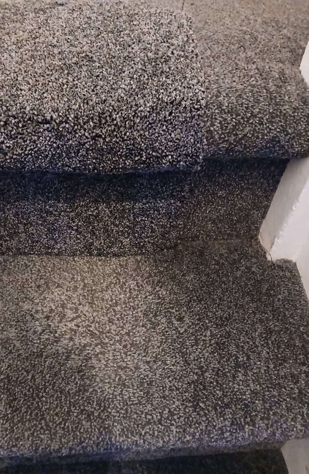

Your results may vary, but with an offcut running the wrong way - my carpet is quite 'crinkly' around the nosing...

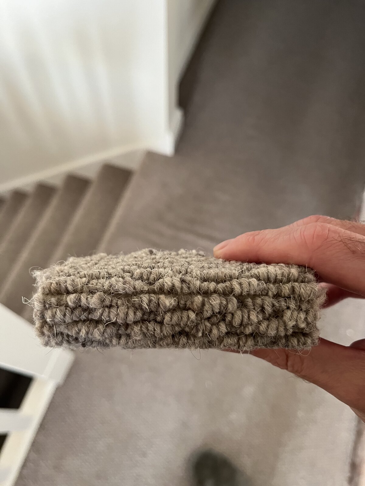

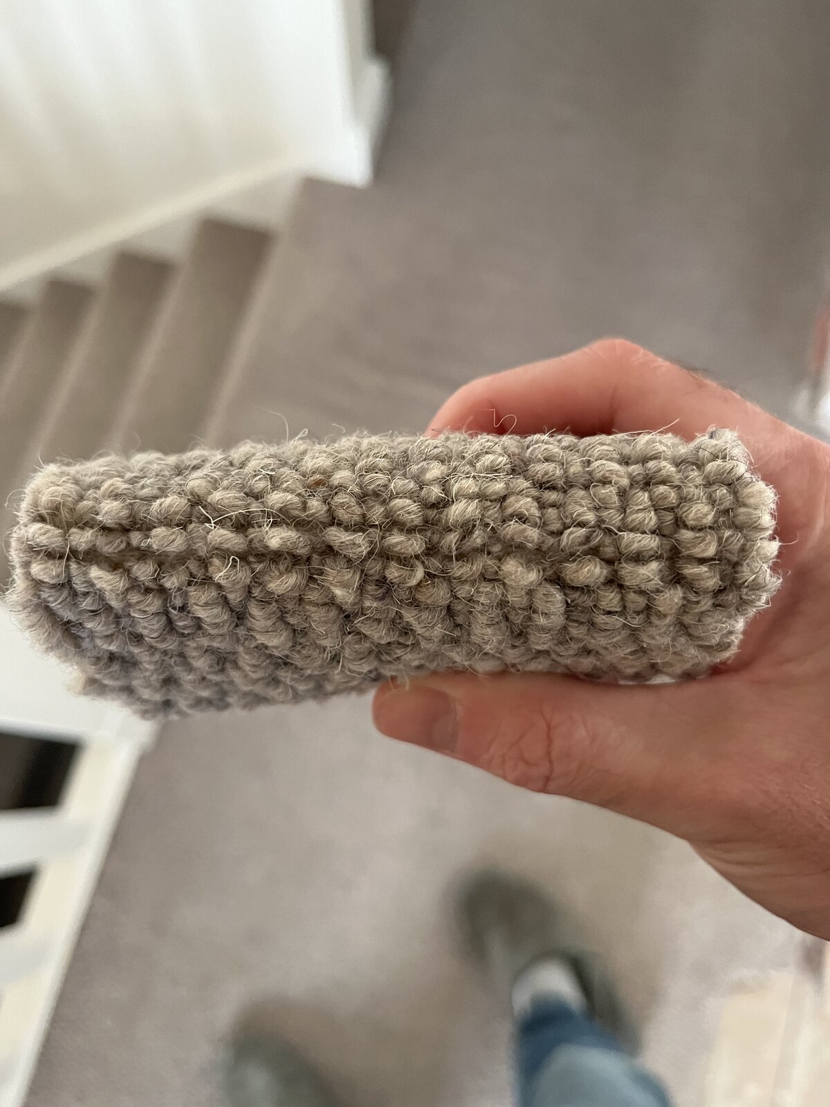

This is all super helpful. This is definitely more of an issue due to the carpet being wool I've got a sample and have folded it each way to try and simulate how it would look/open up over the nose of the steps.
You can see the lines start to open up in the second image.
What do you think?

If you plan to run it over the step and down the face of the first riser, it will only ever sit at 45 degrees, not 180 degrees like you are holding it! Of course if it runs fully over the first riser ‘waterfall’ running the wrong way, the design will be different to the direction on the rest of the stairs.
If you hold a Wilton or Axminster like that, you’ll clearly see the backing.
You have two choices, the seam option is technically the better solution ‘by the book’ but both options are available to you.
