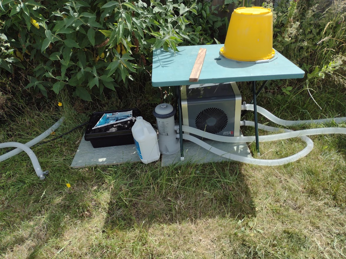

I've ordered my heat pump and filter!
After lots of searching for retailers, I found one that's just down the road. Phoned them just now and very helpful, and suggested bigger heat pump, smaller filter pump, so getting these:
Pico Reversible UK Plug and Play Pool Heat Pump for Above Ground Pools up to 12m3 - 4kw × 1 £550.00
Intex Cartridge Pool Pump / Filter for 15' Pools (2.8m3/hr) × 1 £85.00
He said the Hot Splash 3.35kw would be too small for our pool - the extra 1000 litres will make a noticeable difference.
Should be with me by April, so might be able to get the pool up and running by the May bank holidays with any luck. Hoping for a another nice summer!

Heater and filter fired up, all appears to be working. Pool getting warmer by the hour.
I was meant to build a nice little house for this, but the camping table and scraps of chipboard will have to do for another year
