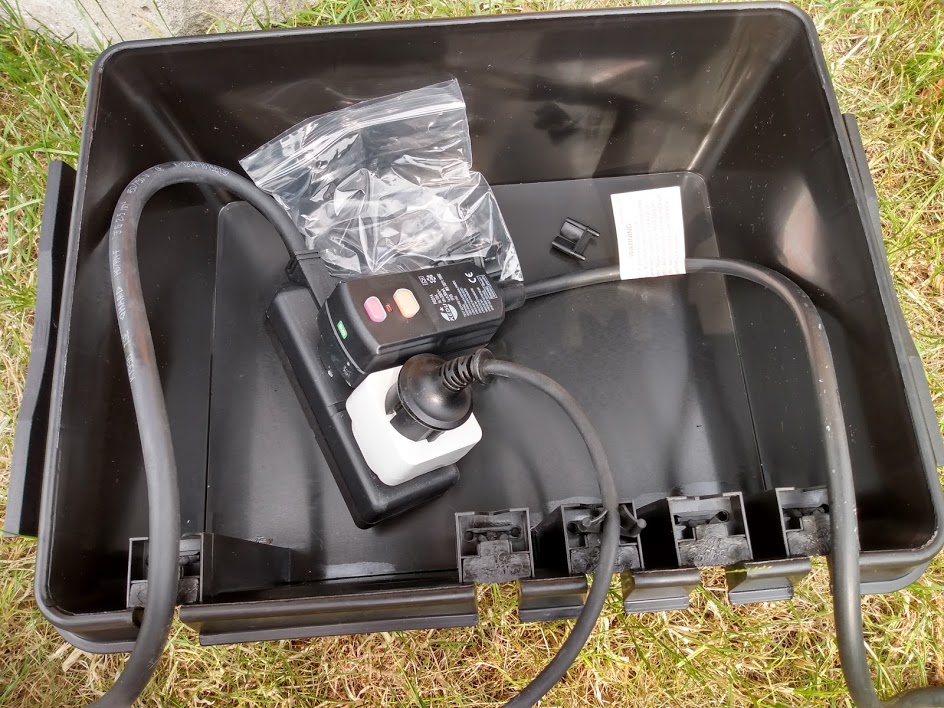

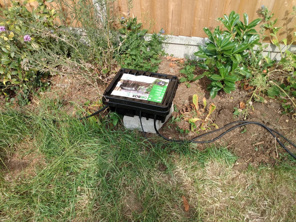

Well, a slight improvement, 2.5mm 20m cable and box has arrived.

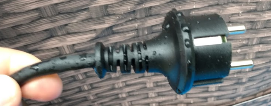

jonbey,
I might be wrong on this - but that plug DOES have an earth on it. It is the metal tags on the side of the socket.
My concern is that your use of an adapter means you have no earth continuity - and no RCD protection!
Adapters are frequently of poor design and with little metal (ie not 13A) and so may get hot/melt/burn.
Suggest that you cut that off plug and put on a UK plug as you earlier suggested.

jonbey,
I might be wrong on this - but that plug does have an earth on it. It is the metal tags on the side of the socket.
My concern is that your use of an adapter means you have no earth continuity - and no RCD protection.
SFK
Thanks, might still do that. Just had an electrician in to take a look. If the quote is not too crazy, I will let him change the plug. Otherwise, I'll be having a go myself.
I think it has already been mentioned but if not..... When you cut the plug off the cable cut the cable about an inch from the plug. This will enable you to check which of the three cores are which ( Live, Neutral and Earth ) The cable may not have Brown, Blue and Green/Yellow cores.
As I mentioned back in post 16.
