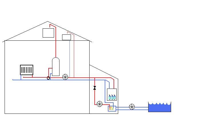

Thought I would post this and see how many holes get shot in it.
We have a more or less standard open vented heating system kept warm by a Potty Flamingo in a brick lean-to, with the pump, 3 port valve etc. near the centre of the house.
I am considering adding a heat exchanger to heat a small pool. The easiest way I can see to do it is to locate the heat exchanger adjacent to the boiler, and pump the pool water to it using the existing pool filter pump.
For the boiler side, I was considering tapping into the boiler flow and return, and adding another pump to run the pool heater, electrically interlocked with the existing system so it can only run under control of a pool thermostat when there's no domestic hot water or heating demand.
Would this work?
Would I need a 2 port valve on my heat exchanger circuit?
I did exactly what you are sugesting to feed an Underfloor circuit in addition to an existing Yplan, you will need to fit a 2 port valve in the circuit to prevent any gravitation, as poolside plastic pipework does not like getting hot!, you will have to interlock the boiler to the existing system probably using a relay so that you do not put a back feed back to the existing control, If I remember, i connected the existing Sw L to feed Relay 1, and connected the pool heat demand to switch relay 2, the Two relays were wired with a N.O. contact in parralell so that whichever relay pulled in first fired the boiler, and the last to drop out stopped the boiler.
