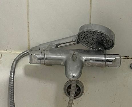

After I received the report on Wednesday, I asked the surveyor to let me know how much more work would be involved to have only the bath/shower boosted. I'm still waiting. I also asked what his availability was to do the work he had quoted for. "Will be more than 2 weeks" is all I've been told so far. I realised although Salamander recommended him as the approved fitter *for that area*, he's actually based over 1½hrs away, on the M25 towards London ! I was told the survey fee would be refunded if he then went on to do the work, but I get the distinct feeling now he's never had any intention of doing it. I'm stymied.
Have you considered going the pressurised cylinder route (assuming decent cold mains pressure/flow) no pump or storage cistern required.

There's only low pressure to the bath/shower, rest of the house is fine. I'm wondering why that is.

As above... Put in an unvented cylinder if you have the mains flow and pressure.
