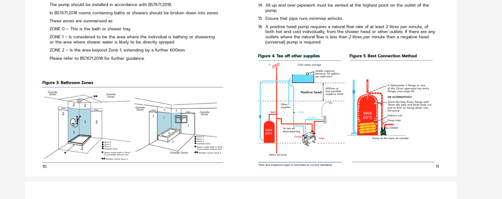

I think you're confusing yourself. Either of these options the plumber intends to fit by the hot water cylinder, therefore presumably boosting the hot water main as a whole. If you only want the pressure to the shower/bath boosted, then it pretty much needs to be an under bath pump, no?
Now, if salamander are telling you they don't do any pumps suitable for under the bath, what are you actually asking?

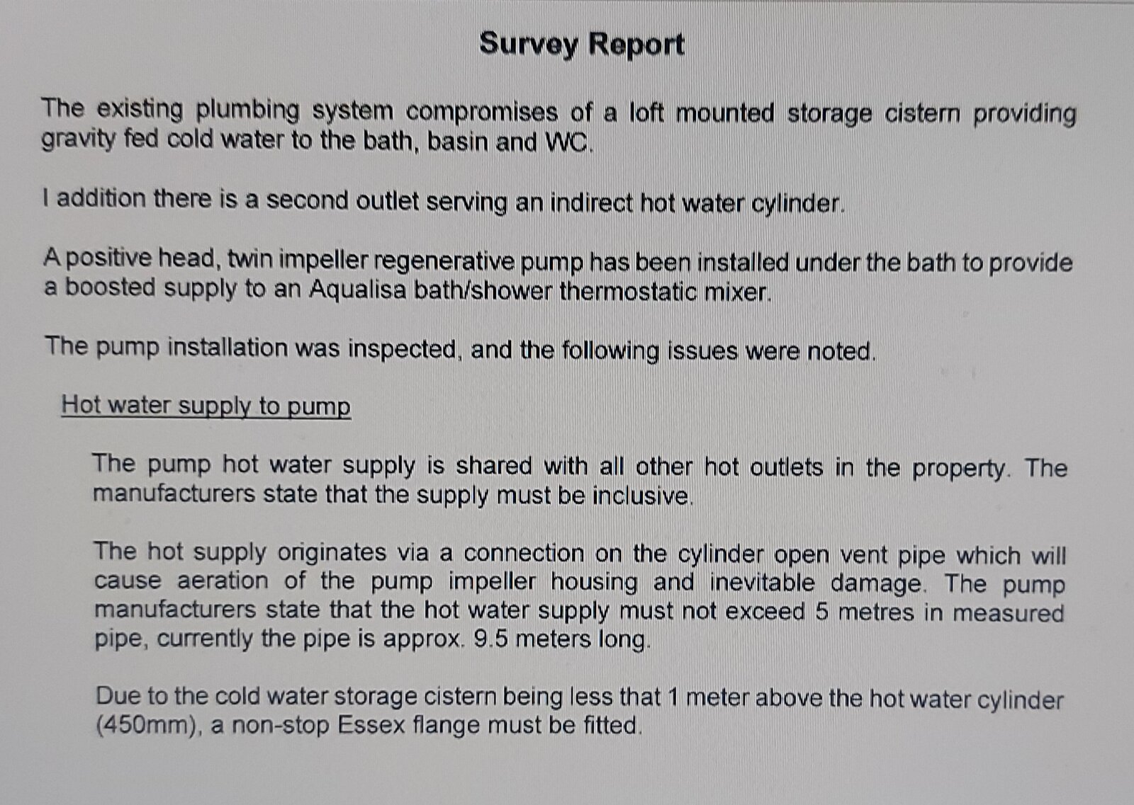

They do say on their website that if you get a litre of water from your taps in under 30 seconds (without pump) it should be suitable for a positive pressure pump, in which case I would say they should be standing by their warranty. Is your hot water cylinder on the same floor as your bathroom?
Couple of questions first.
1) Is the pump, when under the bath, within 5m (22mm pipe length) of the HW cylinder? - if so then according to Salamander it can quite happily live under the bath
2) who suggested it must be fed via an S Flange? - Whilst it is best practice, Salamander themselves state 2 different connection scenarios, one is from a flange the other from the HW supply after the vent.
Not sure why it seems that the Salamander accredited installer isn't giving you the correct information or at least giving the full picture

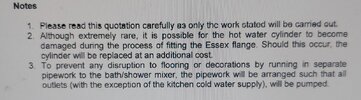

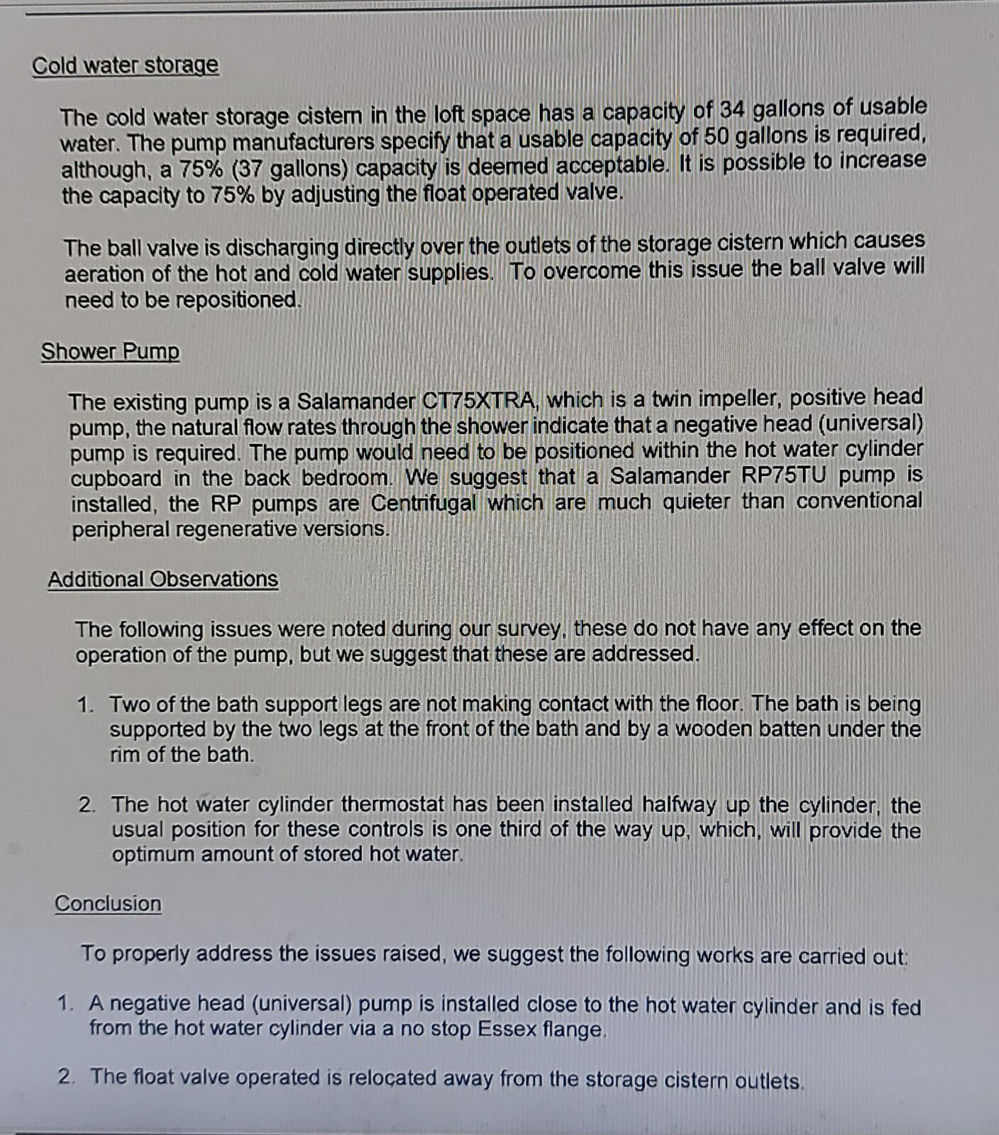

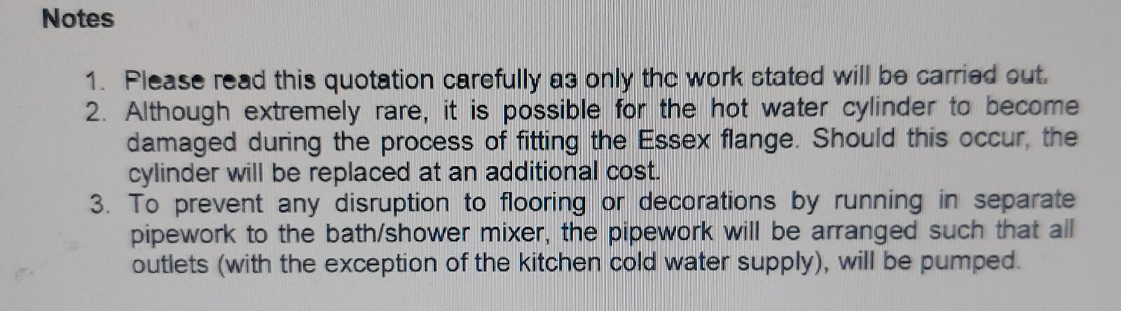

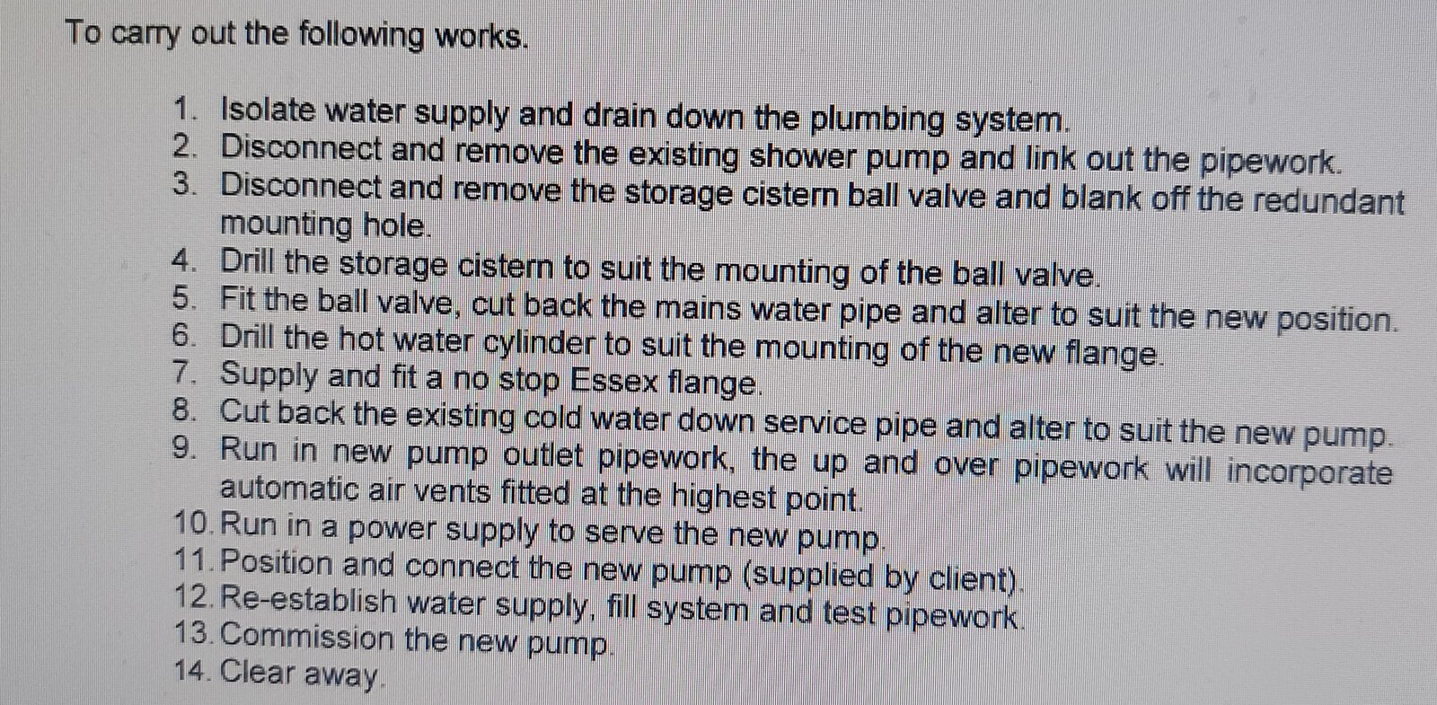

For what it's worth, I've received this today. Does it help ?
Seems very thorough honestly. I'd say you have 3 options.
1. Accept the quote and live with your taps being pumped, what are your reservations with this?
2. Ask the plumber to find a solution for just the bath and the shower, this will involve a new pipe being run from cylinder to bathroom though and likely damage to wall/floor coverings
3. Engage another plumber for a solution, other pump manufacturers may not have such stringent install requirements - good chance it wouldn't be guaranteed though
1. Noise, particularly in a bedroom, especially overnight. And the tenant's just suggested that could affect when I com to sell.
2. I've asked, waiting on a reply but I'm guessing it'll be WAY more expensive than it already will be, plus being - presumably - a bigger job, would delay scheduling it.
3. It HAS to be guaranteed, this is why I've gone this route. Having said that I've been in touch with 6 other Which trusted traders. 1 has replied & will want to visit to quote, another delay though have sent them those photos. Understandable they'd want to see for themselves I s'pose.

I noticed the 1st prerequisite is a 210 litre hot water tank, & it's capacity is about the only thing the surveyor didn't put in his report ! If the cold water tank's too small, & the thermostat on the hot water cylinder's about a foot to high, what's the chances that would be insufficient too !! probably a non starter :confused:
