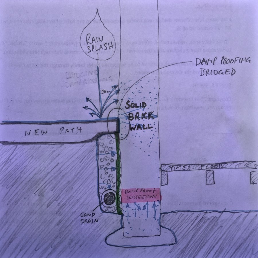

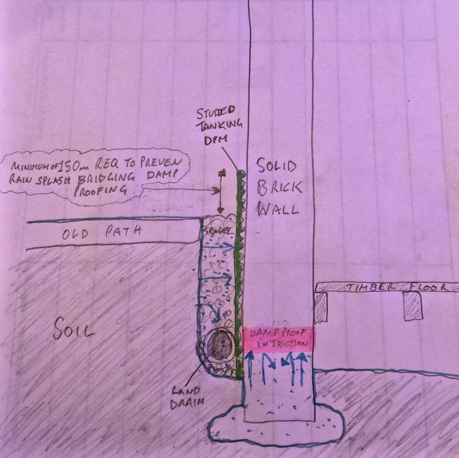

    I feel like I'm going mad here with everyone telling me I'm wrong so if I post a couple of diagrams of exactly what work I carried out to remedy the damp & then one of the work which has just been carried out I'd be really grateful of any comments even if I am in the wrong, I just want some clarification if possible (any questions just ask).
    This first crude diagram is of how I remedied the Damp, you can see Damp Proof Injection course to stop rising damp & the studded membrane which were my main barriers. I also sprayed the brick wall with a breathable water repellant & lined the 200mm trench landscaping fabric before laying a land drain & filling with gravel.
    The second diagram is of how things are now, the top of my studded wall DPM has been cut right down & concrete has been poured up & onto my wall. I'm assuming at least some concrete has gone down the the studded DPM which is against my wall & obviously the studs are to keep the membrane from lying flat against the wall to prevent any capillary action. I also presume they will have removed at least the top of the gravel in the trench to lay hardcore for the concrete path? The concrete path in my opinion now Bridges my Damp proofing & any water landing on the path next to my wall will now hit my unprotected solid brick. The builder is totally convinced all of this is meaningless due to the fact he has put a fall on the path (which I have not been able to check). The fact is in winter months this small side alley receives no sunlight & is constantly damp with moss & algae everywhere which I don't think a slight fall would remedy.

    Maybe get a written opinion from a surveyor, which you can show the neighbour to show her the builder is wrong. Then that strip will need excavating and putting right. It isn't going to be a huge job. If you want to maintain good relations, you might need to pay for this. It sounds like the builder has been thoughtless, and then bullsh*tted the neighbour, who is just accepting what she has been told.

    Even if there is a fall away from your wall, splash back from rain will wet the wall, that is why DPCs should be 6" above ground level. This can be cured with a liberal dose of silicone once the wall has dried out, next summer?

    Would the fact theres concrete right up to my wall not be a problem? I know water runs off the surface but I've always presumed if its wet for long enough (& the path in question is damp all winter) it may absorb some water which would pass through to my wall or is this incorrect? I've not been able to measure what kind of fall is on this new path but purely going by eye it looks minimal.
    Originally I easiest cheap remedy for this problem I could think of would be to cut away the path from the house again, I'm not particularly bothered how much but just enough to fix a new strip of DPM along the bottom of my wall that would overlap the top of whats left of the original DPM by a sufficient amount. Am I way off the mark? Any thoughts appreciated.

    Just a quick update for anyone who's interested, I got the surveyor out who completely agreed the path was breeching my damp proofing & will ingress of water to my property. In fact the house already smells damp so he took readings on the wall which showed to be damp, to be honest you can feel it's damp with just your fingers.
    The Surveyor tried to talk to my neighbour first before writing up reports etc in the hope of explaining what was wrong with the work & why the path needs to be off my wall, which would be a reasonably easy fix. Unfortunately he rang me to say things didn't go well at all when he rang her as the builder was there & apparently told him something along the lines of surveyors don't know what they're talking about & he knows better. They also said they’d had an "expert" out who was apparently some sort of Architect lecturer & told them what I had done to remedy my damp was not a recognised building method. Anyway from what I can gather it all got a bit silly to the point the Surveyor decided it was best to just put the phone down & write up his report to post out.
