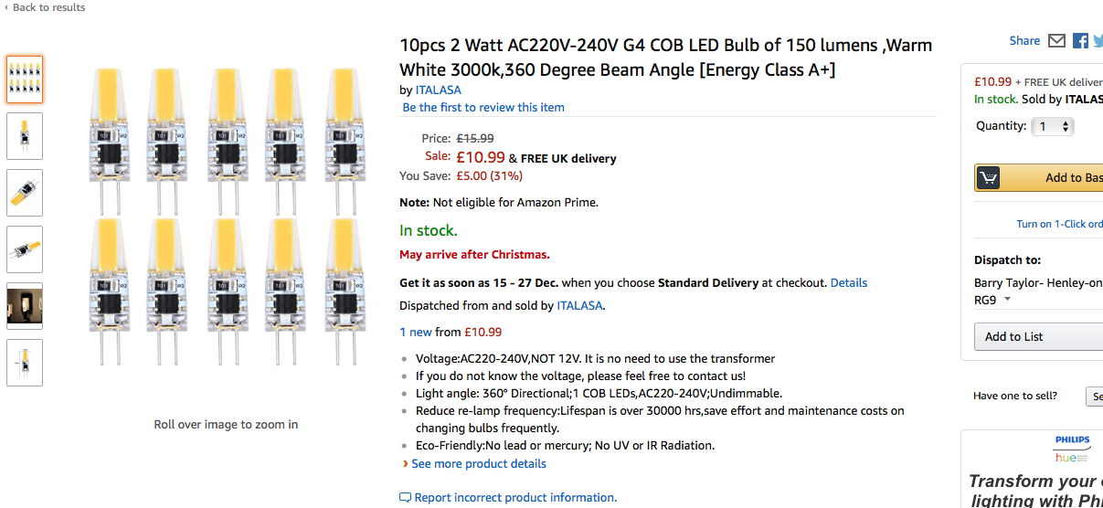

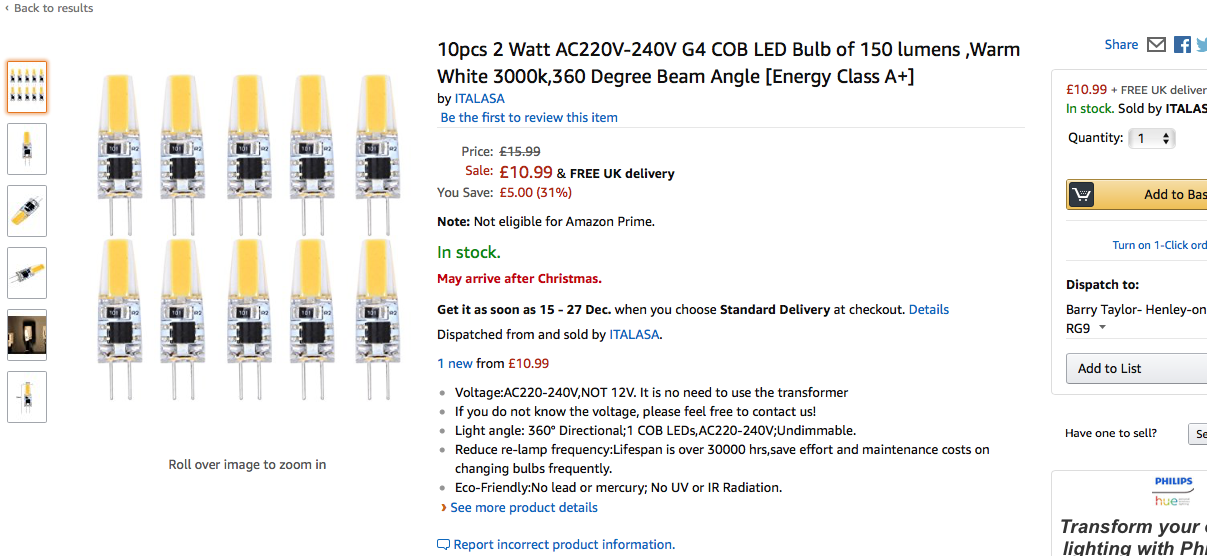

I looked for some G4 230V LED's to replace some G4 230V halogens and purchased from that exact advert.
Guess what?
they are 12V
and
so are the second delivery after complaining.
If you are getting replacements at no extra cost (i.e. not having to pay return postage), I'd be tempted to keep on and on doing it until they sit up and take notice.
Interestingly someone has given them a 5* review, so either he wanted 12V and didn't read the advert properly, or he got 230V ones.
