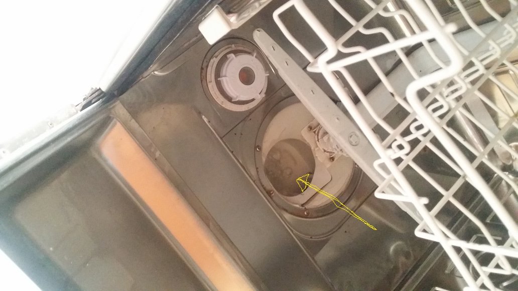

Our Whirlpool A-Class-ADP 4305 dishwasher does not filling up with water. I can hear it is trying to fill but it then stop and give 1 flash every time. The dishwasher have no display panel.
I turned it 45 degrees backwards. some water ran out but it is still doing the same. I check both the inlet and outlet hoses and could not see any damage.
I tried to find the service manual for my model but had no luck.
All the help will be appreciated!
many thanks!
Water is leaking somewhere, dishwashers have a polystyrene float attached to a switch in the bottom of the cabinet, if any water leaks out it will activate the switch and prevent it filling.
You will have to remove the bottom panel to locate and repair the leak. May be obvious such as a split or loose hose.

Hi Flameport
I checked the hoses for any leakage. I could not find any.
I tested the machine with the door open and with the filter in the middle. I could see that there is water coming through as the machine try every time to start in the hole where the filter goes. I also could see little bit of water going out via outlet.
Please see attached photo.
Many thanks
