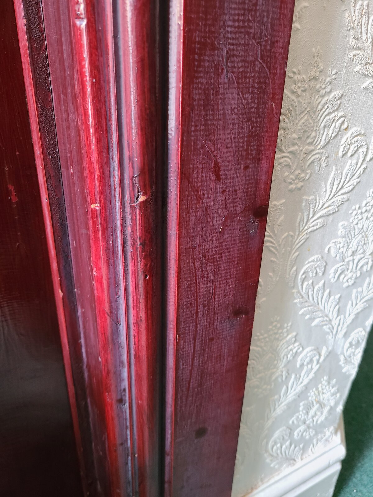

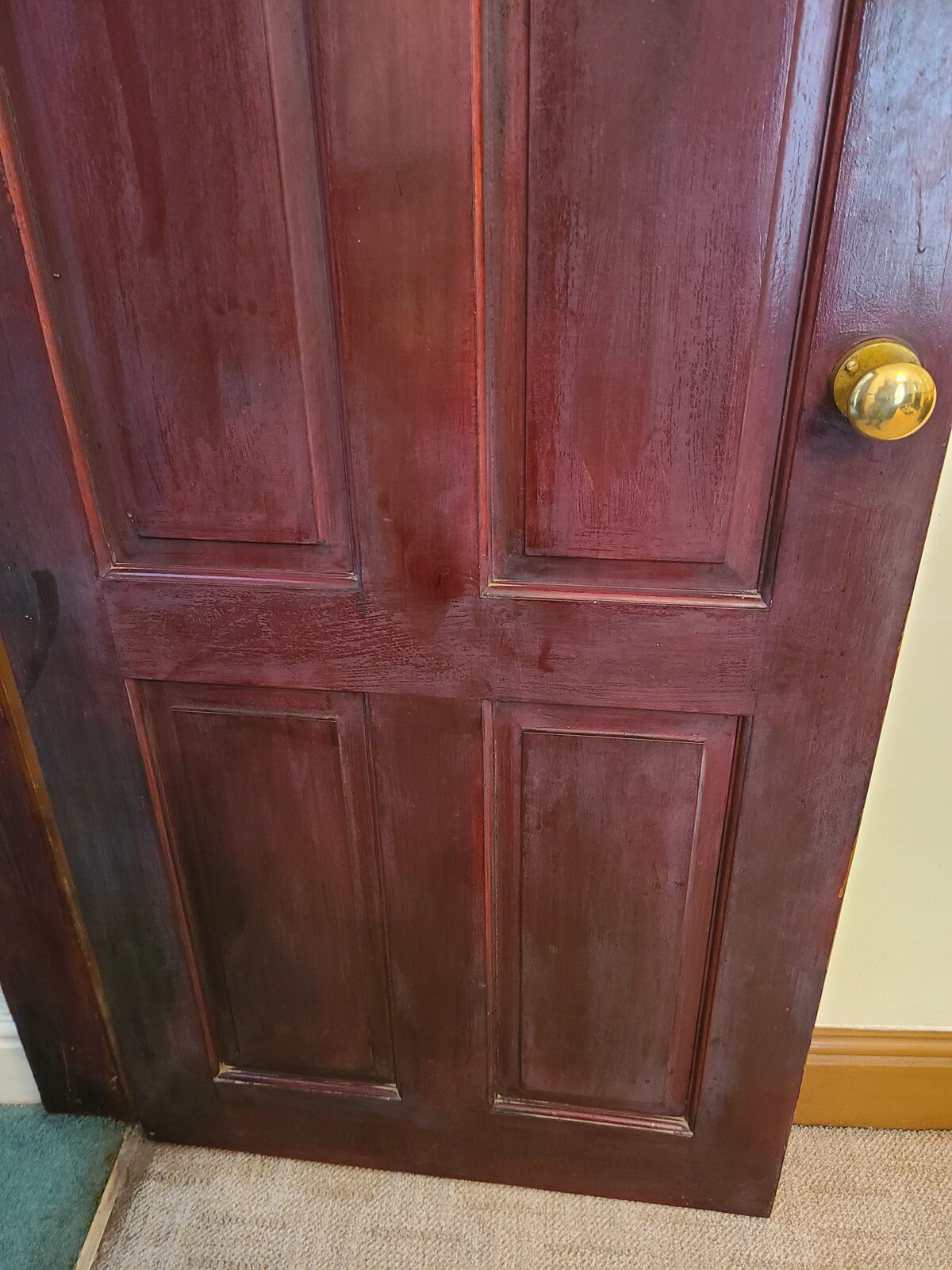

My Mums house has a thin layer of white mold that attaches itself to doors, door frames, leather couches.
Please see attached photos.
It wipes off easy but comes back within a week or so.
It's a Victorian terraced house and double glazed. Not a massive amount of ventilation as she is not a fan of open windows. She has a condensing tumble dryer and doesn't hang clothes in the house to dry.
I suspect it's a ventilation problem.
Anyone got any thoughts on what else it could be?

How do you wipe it down; with a damp cloth?

Ventilation is the answer, if nothing done she will have problems
This.
Condensing tumble driers do not capture all the water vapour. There is a possibility of leaks adding to the damp, often in the kitchen, especially hundred-year old pipes buried under the floor, or drains against the wall; and roofs, gutters and downpipes, especially on bay windows. If the doors are closed overnight, which rooms have the mistiest windows by morning?
Using extractors in kitchen and bathroom will help. They are often wired to come on automatically with the light switch, to defeat people who have an aversion to ventilation. Opening upstairs windows every morning costs nothing.
