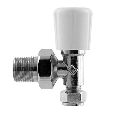

Not a plumber, but when i balanced my system i had to almost close the lockshield on the towel rail closest to the boiler and this made that water flowing noise.
Opening it a little tiny more cured the problem.
Something to try.

What is a lockshield?
The radiator valve opposite the thermostatic valve.
