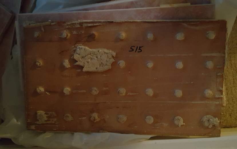

I’ve had to partially dismantle a shower, put new studs and marine ply in, then re-tile. I want to re-use the original tiles, so have painstakingly removed them (nightmare, but only broke two – time for the Araldite).
I haven't done any tiling for centuries, and never where water would be involved – only on kitchen/bathroom walls etc. And only smallish tiles. These are quite big and heavy.
Now obviously when it’s in a shower I want to do it properly – which it looks like maybe the house builder didn’t. The existing plywood backing was completely covered with grout/adhesive or whatever you call it, but a lot of the tiles weren’t, which is what made a lot of them relatively easy for me to remove. Pic below – as you can see, it’s clean except for one tiny patch, and was I think held in by the grout round the edges, to the other tiles.
To avoid me making a similarly bad job of it, what did he do wrong? The tile was pressed firmly onto the adhesive, as there are deep dimples where the tile’s “bumps” were – but it wasn’t stuck.

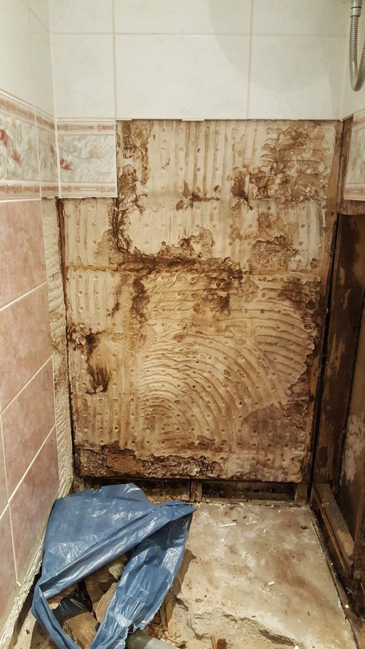

check that the exposed backing is dead flat,plumb and exactly ninety degrees at inside corners.
the adhesive you show is tub mastic when it should be bagged powdered adhesive.
take photos of the surrounding walls and post them on her please and i can then tell you more.

The left hand wall in the pic is block – the other two are stud walls, and have got dry rot in them from a cracked shower tray. The tray was discovered nearly a year ago, and the shower hasn’t been used since, so it’s all dry as a bone now.
I know that at some stage the stud walls will have to come down and be replaced, but I’m not in a position to do that for another couple of years. A damp-proofing guy I spoke to assured me that dry rot can’t spread further in the absence of a supply of water, so I just need to make do till I get my pension in a couple of years.
So my plan has been to cut out the rotten wood, replace, put new ply on it, possibly even tank it as somebody recommended, stick the tiles back on, and relax till 2020 or so…
youd be wasting your time patching up that lot esp as now i can see that the drain waste has been opened up for some reason.
youd be foolish to leave any trace of that dry rot for any length of time.
Going back to the original question, it looks like the original adhesive was put on too thin ie too small notches in the tool, so the protrusions on the tiles hit the wall before the adhesive contacted the rest of the surface.
Sorry, completely misunderstood what you were saying there - do you mean the big hole that's been dug in the mortar? Would the plastic drain pipe normally be completely enclosed in mortar? I guess at some stage in the past it must have been blocked or something.
But the weird thing is that the original tiles don't ever seem to have been disturbed since the house was built in 1994, and I'm pretty sure (from talking to my neighbour in the same kind of house) that the cracked tray is also the original - could it be that - for whatever reason - it's always been like that?
