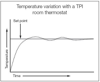

It takes time for heat to travel from the heater to thermostat, during that time the heater is still producing heat it just has not reached the thermostat, so more it produces per second the more it will over shoot, of course the difference between off and on will also affect the over shoot.

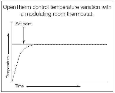

With heat pumps you don't want to restart the pump until the pressure has dropped, so with some thermostats there is also a delay built in. So with an analogue output as with modulating gas boilers you would get Temp_variation_OpenTherm.jpg this curve,
with a digital control you would get Temp_variation_on_off.jpg this curve,

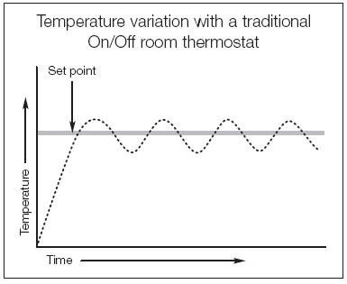

however if you use a solid state relay you can closer emulate a analogue control so more like Temp_variation_TPI.jpg curve as in real terms it starts to pulse before it reaches the target temperature and continues after so reducing the hysteresis, with mechanical contacts they would wear out too quick, only with solid state can it switch that often without failing.
With heat pumps you don't want to restart the pump until the pressure has dropped, so with some thermostats there is also a delay built in. So with an analogue output as with modulating gas boilers you would get View attachment 160478 this curve,
with a digital control you would get View attachment 160479 this curve,
however if you use a solid state relay you can closer emulate a analogue control so more like View attachment 160480 curve as in real terms it starts to pulse before it reaches the target temperature and continues after so reducing the hysteresis, with mechanical contacts they would wear out too quick, only with solid state can it switch that often without failing.
This is a function of the control not the power output of the heater. Unless the heater has a large thermal mass, it is a non-issue for room heating.

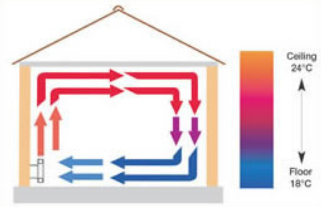

The diagram shows circulation, cycle time is important, if the heater can cool completely during the on/off cycle the flow of air is interrupted if however the cycle is fast 5 minutes or less it works as if it's analogue control however as the cycle time approaches ½ hour then circulation is lost.
So control and heat output are linked, with a semi-conductor control it really does not matter how bit the heater is, but with mechanical control one wants the heater to be just enough so most of the time it is on.
