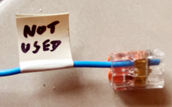

That's surely not beyond the wit of man? - e.g. a 'tab' made out of a bit of white PVC tape with something written ion it with a Sharpie?
Would a sparky likely have understood if it was labelled 'U' for 'unused?'

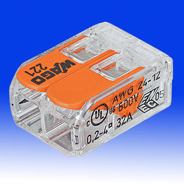

Only asking as the Wago 221 2-way connector blocks I have are tiny. I probably wouldn't be able to label and fit 'unused' on it.

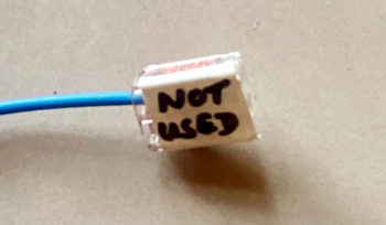

Probably not, but it wouldn't have to be a very big (e.g. white PVC tape) 'tab' for you to write "Unused" on it.
It's quite possible to label a 2-way Wago directly in that way (again, with white PVC tape), per this rough mock-up ...
... but I was actually talking of something more like this ....
... although, as I have implied,I would very rarely contemplate doing anything like that (I might if the conductor in question was 'live'.
