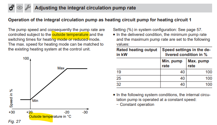

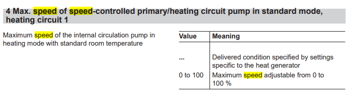

@mrbg07546 It's stated as an "Integral, variable speed high efficiency circulation pump". Documentation is a bit vague as it initially only mentions it's variable based on "Outside temp" so you could read that as only when using Weather comp. But there is a section to describe how you change max in 'standard mode'. There's no auto - just a 1 to100 option for the max speed.

that would be great if the case. I'll just have to give it a whirl and see. Would be nice if the boiler had explicit control for this or even a 'soft start' option which would heat slower but quieter.
