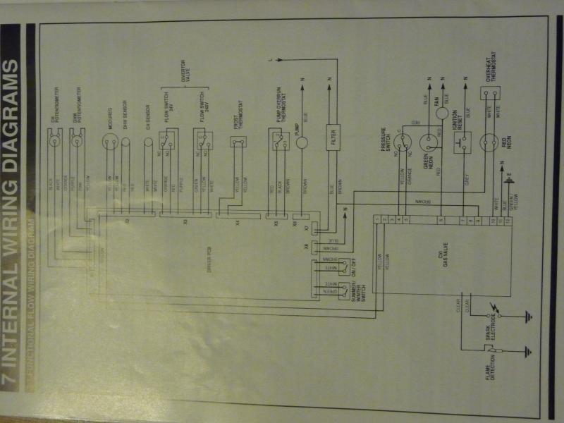

The two wire programmable thermostat has packed in on my Wickes Combi 2000 combi.

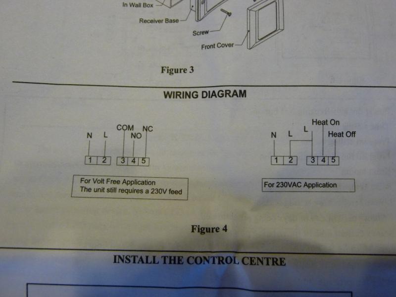

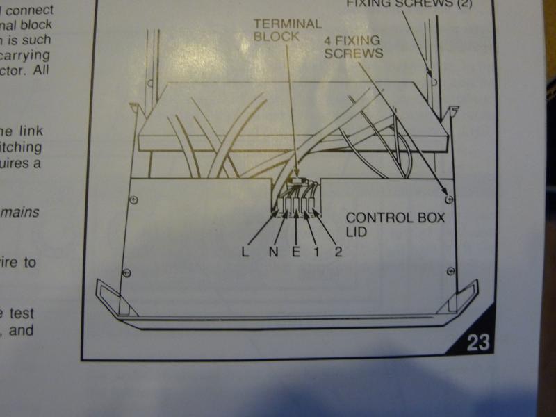

I've purchased a Celect COR908WHB-3-RF/B Wireless thermostat off ebay but I'm unsure which way to wire it up. I've uploaded the diagrams for the combi and the thermostat so any advice would be greatly appreciated.

P.S. connect terminals 3 and 4 on the stat to the 2 terminals on the boiler that were connected to your old stat.
Cheers mate last two were Drayton's :cry:
Is that terminals 3 and 4 for volt free operation or terminal 3 (live) and terminal 4 (heat on) where terminals 2 and 3 are linked?

So does the boiler SWL require 240 volts or is it low voltage off the PCB switching ? need to see more of the boilers wiring details ?
they look, to me, to be the boiler internal wiring.
We need to know whether the room stat has to be mains or "volts free."
Still not seeing the boilers wiring installation instructions, are there any warnings regarding connecting the room stat, ie, DONT CONNECT TO 240 VOLTS written anywhere, any instructions showing where the room stat wires connects to ?
you don't appear to understand.
the 'stat is suitable for both, the boiler instruction will explain whether it should be wired for 240v or not, although the wording may not make it obvious to all.
