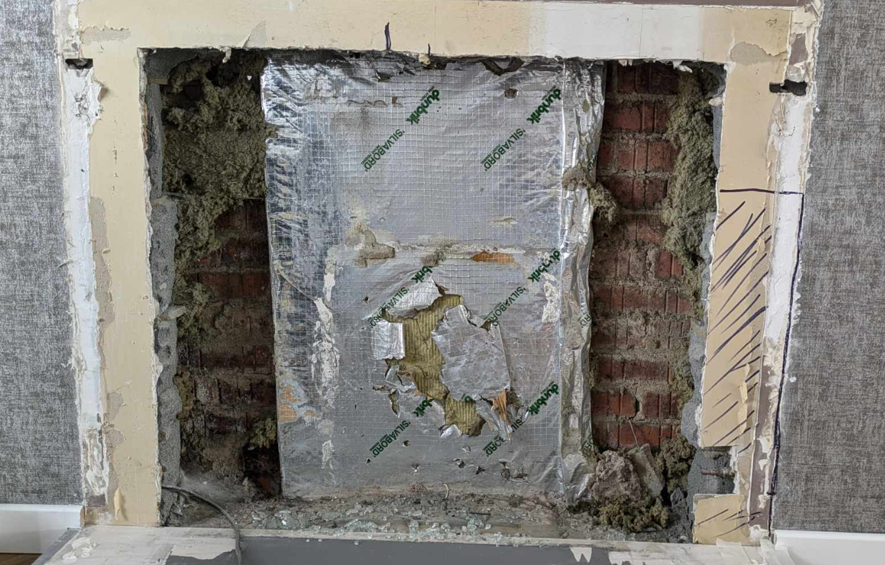

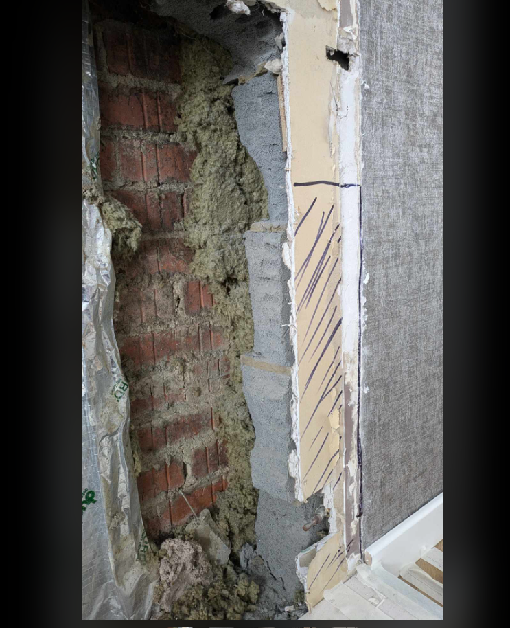

Hi all,
I'm replacing our electric fire with a wider one.
It is on an external wall and i need to open out the inner leaf blockwork so that i can recess it into the wall.
The current opening is approx 900mm wide and i need to widen it to 1500mm.
When i removed the existing fire i noticed that there isn't a lintel installed but because i need to go wider i presume that i will need to put a lintel in?
The flue (which won't be getting used) runs up the middle of recess.
See photos below:
Yeah put an 1800 concrete lintel in. Looks like those blocks will make cutting it in nice and easy
Cheers, yeah the blocks cut really easy.
I was thinking an angle steel lintel but you think concrete would be better?
Yeah either, whatever you can get hold of cheaper/easier. Personally always use the brick size concrete jobbies for that kinda thing
