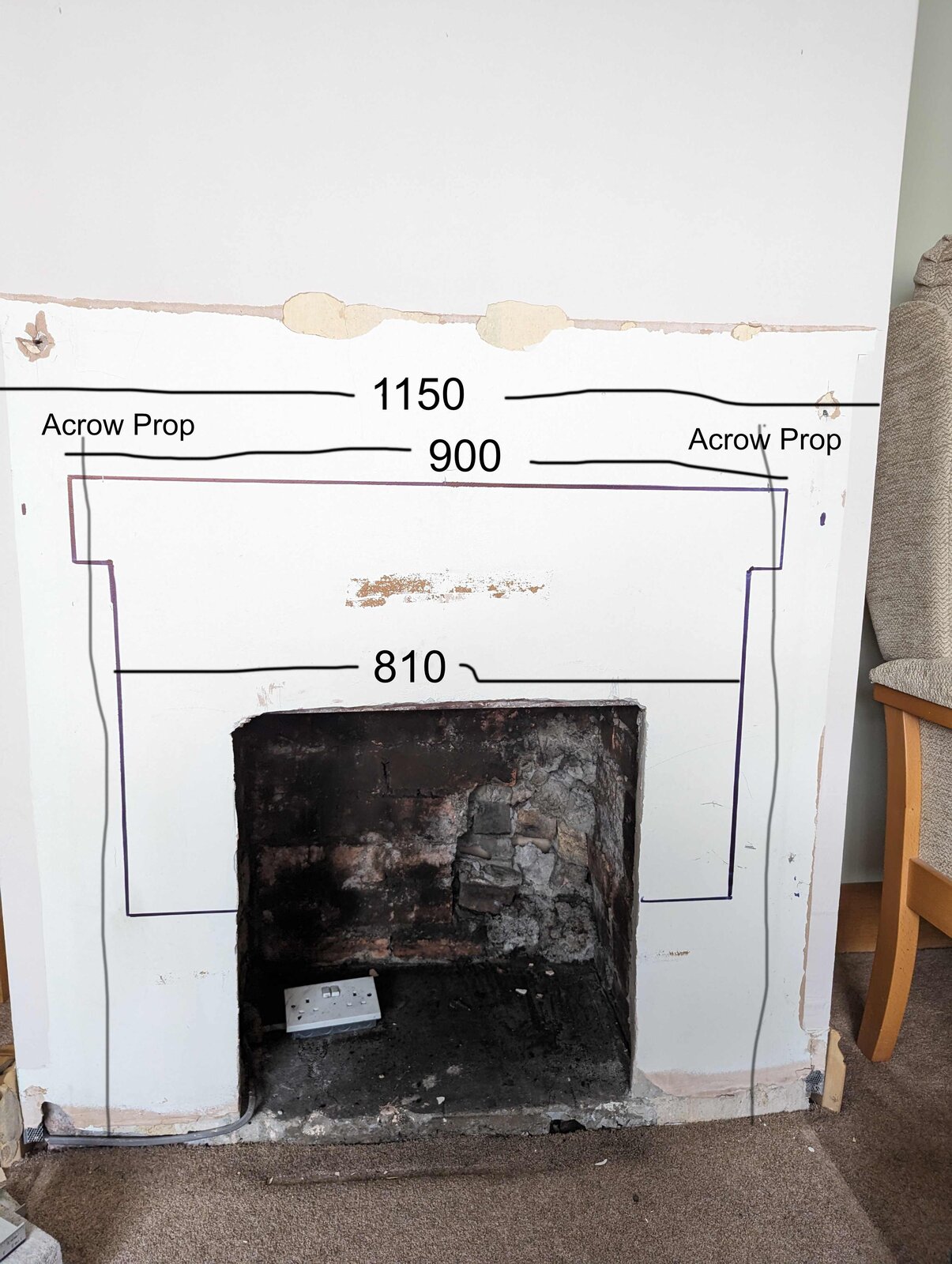

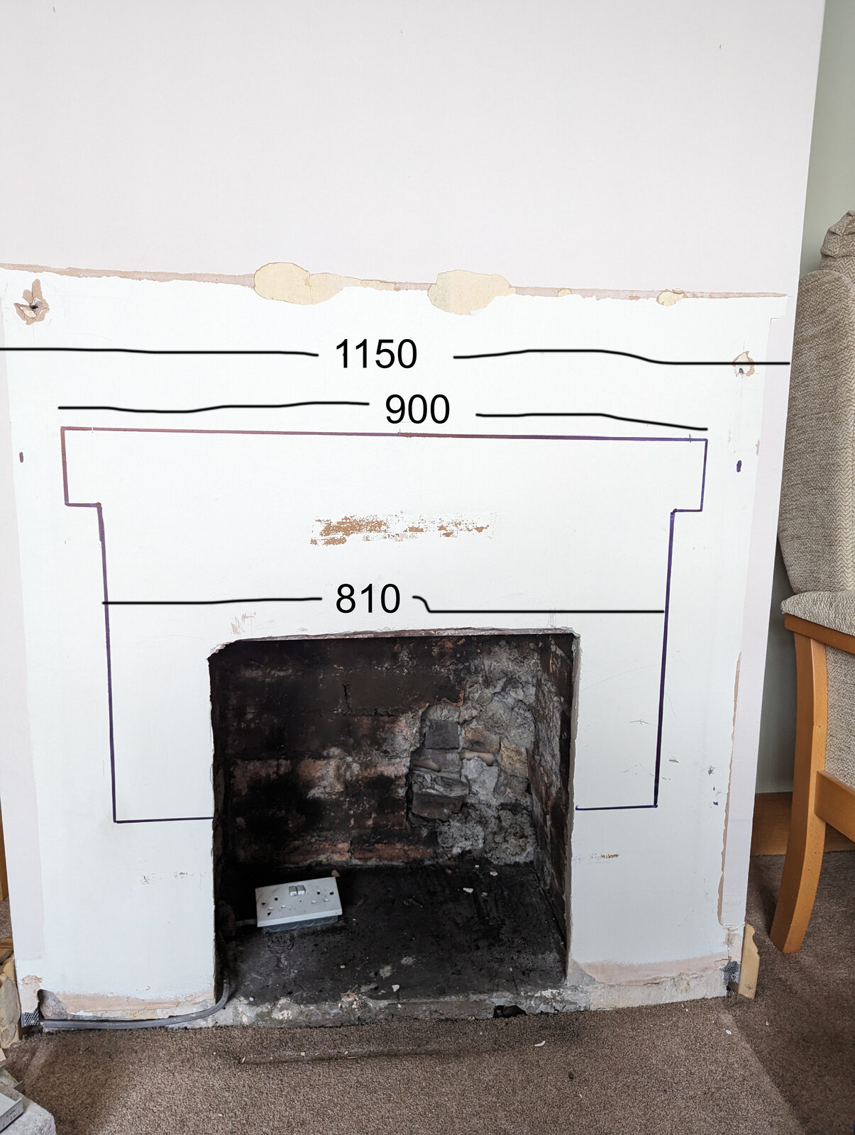

Hi I am looking for some advice I am looking to widen the opening on my chimney to fit an electric fire
The fire opening is 805mm wide would I need a lintel going the entire width of the chimney (1150mm) and if so would I need support the corners with acrows and strong boys
would a 900mm lintel be enough which I seriously doubt
The fire is 145mm deep so do not need to remove bricks all the way to the back

Maybe the full width of the chimney breast lintel is the best option?
You could use two spaced Strong Boy Acrows for support while inserting the lintel.
Use an angle grinder to open mortar beds - the least amount of knocking & hammering possible.
Sweep the flue, & consider flue ventilation?
A min of two workers would be needed.

So if I place an acrow prop about 150mm from each side that would be enough support to insert an end to end lintel

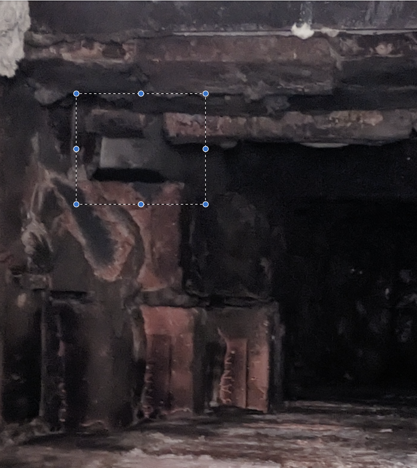

Looking inside the chimney there is a concrete block either side of the chimney at about the height where the top of the new lintel would sit - see picture
1 prop in centre is fine, the sides of your breast will support the rest (size 0 acrow) the concrete is probably the fireplace throat, you may have to remove it before the lintels are put in, a standard 1050mm x 65mm x 100mm concrete lintel is sufficient, you may need 2 lintels one behind the other, if you have to prop higher up due to the throat, rebuild brickwork on top of lintels.
Worth knowing that if you cut out 810mm you will probably be going into the structural jambs on each side of the chimney breast. These were often 9 inch brickwork, so you would be cutting out a few inches each side.
Yes these are 10" wide either side and 13" deep so I would be cutting in 4" either side and 6" deep would this be a risk
