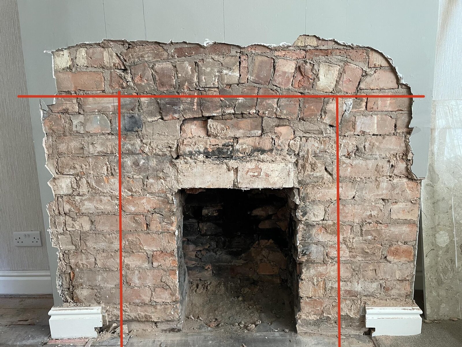

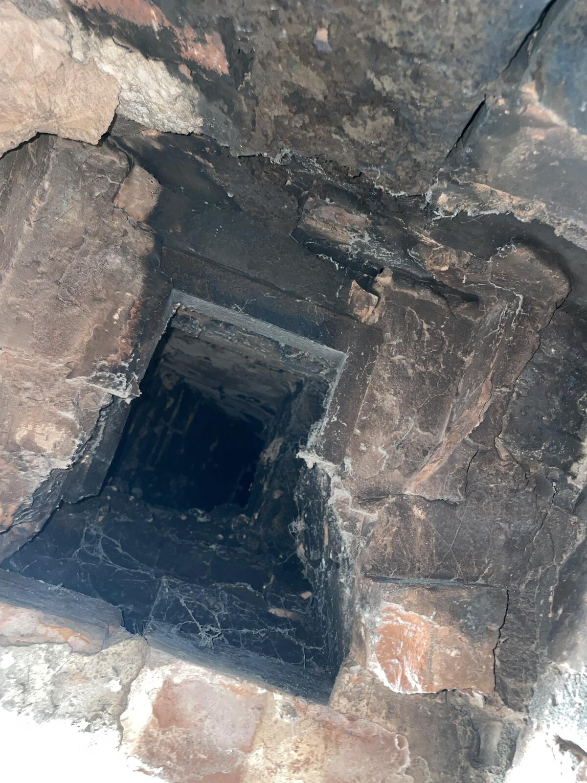

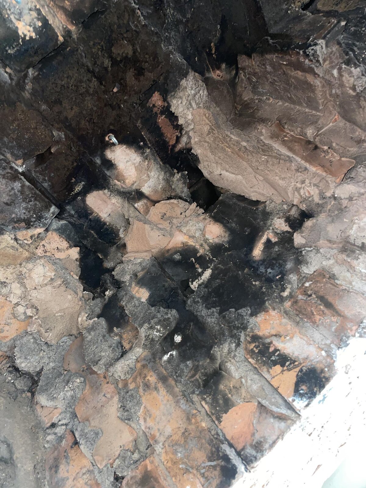

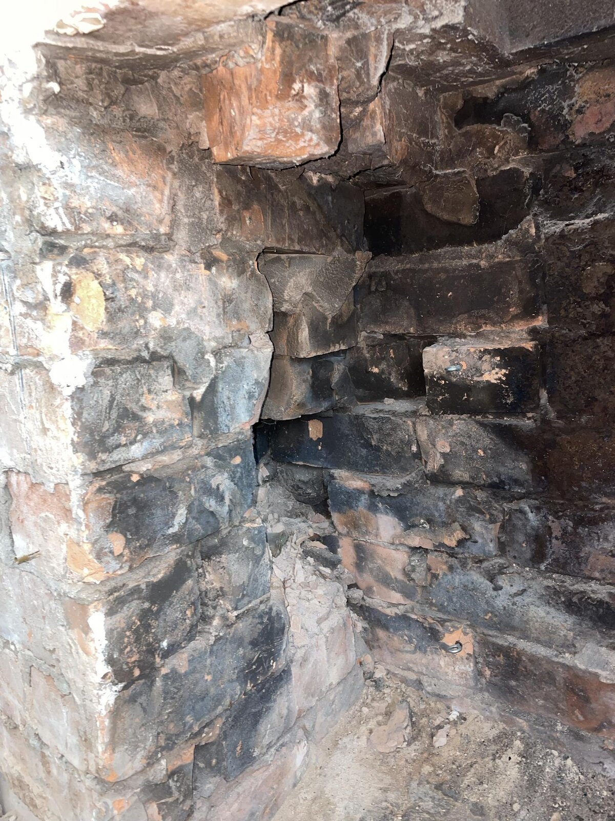

Hiya, this is my proposed plan.
I'll be putting a 100x65mm lintel in across the horizontal line to give me a height of 1025mm (900mm when hearth is layed) and we would like a width of 900mm.

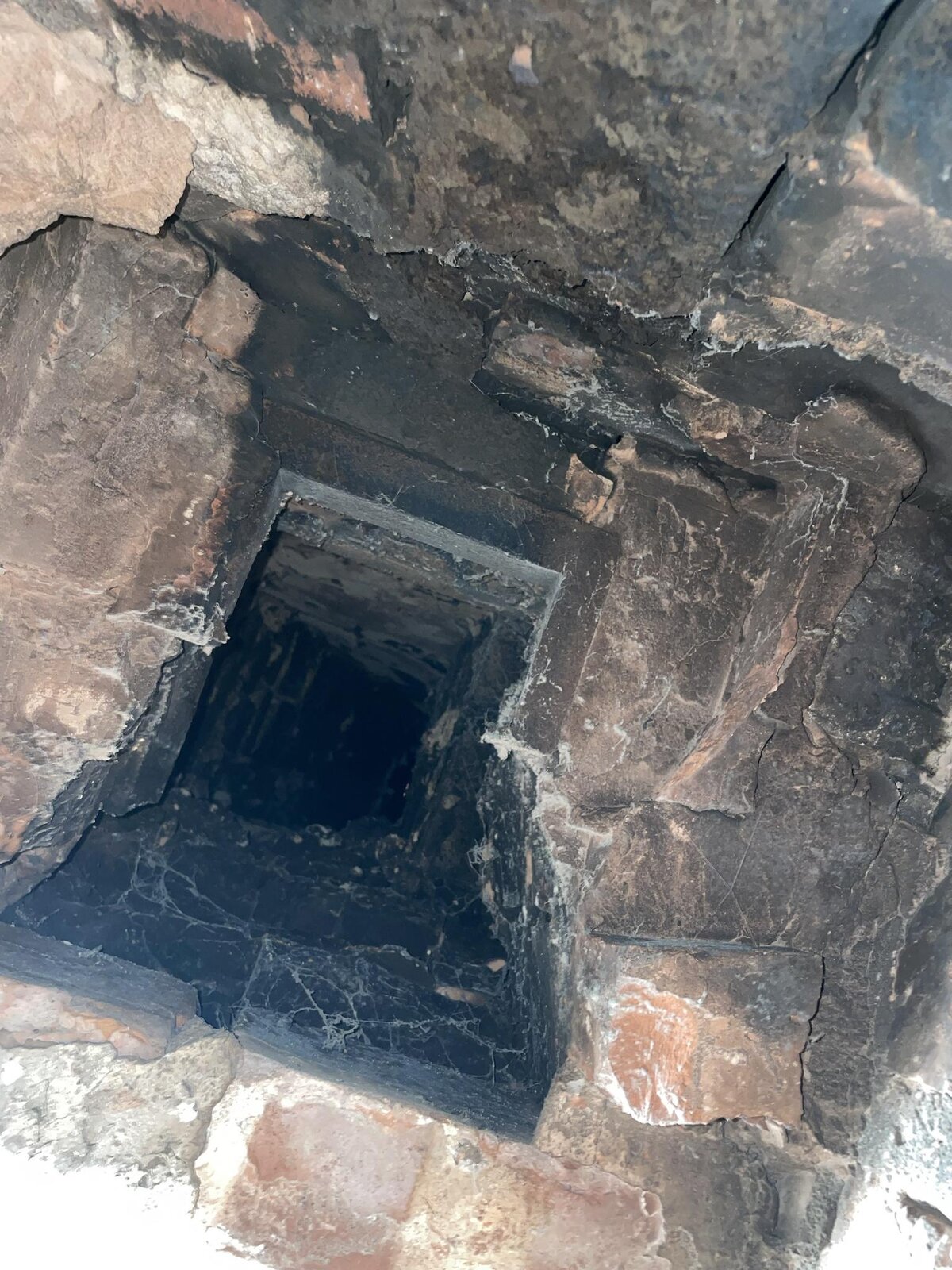

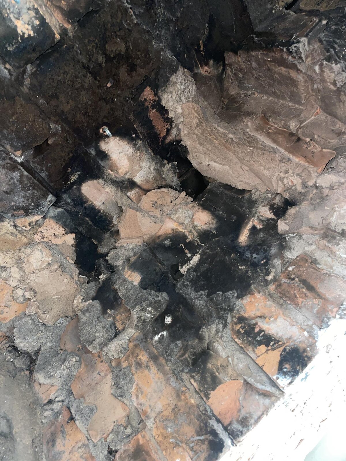

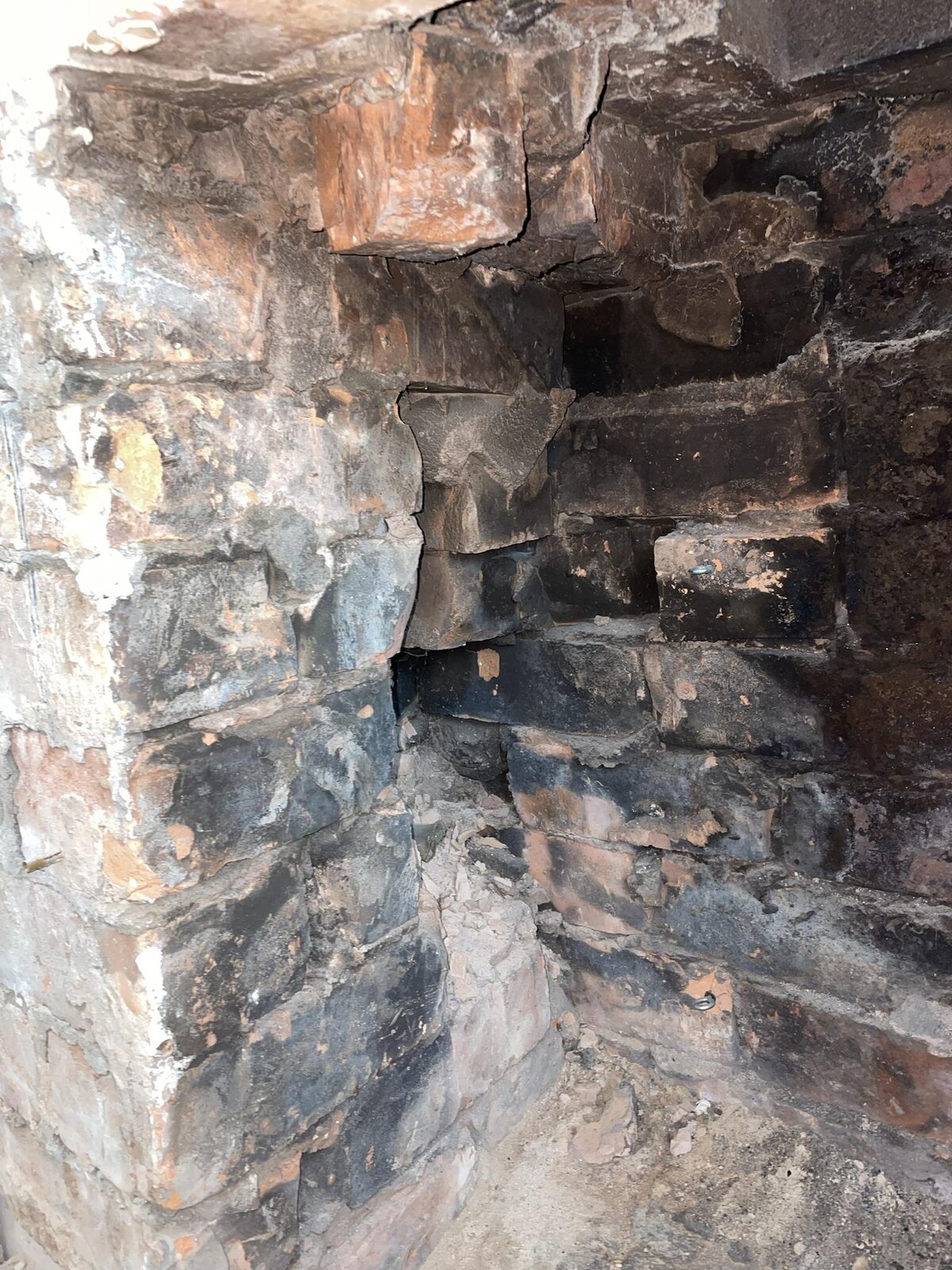

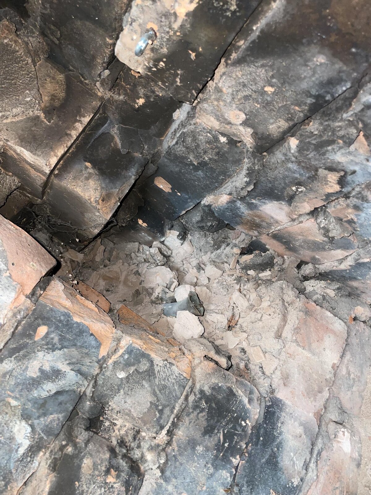

My worry is that I won't be able to remove the bricks on the inside of the opening, they seem structural. Could anyone confirm from these pictures that I'll be safe to remove the inside to the width above? FYI; the opening is currently 550mm wide, 670mm tall.
(1) Above - (2) Left side - (3) Left side back boiler opening - (4) right side.
(This won't be used again for a real fire, fake (electric) log burner/heater)
Removing the arch and bricks will presumably removal some of the structural support for the flue bricks, the load has to be transferred somewhere which is what the new lintel should do. But the lintel looks to narrow for the breast/jambs so a W lintel either side going perpendicular to the external wall may be needed. All structural work to be approved by BC even though no woodburner.
