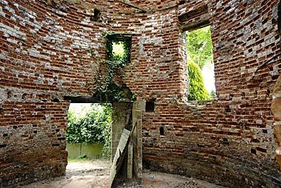

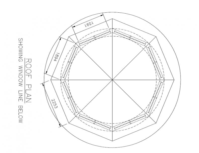

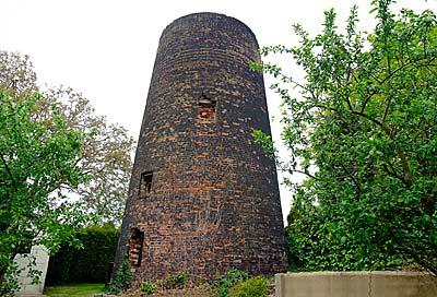

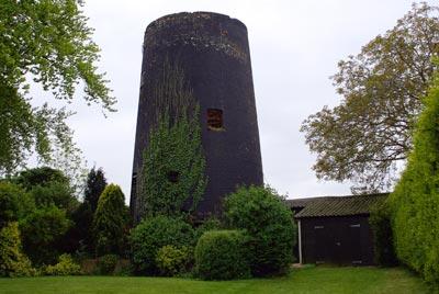

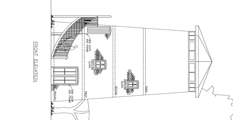

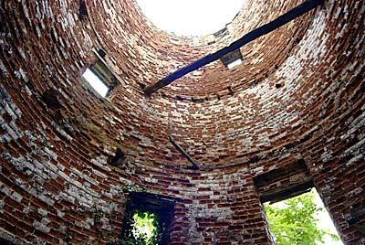

Does anyone know of a really wide cill for either uPVC or Alu windiws?
I have a round tower that I am planning on putting windows completely around - 8 windows, so octagon shape.
I am struggling with the cill width though - I need at least a 250mm cill to clear the brickwork due to the curved brickwork:
I have spoken to 6 different window co's and all are saying that max cill is 225mm.
Has anyone else got any other ideas?
(I am 60/40 in favour of Alu windows, but would choose uPVC if the cill was available. I love wood, but these windows will be 35ft up......I ain't going to want to get up there too much to paint them!)

The uPVC firms have all said the only way they can do it is by spliting the windows in 2 - i.e. effectively have 16 windows/cills..........but.........planning have said they want a new planning app if we do, and CO has said 16 windows = lots of plastic framing, and we have said lots of plastic framing = less light.
