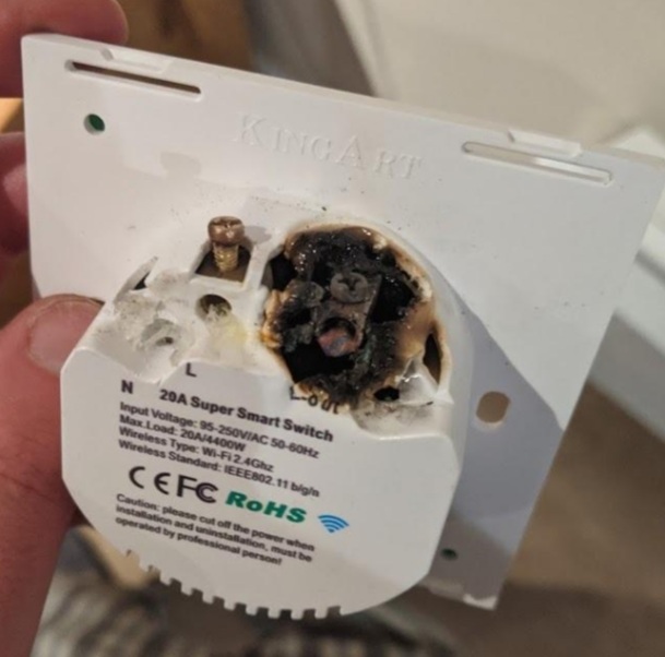

20A WiFi smart switches seem to be a 'thing', although it's not double pole (and as above, doesn't necessarily need to be).
...and some reviews aren't exactly complimentary (watch the size of your back box)!

Not very good reviews - plus beware of the wiring instructions mentioned.
