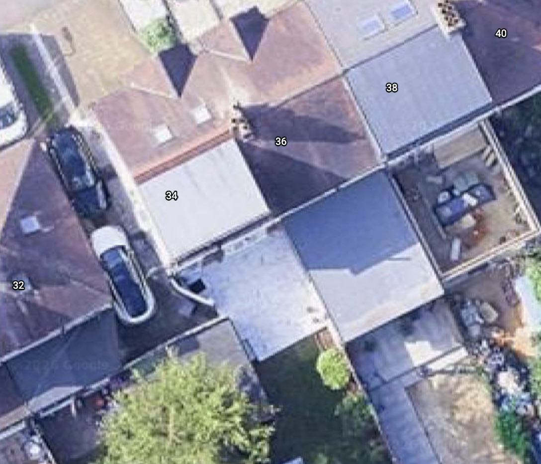

On a side point. How will the planners feel about the OP losing a parking space? As they will not be able to access their own garage. Some local planning policies are very protective of existing parking provision if on street parking is an issue. Check the policy hasn't changed since planning permission was granted 5 years ago. The architectural drawing provided seems to show access to the garage will be maintained but the aerial photo seems to show the extension will encroach at least half way across the garage?
On a side note, going through the council's planning portal, it seems as though number 34 on the screenshot attached was refused permission: "The Local Planning Authority considers that the impact of the proposed development on the amenities of the adjoining residents at 36, would be unacceptable as it would cause demonstrable harm in terms of overshadowing, adverse outlook and increased sense of enclosure to the amenities of the above occupants. Prior approval is required and the application is refused because of the above stated reason."
I looked at their submitted plans, and it would've been as deep as the extension in number 36 already in place! And number 36's plans and building was already done years before number 34 had theirs refused.
For me as a non-expert it seems as though the council are quite inconsistent in accepting and refusing!

You need to check what the guidance was that was in place when that application was approved. In anycase precedent doesn't really exist nowadays in planning (especially for domestic extensions) just because something was approved previously does not mean the council are bound to approve the same thing again.
Furthermore, depending on the Local Authority, sometimes the guidance regarding domestic extensions is woefully lacking, this can be both an advantage and a disadvantage and can leave the decision to approve or not down to the planners discretion rather than any criteria written in the guidance. Sometimes planning sucks.
This is what I'm wondering. Was it just a crap architect then? It was submitted on the November 2020, so wonder if it was a hurried job due to COVID lockdown etc.
