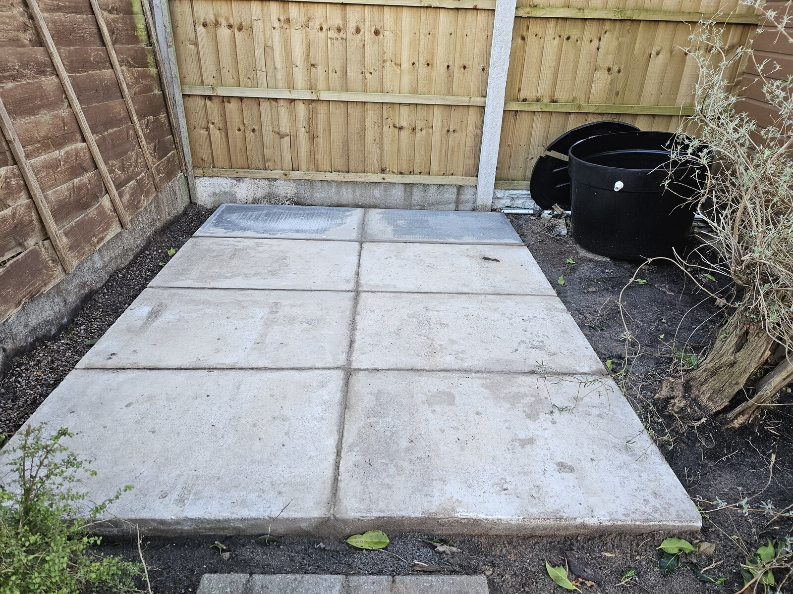

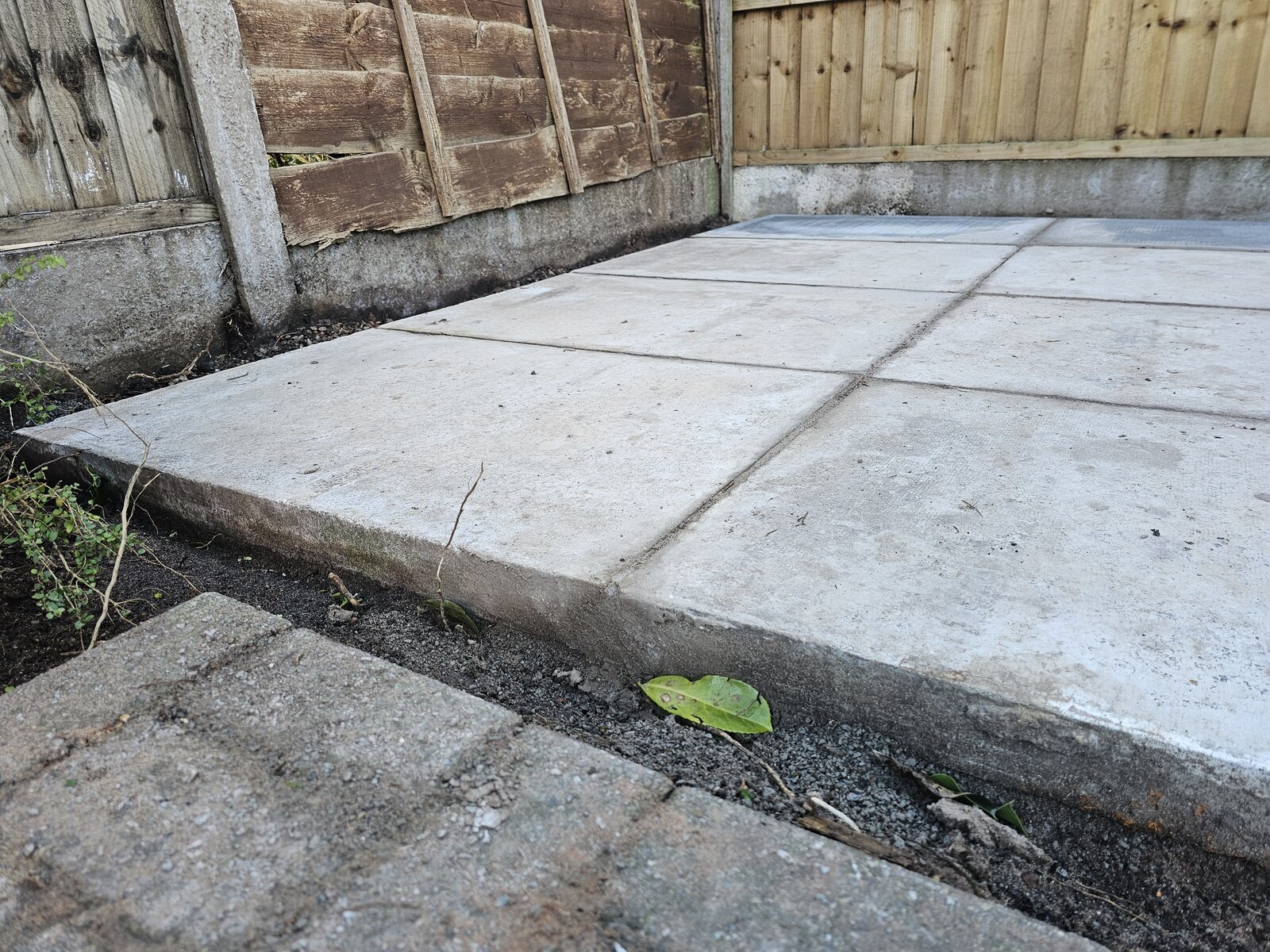

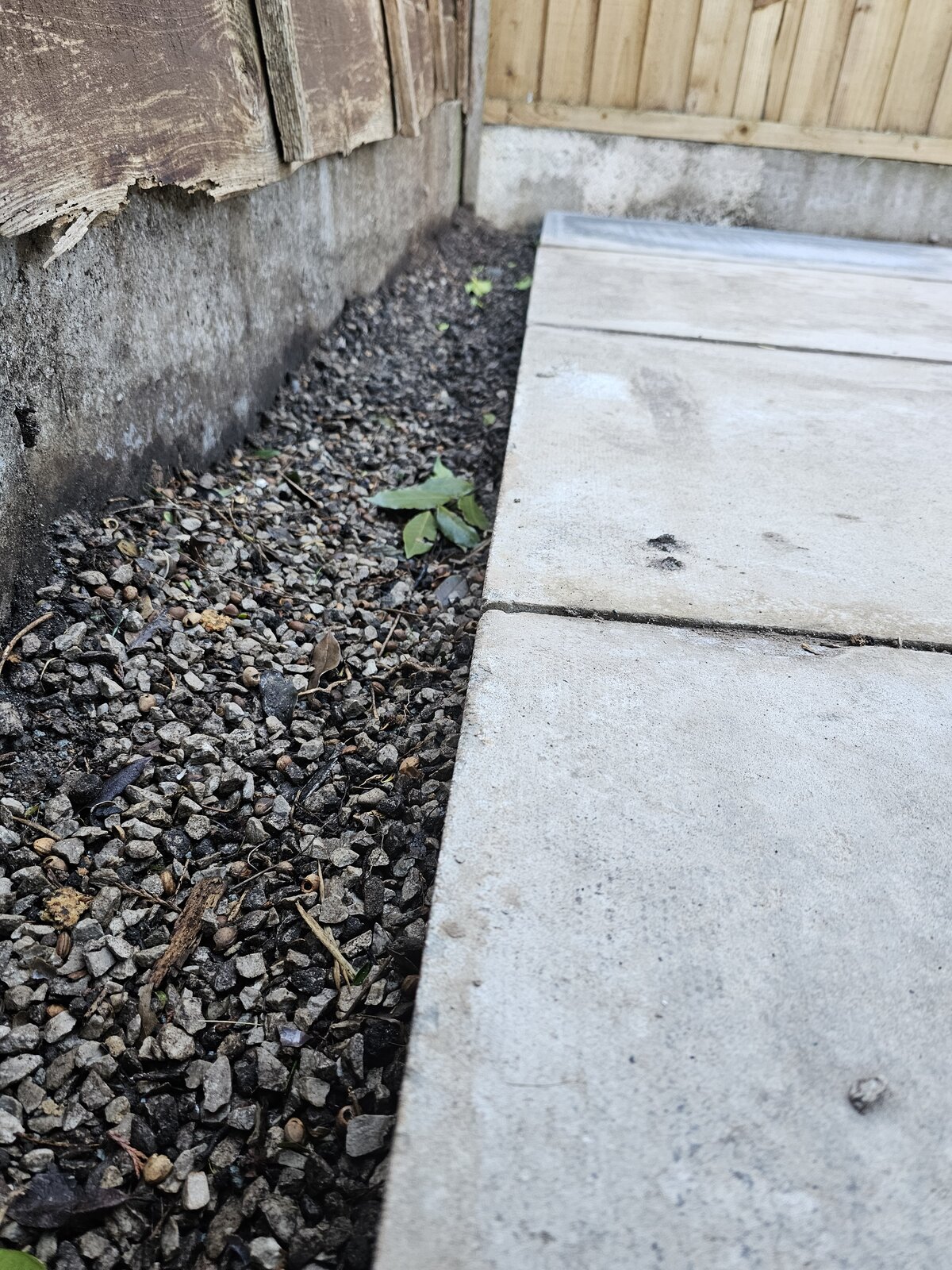

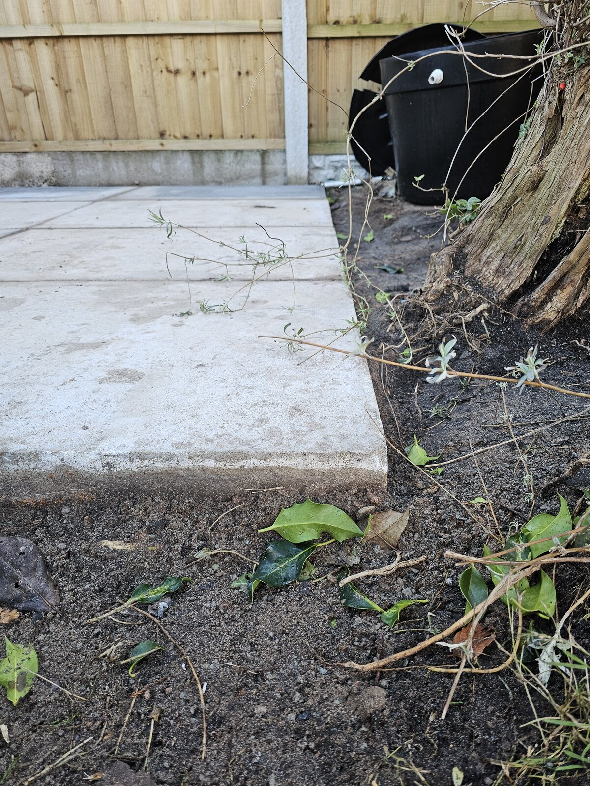

Hello everyone,
I've had some concreate slabs laid/re-levelled in preparation for buying a new keter shed.
I want to buy the 6 x 8 ft shed but the the slab dimensions are 241 cm / 7.90682 ft & 180.5 cm / 5.921916 ft
The plan is to lay 20mm limestone around the slabs to act as drainage. If I lay the stones to the same level as the slabs would that be ok or would the shed still warp?
Attached some pictures for context

Keter shed walls aren't very thick, so I doubt they'd be properly supported by the slab as is. Perhaps extend the slab area using bricks?
I did something very similar to this recently, and had the same concerns.
All was solved when I just went out and bought 6 3x3 fence posts and laid them on the slab’s first. I didn’t even join them together. My ( plastic) shed sits solid and doesn’t twist.
Do you know the dimensions of the shed? This one here is 177x230cm, so slightly smaller than the slabbed area?
If the shed overhangs the slabs, and the pebble surround is lower, it will prevent rain collecting on the slabs and causing damp.
The fence posts or similar bearers will provide a ventilated airspace that will also help. Have them under the shed to keep rain off.
Animals or rubbish may get into the void if if is not blocked off.
That's interesting as I looked at the green shed and although they are both advertised as 6x8 the Grey is slightly smaller so I may opt for that to save the hassle. Thanks for the tip
Grey Shed = Minimum Foundation Size = 177x230 cm
From <https://www.keter.com/en-gb/sheds/manor-shed-6x8ft-grey-230256.html>
Green Shed = Minimum Foundation Size = 183x244 cm
From <https://www.keter.com/en-gb/sheds/medium-sheds/darwin-shed-6x8ft-green-259273.html>
