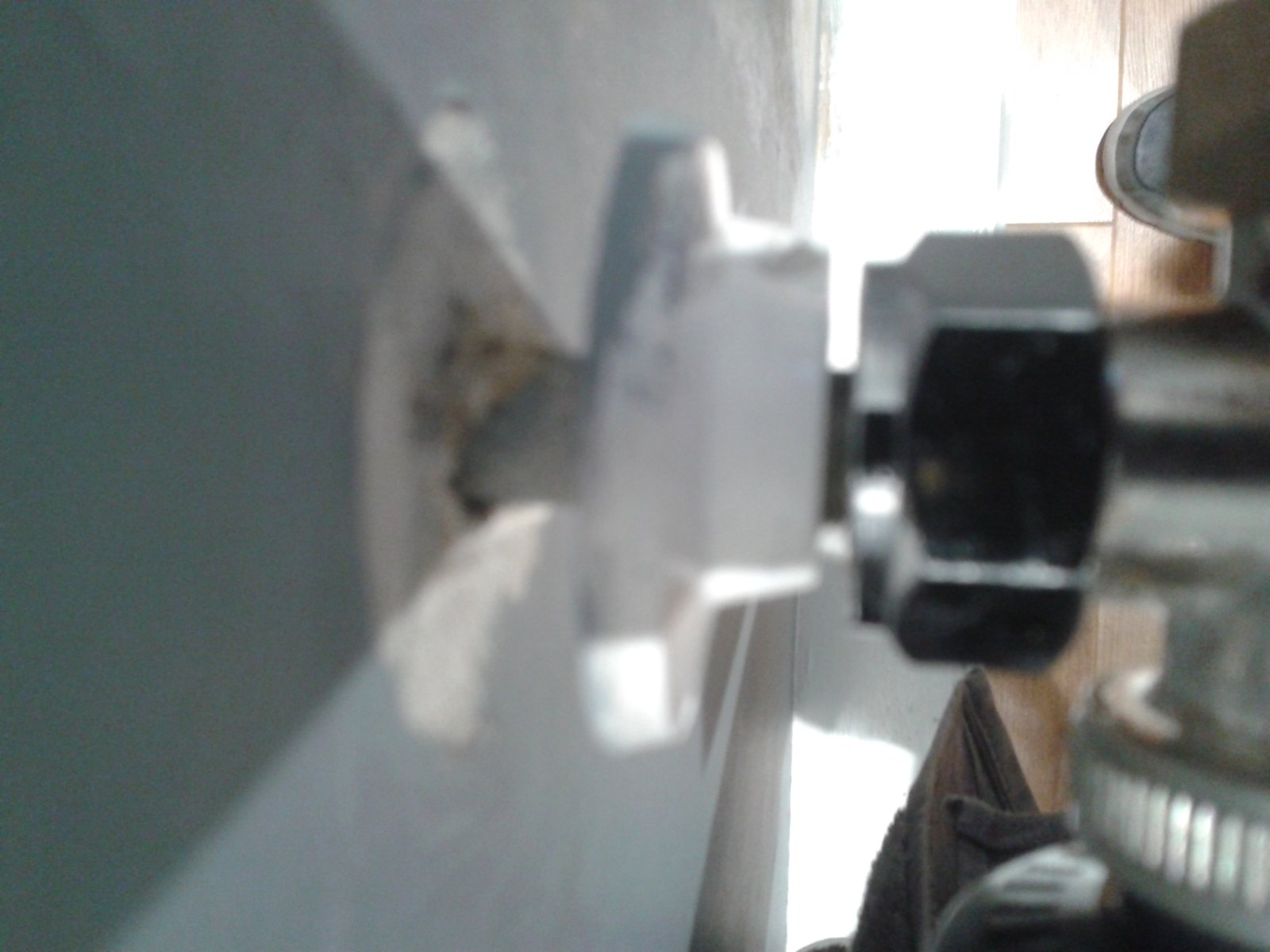

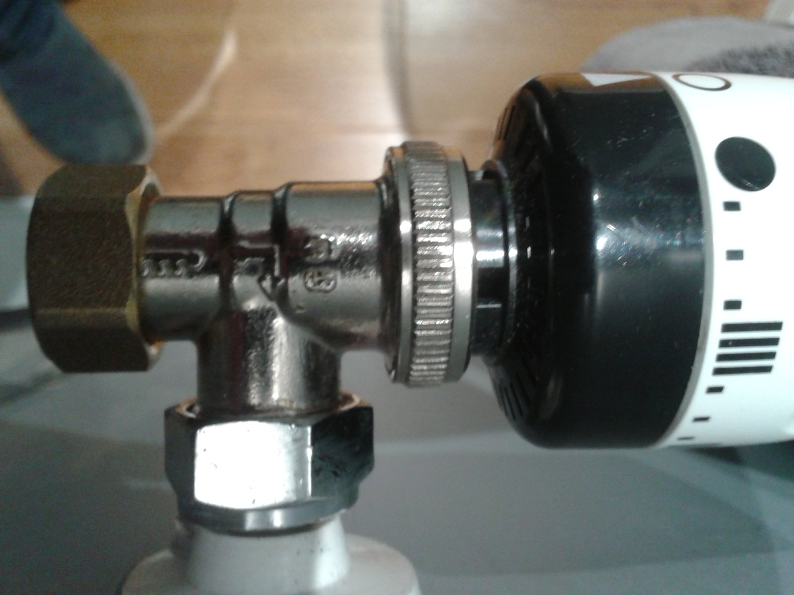

Hi , i just removed a radiator in my sons wimpey house , & was surprised to find the pipe that runs through the wall to the radiator valves is a flexible hose , does anyone know what pipe / valves they use & how the pipes are sealed to the valves,
thanks in advance ,
As Dan says, a photo may help.
It will probably be either Speedfit or Hep2o, newer Taylor Wimpey houses should have Hep2o installed, some of the older ones had a dual specification and could be either Hep2o or Speedfit.
Have a look under the sink, basin etc to see if any fittings are visible this should enable us to identify which is installed.
As for the radiator valves, if there are no visible markings then post a photo.
i took a couple of photos before the radiator was put back up , they are not great due to the valve coming away from the wall only about 1/2 inch , looking down the wall the pipe looks as if it just pushes onto the back of the valve , but hard to see without dismantling it , i just took rad off to flush through so didn't want to dismantle the valves , but may put a bigger 1 at a later date, that's why i'm wondering what pipes were used .

i meant to say ,f you look at the photo where the pipe sticks out there is some kind of compression fitting which must keep the pipe attached to valve
