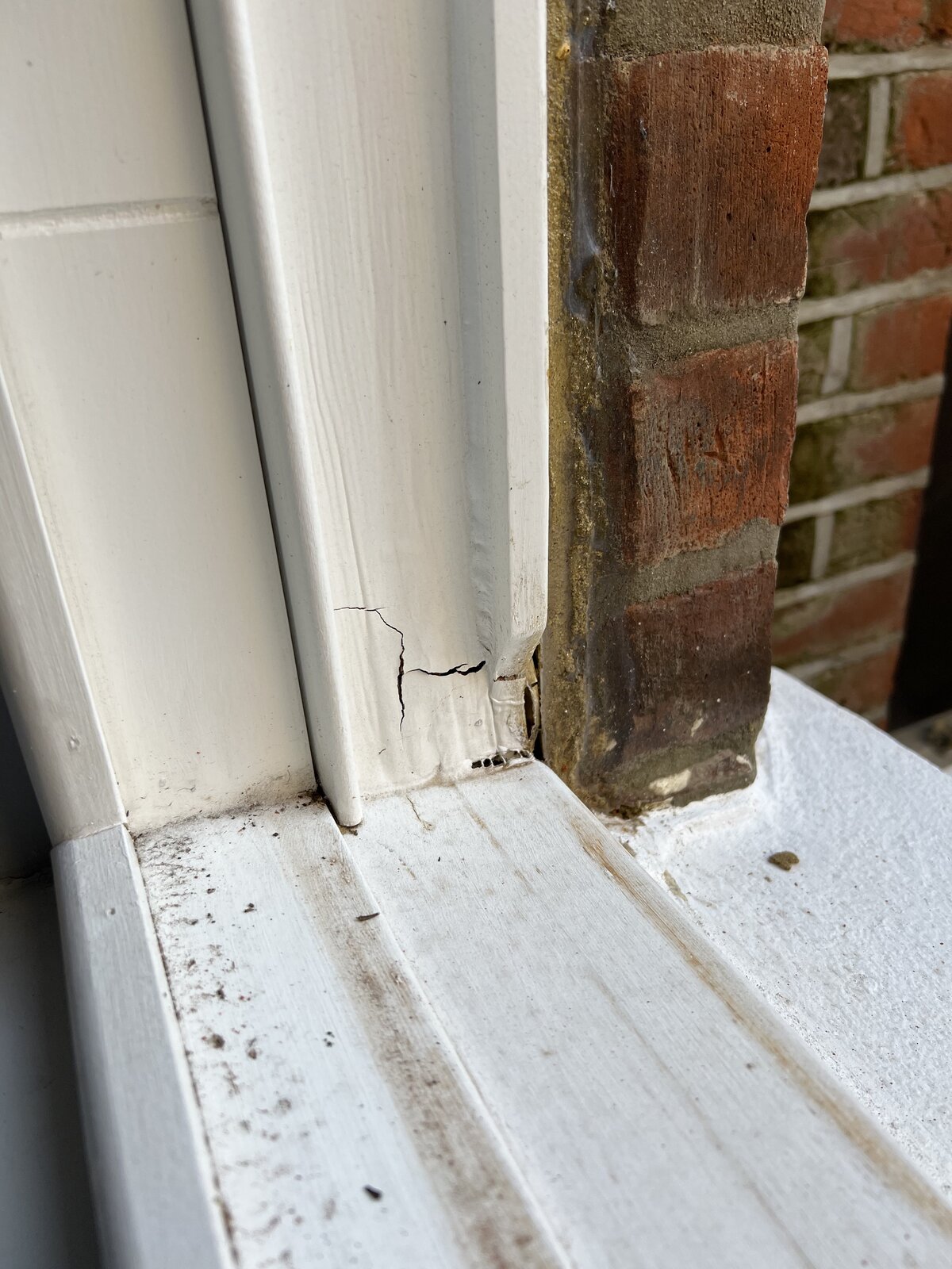

Hi,
My builder installed new wooden sash windows for my flat last summer. Unfortunately, it seems the corner of the window frame is a bit rotten (pic attached).
I don't really know how big this problem is, and what is the best way to repair the damage. Do you have any suggestions? Thank you!
thanks
Patrick
A combination of a two part epoxy filler and new sections of timber cut to shape, depending on the extent of the material removed.
Blup
At one year old it is exceedingly unlikely that you have any rot - that generally takes a few years. Almost certainly that is (oil based?) paint which has bubbled and cracked in the recent hot weather. The mastic (?) sealant between the frame and the masonry also appears like it may have cracked so worth checking the rest of the frame. So, just take a stripping knife or scraper and pry away the cracked paint then inspect the wood underneath. In all probality you should be able to sand out the area, reprime it, then repaint it. A chespish repair. I doubt there's any need for fillers, resins, wood hardener, etc
