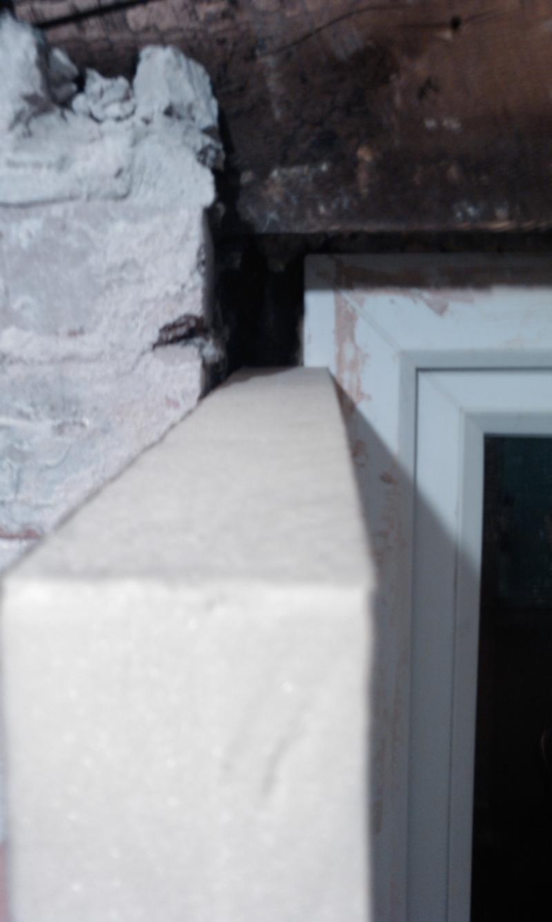

Dann - this is a first floor room, so will try and get a pic of external view from front garden as soon as possible (ie in daylight :) ) Yes open cavity reveals - they haven't been closed. No bridging at any point and no signs of any water ingress nor rot. No missing beds but pointing could probably do with seeing to. As you can see the window is narrower than the internal reveal and so n order to reduce the width of the opening such that it is right my plan was to use some 50mm celotex faced with pb fixed to the walls & covering the cavity on each side. This would give me just the right depth to bring the window frame 'inside' the reveal. And I could skim over the plasterboard once at that stage with the brickwork inside the room.

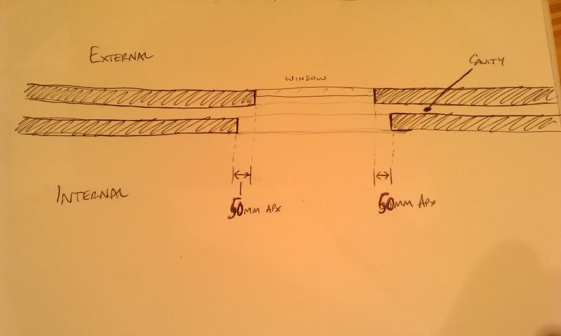

I dont understand what you are proposing.
The pointing i'm mentioning is in the interior reveals below the crooked padstone etc.
Your window frame - PVC or otherwise - should be set back in the opening, say 75mm is v. good. If i understand you, you are proposing to move the W/F?
Box frames are the traditional wood windows that slide up and down. The original PVC W/F fitters are possibly the cause of some of your difficulties.
Ah i get you - like a sash window, or those ones that have shutters that fold back into the reveal....

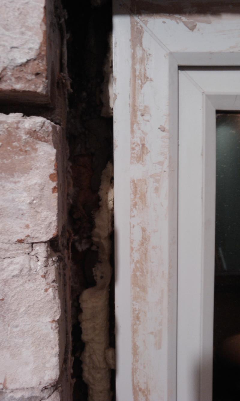

No not moving w/f. PVC frame is fitted on external skin of brickwork on a concrete padstone, all of which is fine and dandy. Problem is that the width of window opening on internal brickwork is wider than the external, i have added a rough sketch to illustrate & some closer photos which I hope makes it clearer. Yes original PVC fitters (before I bought the house) probably have bodged it up - house is ex council & being cynical I expect they ordered 10k of a standard size frame & made them fit the openings in all houses :?
the brickwork in the foreground is the internal wall - the frame is 'foamed' into the external wall.
in this one i have held a piece of 50mm celotex insulation up to the brickwork & window frame.
