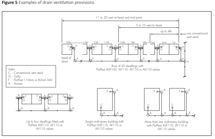

I love the idea of fitting an AAV. I just don't see how to relieve any potential back pressure when using the AAV.
We have two stacks that join under the floor, one has an aav and the other an open vent. We always know when the drains are surcharged or blocked because we get bubbling air/gurgling in the downstairs toilet and the kitchen sink, which go into the aav stack. The trapped air has to get out somewhere. Other than that no issues.
If you have no open vent at all you rely on the neighbor's ones, which would block earlier, so you'd get more bubbling. And if the whole street switch to aavs then best of luck who gets it all coming through their shower tray (usually a shallow trap)

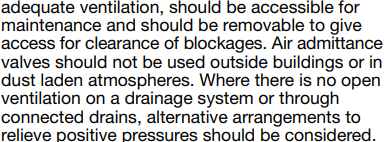

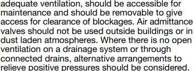

I really don't think BC would sign off an AAV unless I added a vent somewhere. The last 4 lines of the regs appear quite clear. I think I will have to have a chat with BC at project initiation to understand my options. Thanks all.
That was lifted directly from Building regs part H. so now totally confused after reading that FloPlast document.
