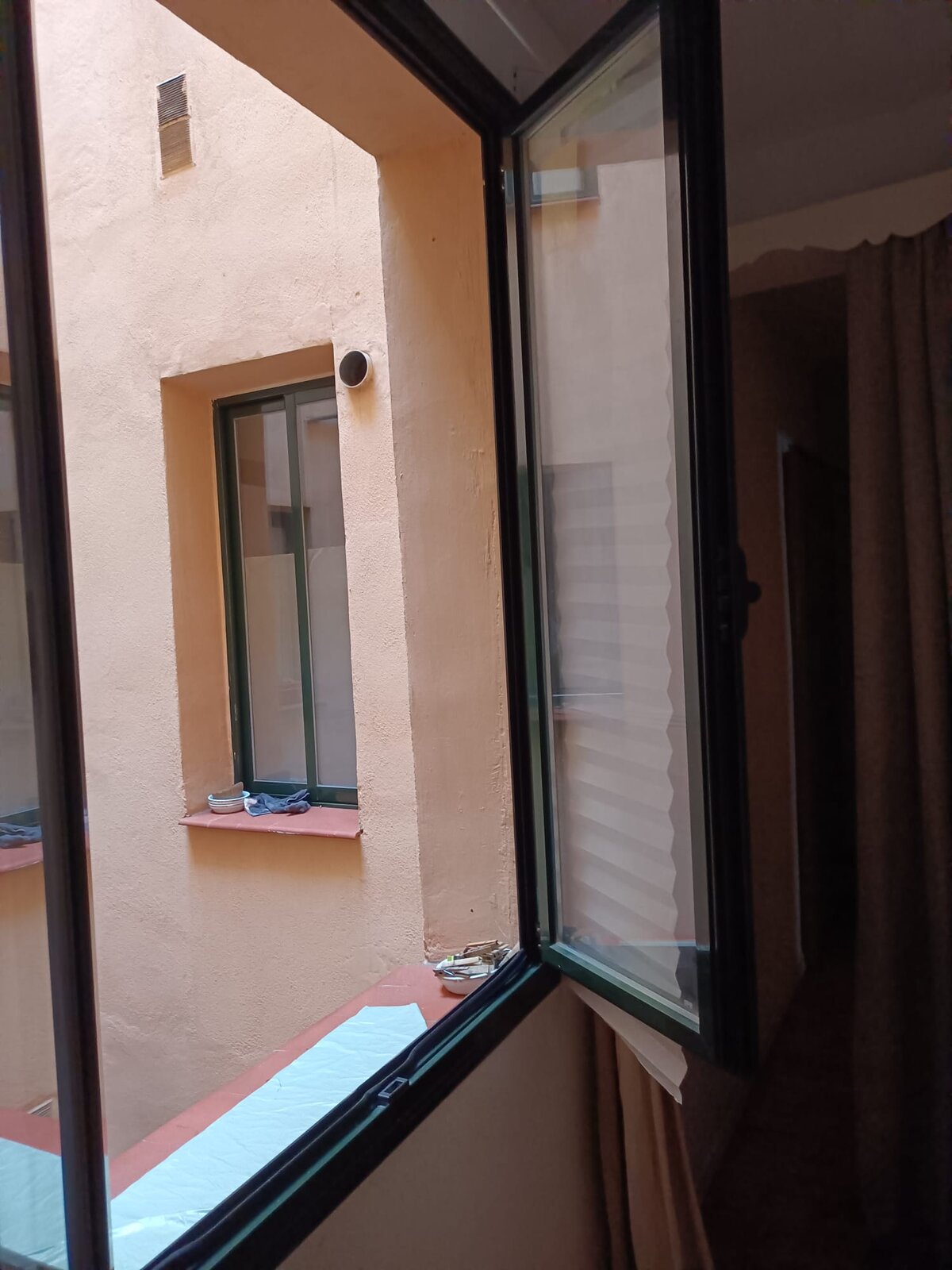

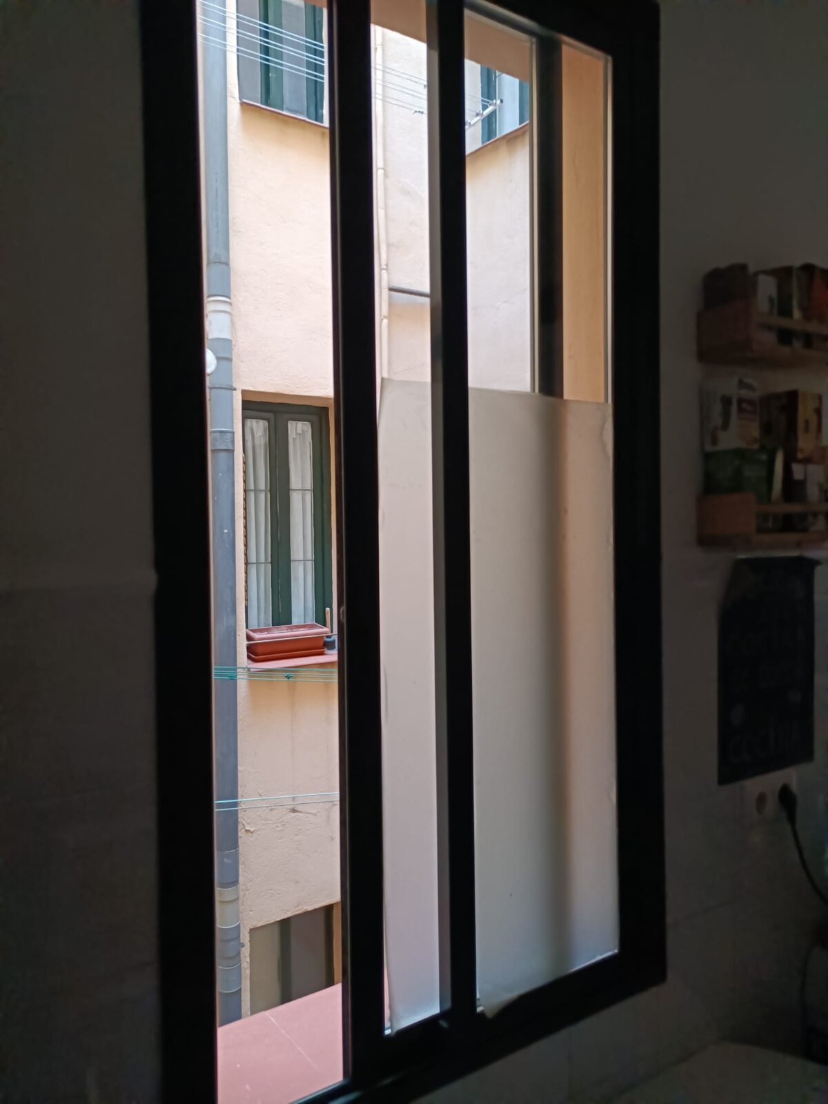

That first one opens into the house as you can see. The next one is a slide window coming up next
A cat safety net would work but would need to be fitted to the outside of the window or jambs, not easy 4 storey's high to say the least!
I think if I was approaching this it could be done fairly simply by creating a 4 sided frame formed with say 10×10 aluminium angle, riveted at the corners and painted to match the window, looking at the way the windows open I think you could fix it in place from inside the property, your cat net attached to the frame, it would only need say 2 fixings in the top and bottom members into the cill and head.
On that slide window I think what you're saying will work well. I would like to get something that is aesthetically pleasing though, maybe a finer pattern this disappears to the eye, as the building is quite nice and my wife is an interior designer. I'll leave that part up to her, :LOL: but thanks everyone for the suggestions.

Your cills outside look quite big so I wouldn't worry too much, he'll only want to sit outside in the breeze
