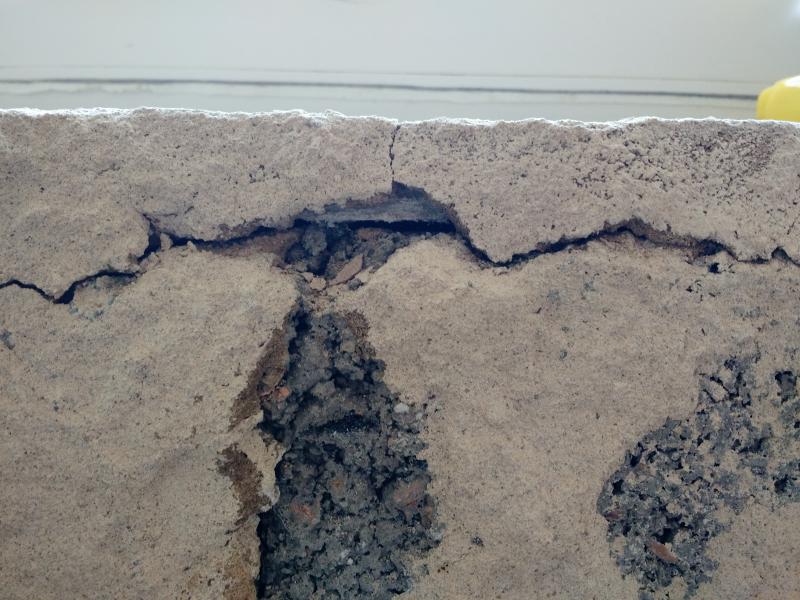

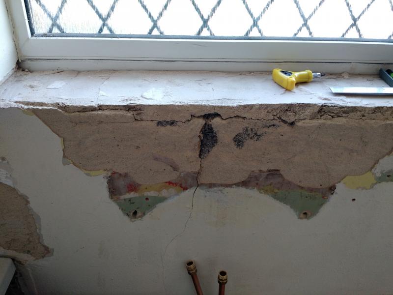

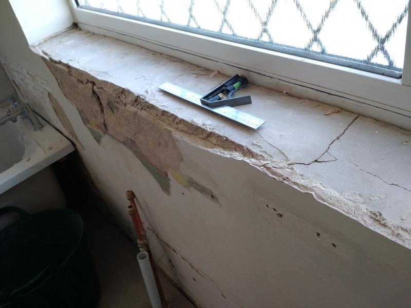

Renovating bathroom in a 1970s semi, taking tiles off the sill brought up chunks of plaster and cracked the rest.
So I've taken the rest of the plaster up leaving what looks like a bed of mortar. This is also cracked, but after knocking a couple of loose bits out of the way, noticed the white fibrous board shown in the close up...
I've used the dreaded 'A' word, no scientific evidence, but given the appearance and some mentions of asbestos boards being used as general packing around that era have assumed the worst.
My question is what can/should I do?! I don't mind leaving it in but would want to make the sill solid before tiling over, so any ideas on that welcome

Its a commonplace that finished tile is only as good as its background but you only have a small area to remedy so Gripfill etc (but not foam) would do the trick.
You could: Skim a little cementitious tile adhesive into the patches (use it as a filler) and force it into the cracks - allow it to dry then begin tiling.
FWIW: Perhaps clean off all the remaining tile adhesive from around the bath tub and below the window before doing anything else.
If the gypsum plaster skim over the blockwork is actually hollow or loose then come back here.

For the cracks.. i'd use cheap resin mortar although with my destructive perfectionist nature would no doubt knock off all the cracked bits off and start a fresh.
You know you could always bag a sample and get it sent for analysys. Dont htink it costs much. You could even ask somebody to quote on removal and they may do the analysys for free.

The risk of fibre release from asbestos cement sheet is very low. Even less when the sheet is b actually inside a wall.
It's unnecessary to test this, or treat it, or remove it in this location. Or even worry about it.
Looking at the photo again.. I'd agree it does look like asbestos cement board that may have delaminated. I hadn't spotted before hence why i said "if it is asbestos." So Woody's right on three counts..
1) when encapsulated it poses no harm.
2) it doesent need a survey to diagnose.
3) It doesent need and is best not to remove. In fact removal would make it worse.
However where i would beg to differ is that given where the crack points are around it, then it has broken down to some degree. Therefore fibres (if detached) would have become airborne at time of disruption of the area. and will therefore be around the area...
