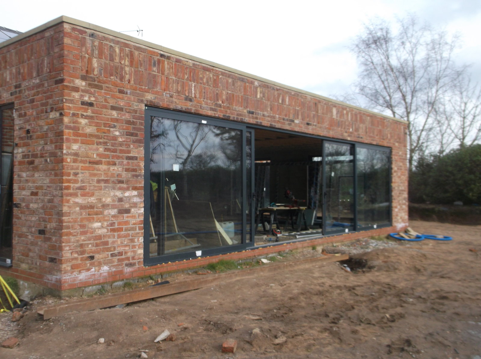

The attached pic shows what can be done on planet earth. The bifolds are just over 5m long*, and note the short wall each side. The beam above is a simple fabricated beam, which also carries the point load from the beam supporting the flank wall at first floor, near the left-hand bearing. No windposts within a mile.
There are no padstones, just a 275 long bearing each end (padstones on the outside would look naff anyway).
Get back on the phone and get them to do the job properly.
Corr: litttle under 5m long.

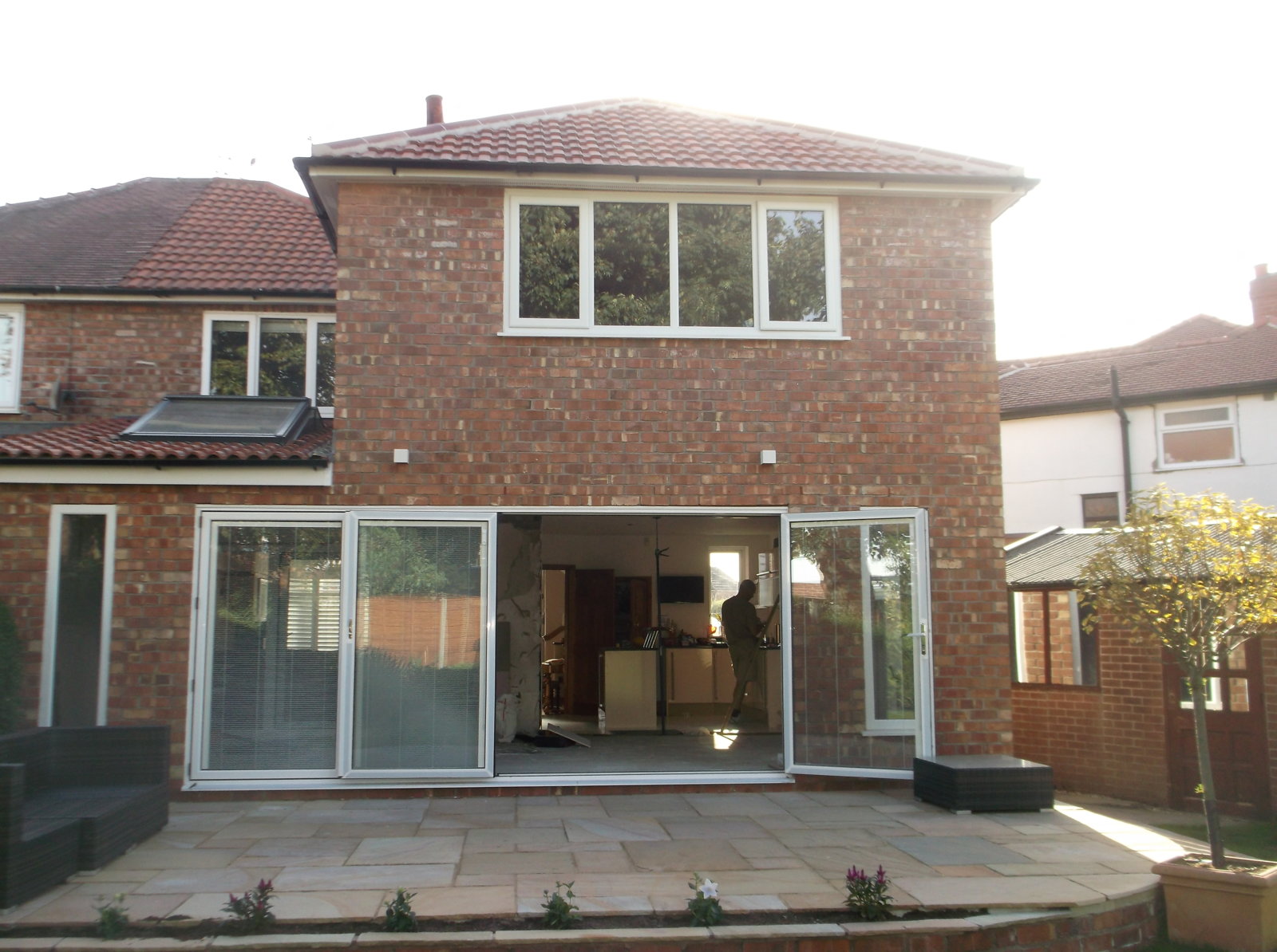

Tony. Mine will not be too far off your pic except its got another a bedroom above the left and right side. Sounds like my job has been over engineered. But better to be safe than sorry. Thanks for all the replies chaps.
