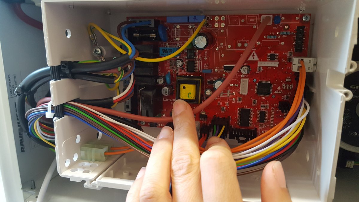

Hi
I have ravenheat cs80 (dont judge me ) anyway just had the conversion done so have no roomstat as i told the spark to get rid of it and no trvs on the rads as i've had no time to replace the rads as I've only just moved in.
Anyway the ravenheat cs has an internal programmer.
I decided to get a honeywell cm927... i can see the link on the board for the roomstat. But where do i go from there?
Sounds like a thick question but it is what it is wiring amd diagrams arnt my strong point.
Anyhelf would be much appreciated
Do not mount the base box too close to boiler as with some boilers the fans can produce interference. There are two independent connections for the base unit. They can be linked, but they can also be independent, so you need a 230 volt AC supply, and also two wires to where link was in boiler. You may be able to get 230 volt from boiler, but you don't have to.
nowhere to take the live and neutral on the board like i was planning to. Gonna get my mate from work to talk me through it as i know I'll have a frank spencer moment
Live and neutral can be taken from spur that feeds boiler or L.N within boiler control box/board.
Unless you remove integral programmer for boiler then it'll require setting to constant.
Im leaving the original clock on as its integrated with all the menus so will be leaving it on constant. All the connections are on blocks (not the screw type) its the clip type like on the wiring harness.
Splice into the 240 volt supply to the boiler and use a wiring centre , if you're struggling at this stage then I don't hold out much hope for you.
neither do i. I thought i could just take l and n from the block. Im no "repair" engineer i just clean boilers for a living. I'll sort it out tomorrow cheers anyway
