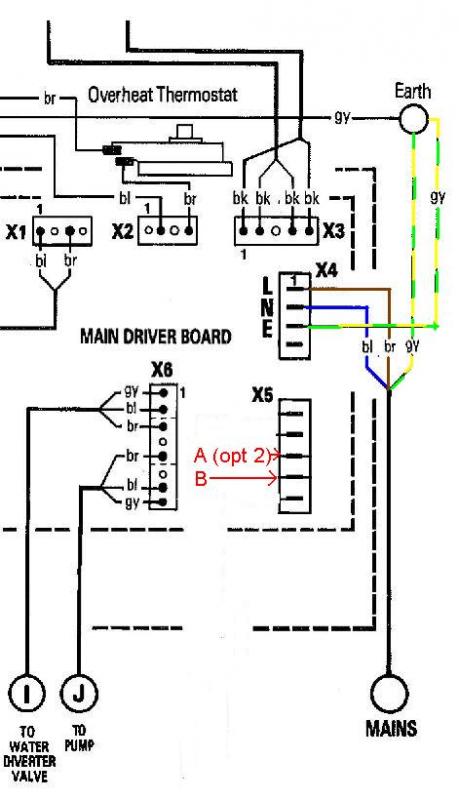

I have an existing worcester 280rsf boiler that has worked fine for years and I want to install a remote wireless room thermostat (honeywell cm927 or similar) but I am unsure of the wiring. At the moment the boiler is either on or off and I want more control.
The existing system is as follows
A fuse to a programmable digital timer and then a 5 core wire from the timer to the boiler
Inside the boiler the Brown is connected to the top terminal of block X4 (I will call this 4)
The Blue is connected immediately below (3)
The Green yellow is connected to the bottom terminal (1)
Another Green yellow comes out of terminal (2) to earth but nothing goes in. Is this correct?
The other 2 wires are black and go to block X5 both are routed to terminal (2) of this block second from bottom and I assume this is the link i have read about. It is in the section labelled room stat and has three terminals in this section.
Two more terminals (above) are also in this block X5 labelled frost stat and are not in use
So how do I wire up the honeywell receiver? which i have not bought yet!
I also have rad valves some in use some not but that is another problem for another day
Please help in simple terms if you can

3 and 4 are correct but, according to the manual. the green/yellow should go to the earth terminal not to 1. 2 is OK
Can you find out what happens at the other end of the 5-core cable?
You only need a frost stat if the boiler is located in a garage etc where the air temperature could drop very low.

i removed 2 screws from the base of the programmer and lifted the unit off the wall. on the rear of the unit is a wiring diag corresponding to 6 terminals still on the wall. The terminals are marked on the diag as
N L 1 2 3 4
1 is labelled comm
2 is labeled off
3 is labelled on
The actual wiring in place is as follows
From the fused unit to the programmer we have three core
Blue going to the first terminal (N)
Brown going to the second terminal (L)
Green yellow to an earth
From the programmer to the boiler we have five core
Blue going to the first terminal (N) common with above
Brown going to the second terminal (L) common with above
Green yellow to earth common with above
There are also two black wires commoned up leaving the fifth terminal from the left which is ON according to the wiring diag
In addition there is black wire looped between the second terminal from the left (L) and the third terminal from the left which is (1) COM on the diag
Hope this helps
The wiring as just as I thought it would be. The two black wires have been commoned to prevent one accidentally touching a wrong terminal if it was loose.
The CM927 relay box could be placed in the same place as the LP711, but I suspect you want to put the control unit there. In that case, mount the relay box near the boiler (see instructions for suitable location).
The boiler needs a permanent LNE supply; at present this comes from the fused spur via the LNE terminals of the LP711.
The relay box only needs a mains supply to the L and N terminals (no earth as it is insulated). This can come either from the same fused spur or from the boiler's L and N terminals.
Lastly you need an on/off connection from the relay to the boiler - equivalent to the black wires. There are two ways of doing this:
1. Link L to A in the relay and connect a wire to B and other end to same terminal as existing black wire (X5/T2)
2. Connect a wire to A and a second to B. At the other end connect one to X5/T2 and the other to X5/T3.

This is what the boiler manual shows:
As you can see the incoming earth wire connect directly to the earth terminal, not to X4/T1. There is then a connection from earth terminal to X4/T2. There must be a good reason for this, so I suggest you do the same.

Doing it your way is actually the easiest and you can use the existing wires as follows:
LP711 - CM927 - boiler
L (both) - L - (one) - L
N (both - N - (one) - N
E (both) - Terminal block - (one) - E terminal
Black 1 - A - X5/T3
Black 2 - B - X5/T2

Just received a Honeywell CMT927 and I have been checking it out with reference to your recent most helpful advice.
Inside the receiver are six terminals
A, B, C You mentioned using A & B for the existing black wires - good
On the other side (lhs) there is N, L, L terminals
I am unclear on the two L terminals
Do I take the L from the Fused box and connect to one of the L terminals in the CM
and
take the L from the boiler and connect to the other (second) L terminal in the CM
Sorry to be a dumpling but I don't want to blow it up!!
I will give the manual a good read before I start the installation
The left of the two L's is for powering the device from your fused spur/wiring centre/boiler.
The second L is for providing mains voltage to the switching circuit if you need it. In this case, link the L to A. Be then goes back to your valve/boiler.
If the wire leading to A is already 240V then you don't need to bother.
Correct.The C terminal is used when you are controlling a cooling system
Do I take the L from the Fused box and connect to one of the L terminals in the CM and take the L from the boiler and connect to the other (second) L terminal in the CM
That's what I would do.

I connected the wiring up as discussed and got the transmitter talking to the the receiver.
I increased the temp on the transmitter to get the boiler to fire up and nothing.
The boiler works on demand from the hot water tap, so i must have done a connection wrong, but which one?
i will begin to check the wiring while I wait for your reply
