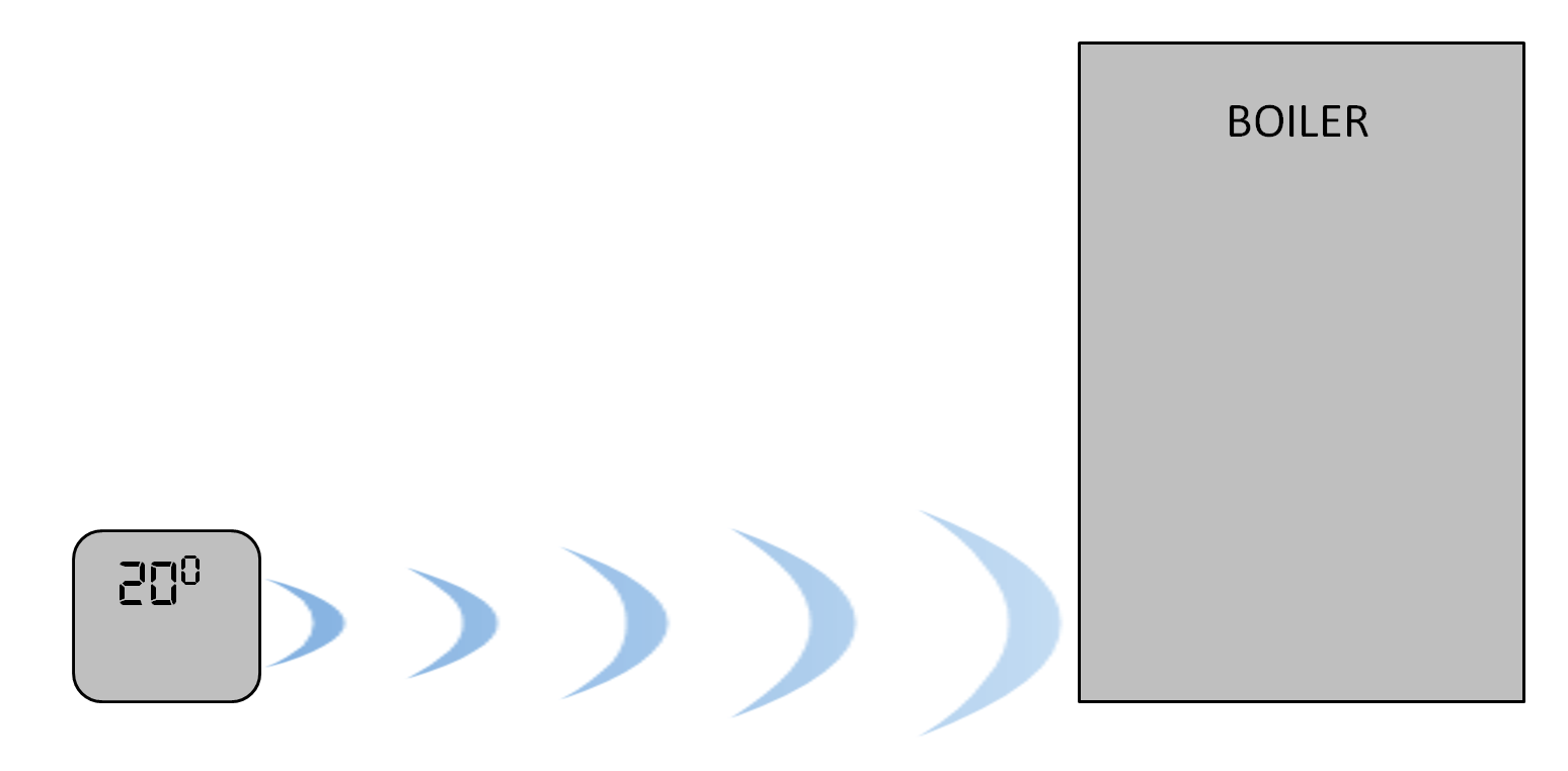

Options for a wireless control for an Intergas Exclusive 36?
  1. Properly wireless, i.e. battery powered, not a wireless one with a big thick wire meandering over to the nearest socket. Or dangling down the wall if its mounted there.
  2. Preferably one which will talk directly to the boiler, not via a receiver bolted to the wall next to the boiler and more chuffin wires.
  3. And preferably one I can work by poking at it, not by having to install an app on my phone or tablet.
Currently got all 3 of those with a nigh-on 20 year old WB boiler and WB badged Honeywell Digistat. Are we really going backwards?

Anyway, so what I want, is this:
Not this
or this
or this
The programmer must use Opentherm to talk to the boiler to control its modulation, not just do on/off.
I would very much have liked the programmer to be battery powered, but I did wonder if this might be the case:
There are no battery powered OpenTherm thermostats, no. The two-way flow of information between thermostat and boiler is pretty much constant with an OT stat, so it would burn through batteries far too quickly
If it has to be externally powered then so be it but I really do not want to see the power lead, so I really want one where I can fix the unit to the wall and bury the cable.
And I would prefer the programming to be done on the unit itself, and not have to install some app on another device, but that may be another so be it.
