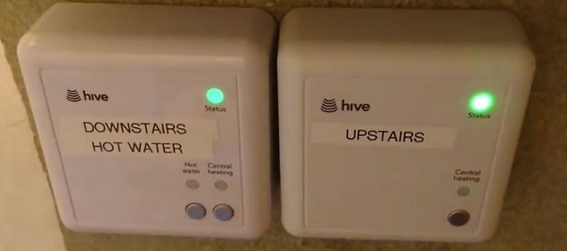

the receivers are normally located at the wiring centre (usually adjacent to the motorised valves) and the Hive thermostats located where the original thermostats were and communicating with the receivers wirelessly.
I don't see a problem with moving the receiver downstairs into the garage, but I normally like to have them together next to the wiring centre. (OCD again!)

Does the wiring center at the hot water tank have the ability to provide power for the new hive receiver?
It should do, and probably will, but it depends upon the layout of the various components in your home and the personal preferences of the original installer. There are many ways of wiring these systems and I don't find many that are exactly the same as another. [Except sometimes in the case of identical new builds] so I can't say for certain, but would expect it to be so.
If it's moved to the boiler then would it be difficult to connect the receiver to the wires to control the valve?
Maybe not, provided that the boiler is located adjacent to the motorised valves or wiring centre, but yes it would be difficult if the boiler is further away. As I said before, your room thermostats will not be wired to the boiler, so there are no suitable existing wires for the Nest receivers to control already at the boiler. It could be done, but you would need to run new cables from the wiring centre / motorised valves to the boiler just for the receivers.
Remember, the Nest receivers will be operating the motorised valves not the boiler. [The motorised valves actually control the boiler and not the thermostats]

Thanks. House is only 1.5 years old so hopefully everything is tidy-ish in there. Boiler is quite a bit away from the water tank, so looks like I'll be asking them to install it at the wiring centre on the water tank!
Ive done a few multizone installs on newer builds where the original stats were wired. Its a fair bit more work to fit the receivers into the airing cupboard but not impossible as the wiring centre should be in there. Logistically, putting the receivers near the boiler would be a mare.
