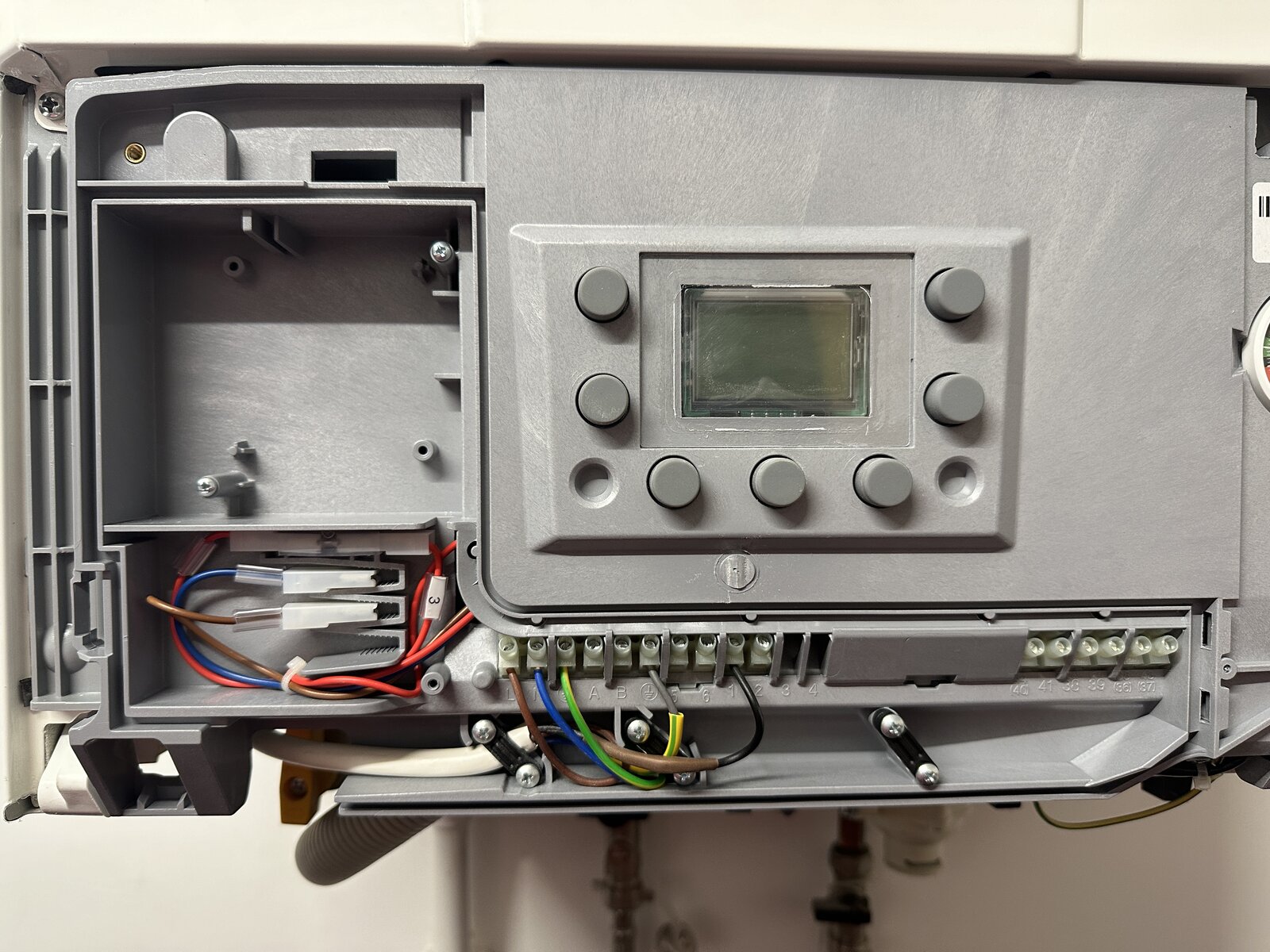

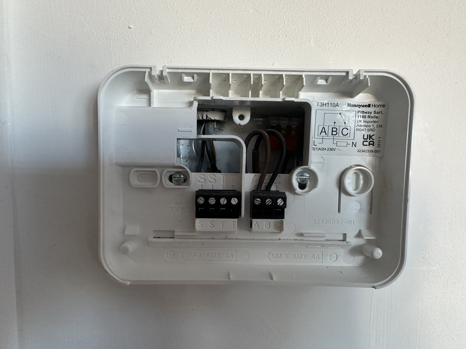

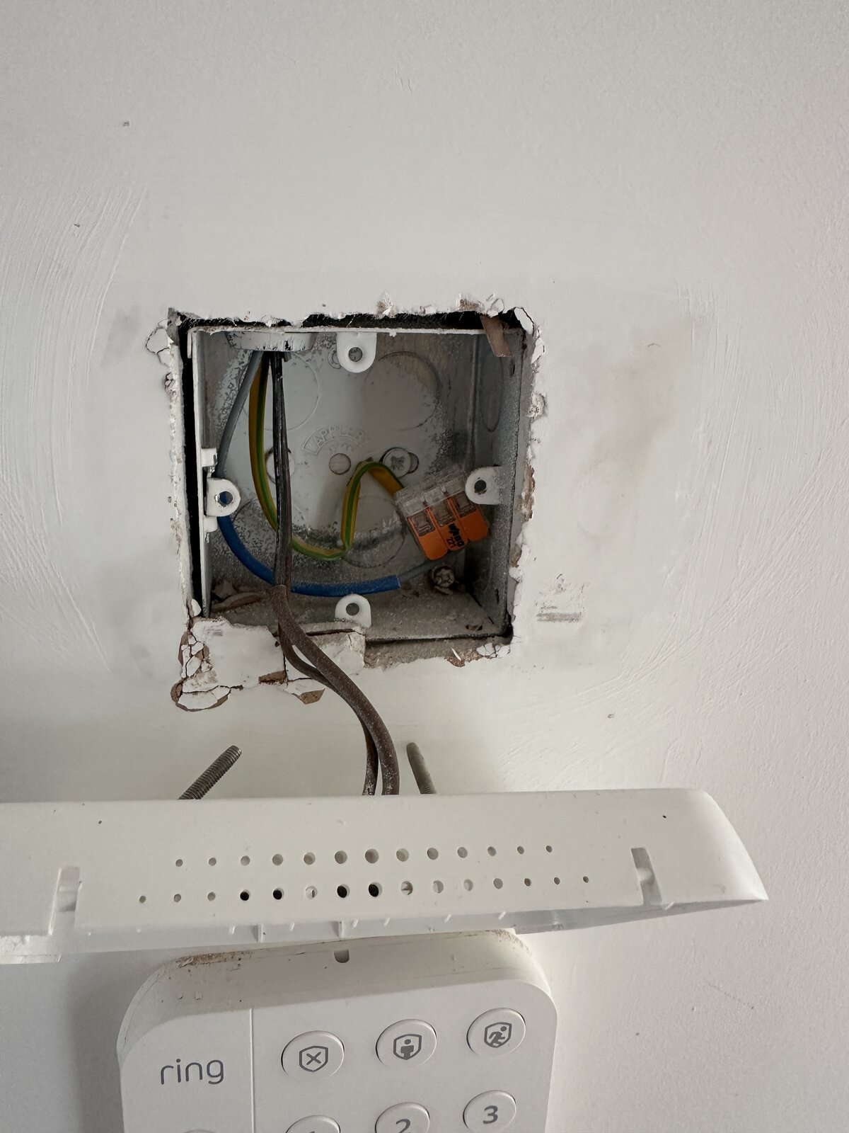

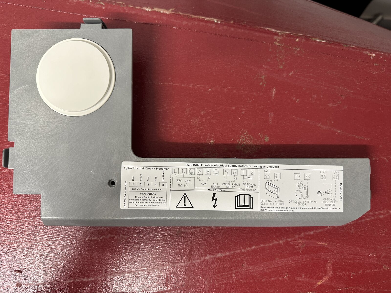

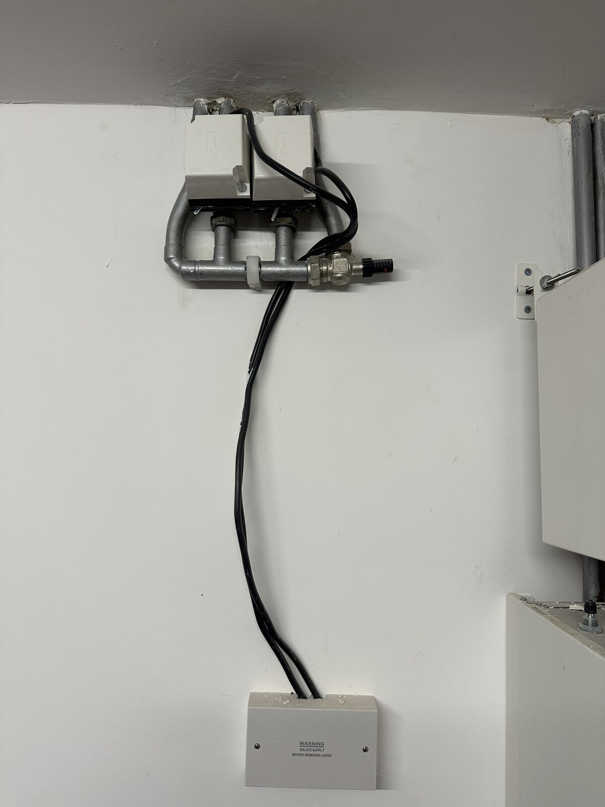

Ive bought hive multizone on a Black Friday deal and want to get it installed this weekend but trying to get my head around installing the receivers is proving tricky.
I have an Alpha etec 28 combi boiler with wired Honeywell t3 thermostats (downstairs & upstairs) and danfoss zone valves. Where is best to install the receivers and what wires go to what?
I’ve attached photos of all parts of the system.
Thanks for the help!

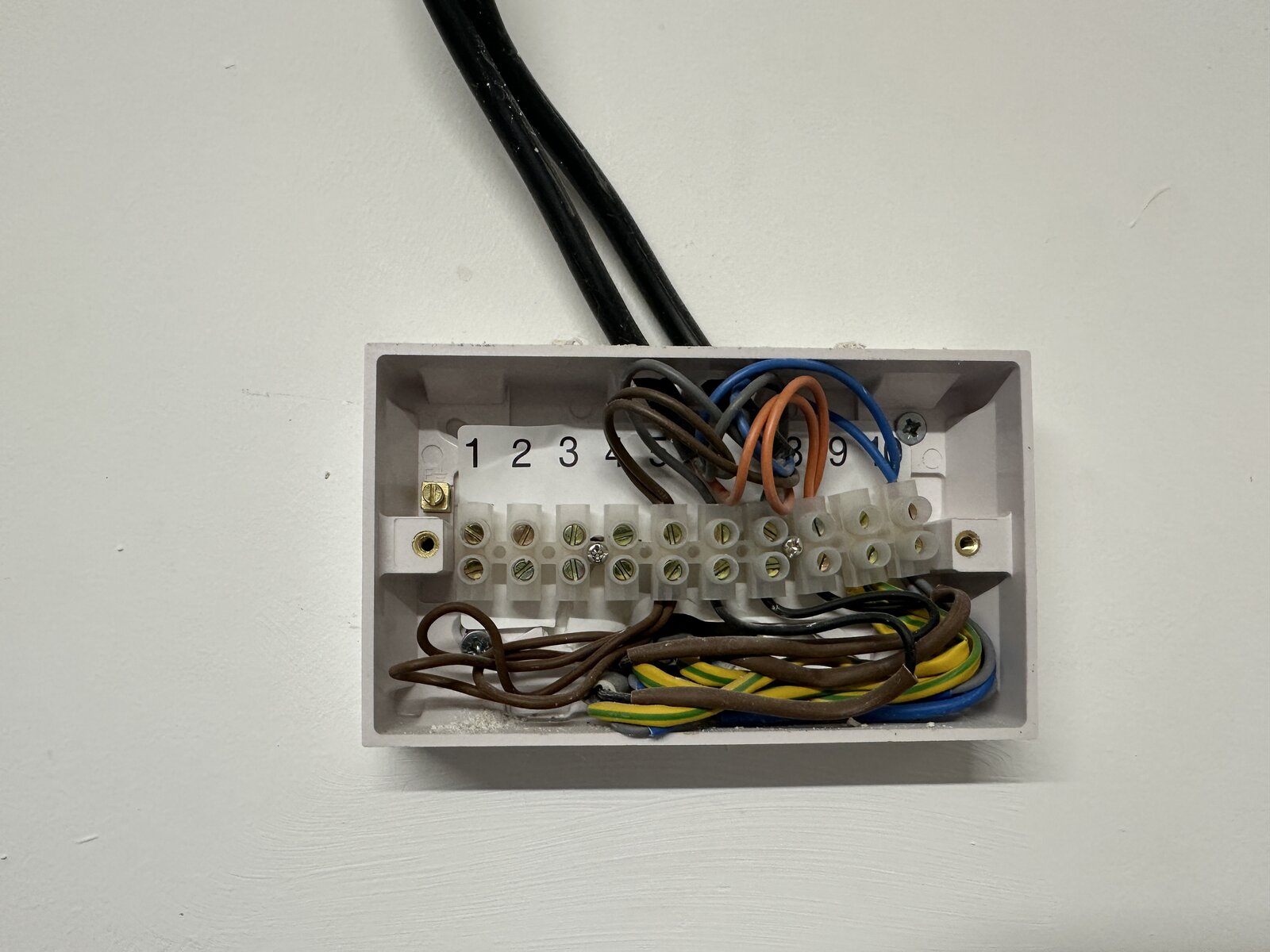

I would put Hive’s near the wiring center and take permanent live and permanent neutral along with the live and switched live that feeds the thermostats and place in the Hive receiver. Do the same for the other one.
Just to add, if you were going to connect the Hives to the wiring centre...
Terminal 5 is the permanent Live
Terminal 10 is Neutral
Terminal 9 is Earth
Terminals 6 and 7 are where you would connect the switched lives from the Hive receivers
Terminal 8 is the switched live returning to the boiler.

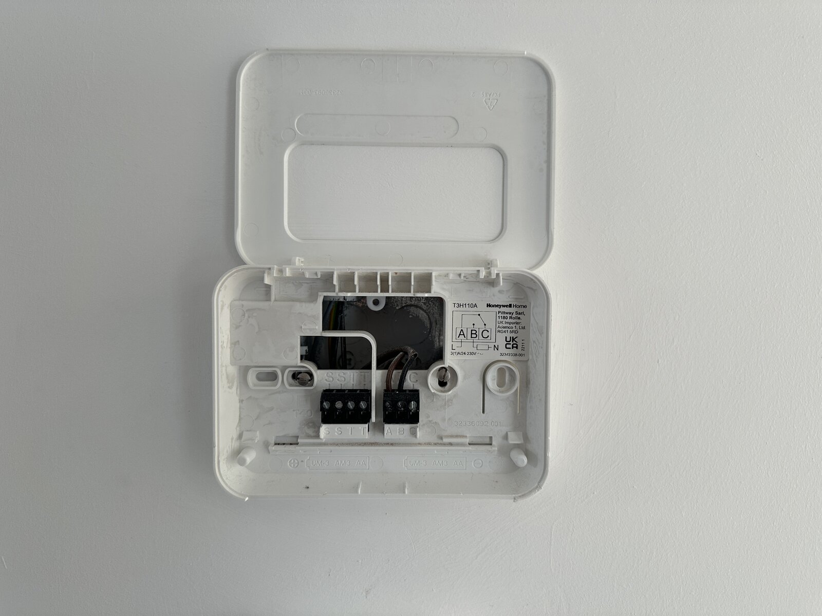

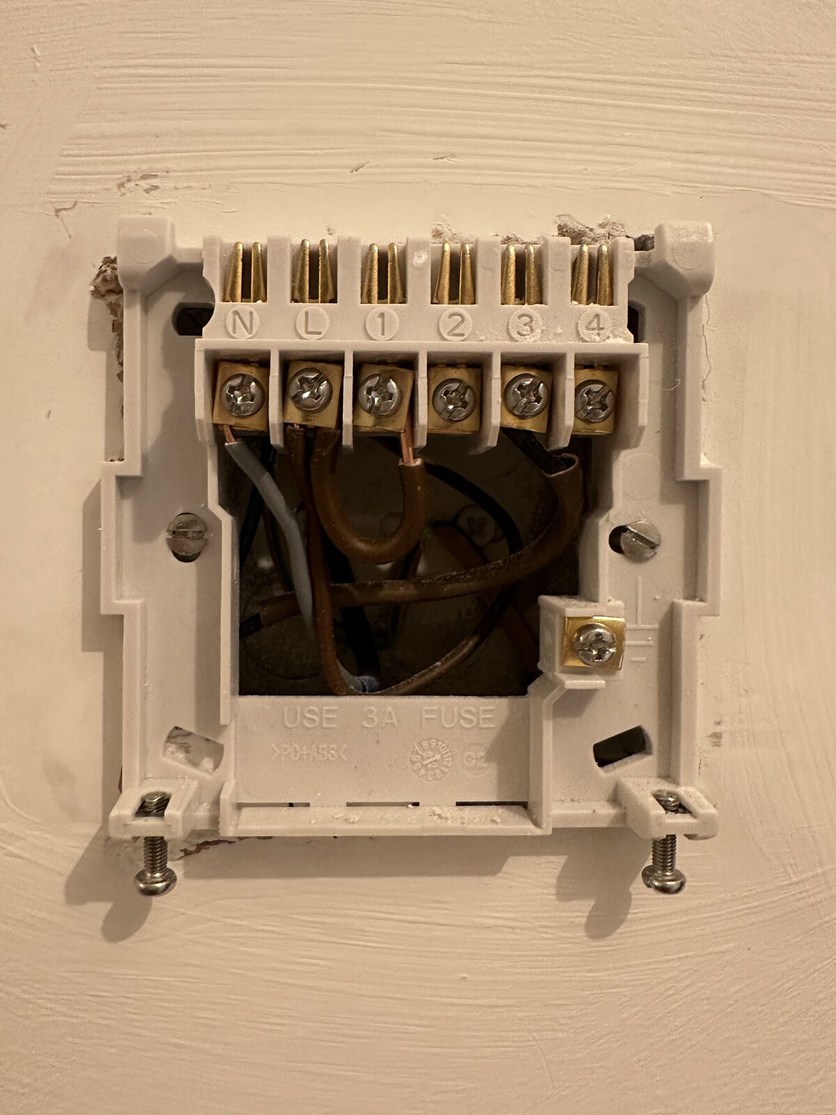

From reading a similar forum that @CBW responded to does the wiring principle below apply? I’ve seen a few things warning against the loop to com 1 but not clear if that’s relevant for my system.
Once you confirm if the grey is neutral then:
Brown to L
Grey with blue tape or sleeving to indicate a neutral wire to N
Link a wire from L to Com (1)
Black wire with brown sleeving to heating on (3)
Park the earth in earth terminal or leave in connector block.
Unlike many other posters, your grey wires are connected to neutral at the wiring centre. They are also oversleeved in blue behind the thermostats.
This strongly suggests that they are neutrals!
Brown to L
Yup, that's it. Simple really! :)

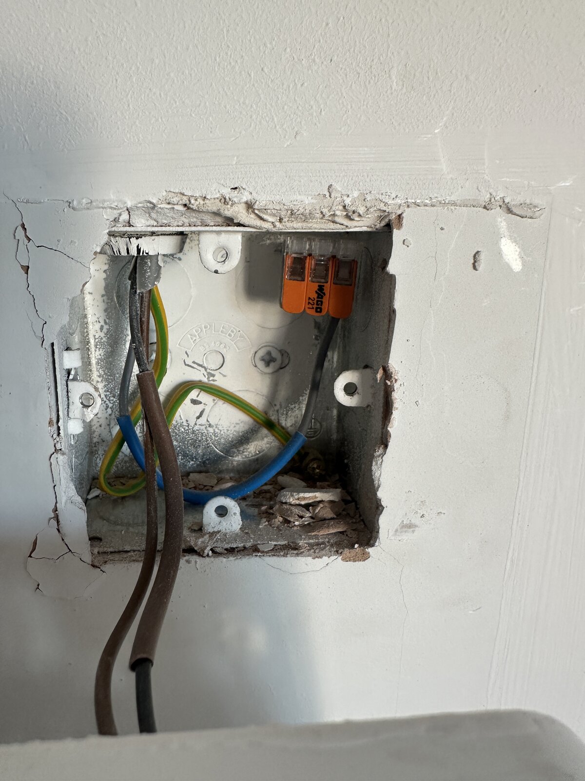

managed to get round to installing and did so as per the list above, all receivers and thermostats work. However, when I turn on either the upstairs or downstairs thermostat they turn on the full heating system. Am I missing a step with the wiring or is it something that I need to adjust in the app?
How did you connect them in the end - did you place the receivers where the old stats were, or did you wire them in to the wiring centre?
Went with locating them where the original thermostats were. If there was anything that went wrong (typical it has done) it could be worked through methodically
If there were no changes at the wiring centre, then everything should work exactly as it did (assuming the system was working correctly before!).
Your wiring appears correct at the back plate.
Is the whole system coming on, because the second thermostat is also calling for heat?
May be it's a set up problem; have the receivers been correctly paired to the thermostats? I don't even know if it's possible, but could one thermostat be calling for heat from both receivers?
