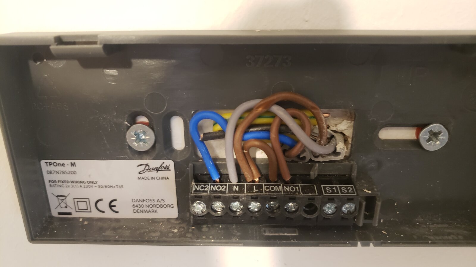

Hi
We've moved into a new build house that has a Danfoss TPOne-M Electronic Programmable Room Thermostat with Domestic Hot Water Timer connected to an Ideal Logic Heat H18 Boiler. I would like to replace the TPOne-M with a Hive Dual Channel system. I'm happy to fit the Hive receiver at the location of the TPOne and although I appreciate that the Hive controller is wireless and could go anywhere, I am likely to fit it in the hall alongside the receiver. I believe I have worked out how to swap the wiring from the TPOne over to the Hive receiver but the colour coding of the existing wires is throwing me a bit and I don't want to risk damaging the boiler so would very much appreciate anyone's help in checking if my assumptions are correct.

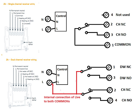

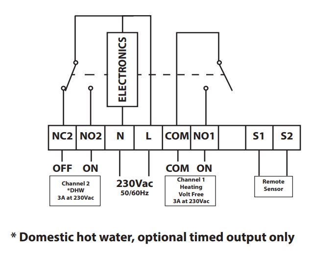

I have inserted images of the existing wiring on the back panel of the TPOne, along with the connection diagram for it, and the connection diagram for the Hive receiver.
With the attached in mind I am assuming that I should do the following:
Transfer the 1st brown wire currently connected to the TPOne "L"ive terminal to the Permanent Live of the Hive
Transfer the grey wire currently connected to the TPOne "N"eutral terminal to the Permanent Neutral of the Hive (this throws me as I would expect this wire to be blue?)
Transfer the blue wire currently connected to the TPOne "NO2" terminal to terminal 3 (Hot Water On) of the Hive (again I'm confused by this wire being blue?)
Transfer the brown wire currently connected to the TPOne "NO1" terminal to terminal 4 (Heating ON) of the Hive
Finally - As can be seen there is a link from the L terminal of the TPOne to the COM terminal. I think I have read on this forum that I wont need to replicate that link as this is effectively done within the Hive receiver when it receives relevant calls for heating and hot water but I'm not sure?
I will ignore the NC connections at terminals 1 & 2 of the Hive panel as these don't appear to have equivalents on the TPOne-M?

That all sounds good to me. The blue / grey wire colours are a bit odd, but would have been chosen by the original installer. However; it is what the wires are connected to at each end that determines their function, not the colour of their insulation.
You are correct that you don't need connections to Hive 1 & 2. You are basically swapping a device with two on/off switches for another device with two on/off switches. So it's a like for like exchange as below:
Danfoss N = Hive N
Danfoss L = Hive L
Danfoss NO1 = Hive Heating on 4 (also marked NO)
Danfoss NO2 = Hive Hot Water on 3 (also marked NO)
As you also have figured, the live link is not required as the Hive dual channel version has it already made internally.

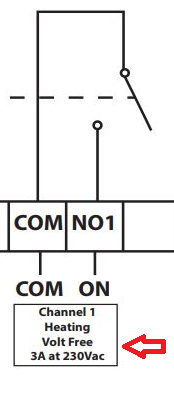

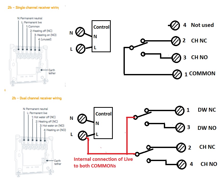

One of the channels is shown as being volt free......
In the Dual Hive both switch COMmons are connected internally tp Live
Indeed, but that's irrelevant to the OP. His installation isn't voltage free, its linked to a 230V Live! Therefore the Hive Dual Channel is fine. As your diagram shows the link he requires is already made internally for him.
