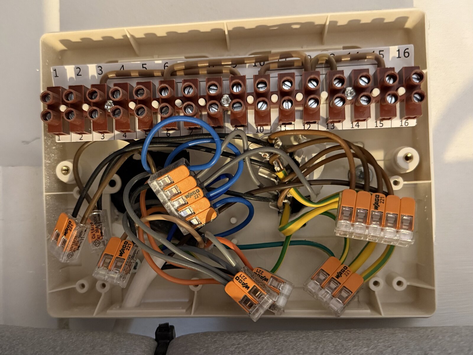

Below is a picture of the wiring centre that is next to the boiler.
Thanks in advance
You need to work out whether those grey wires are neutral, if so, then you could utilise those either there or at the the TPone. Looks like there's a spare brown in the Wago - if it's permanent live then you can use that, it again at the TPone. Depends on where you want Hive receivers
Looking to have the Hive receivers next to the wiring centre and then if the wires going to the Danfoss thermostats is redundant removing them
Ok, so you do still need to ascertain if those greys are neutral and if they are all used - if they are you need to add an additional wago.
You need to work out which is permanent live - some greys are but could also be the brown. Then you just need to alter the switch wires.

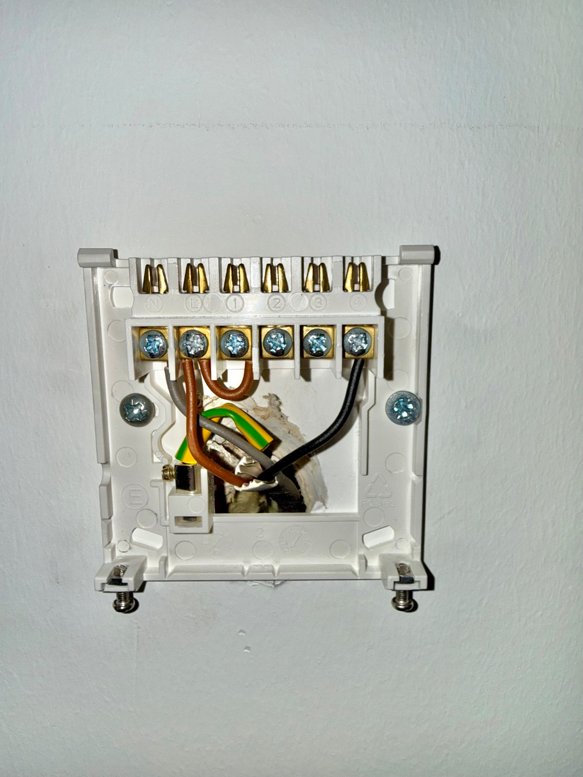

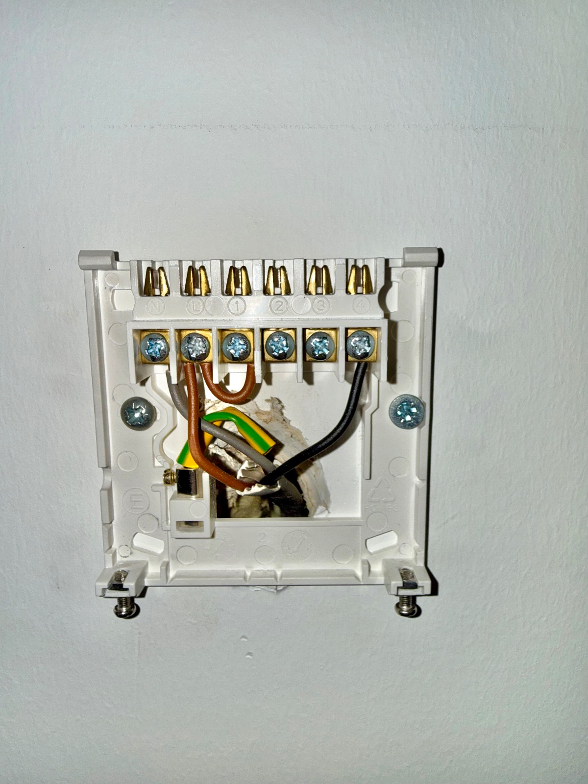

The dual receiver was wired up as per the wiring diagram on the hive website however, the hot water programmer previously was wired like this.
That looks like a heating wiring backplate. Can you show the wiring of the Hive? Did you get a dual channel?
That last image was the wiring to the old hot water programmer.

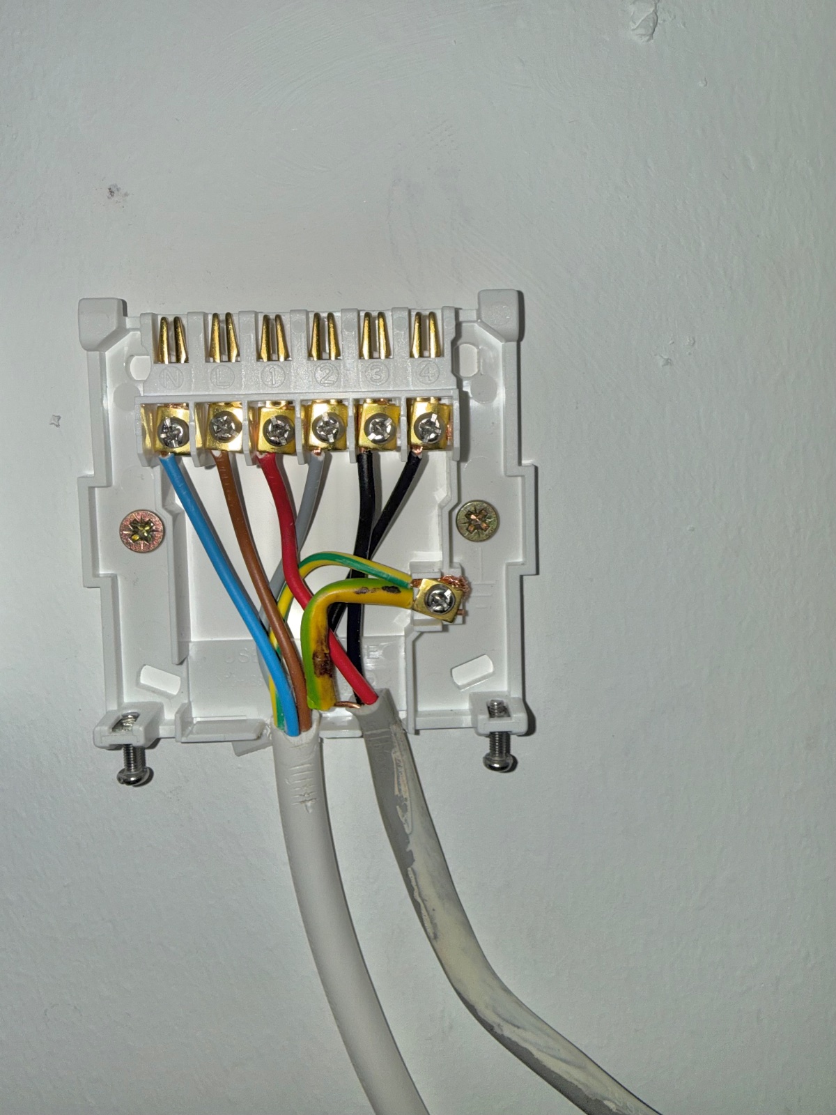

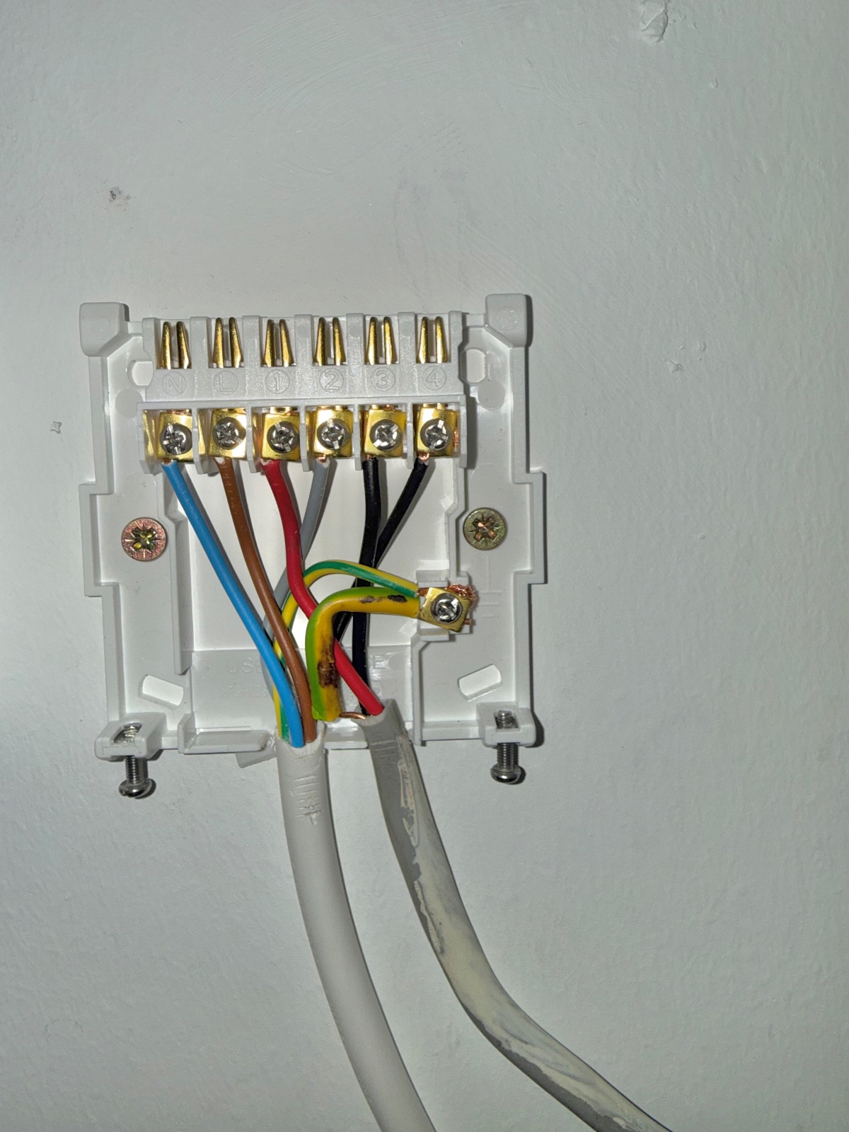

Below is the current wiring to the dual hive receiver

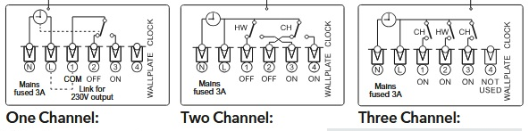

The one, two, and three channel versions of programmable thermostats may use the same back-plate, but are not wired the same, and I would not have expected terminals 1 and 2 to be connected to anything with a S Plan with two channel version only a Y Plan tends to use DHW off.
Yes ran new cabling, 1&3 for hot water programmer on and off and 2/4 for heating on and off
Heating for both the single and dual receivers is working correctly if is only the hot water that’s an issue.
When testing the receiver manually the hot water button did fire the boiler

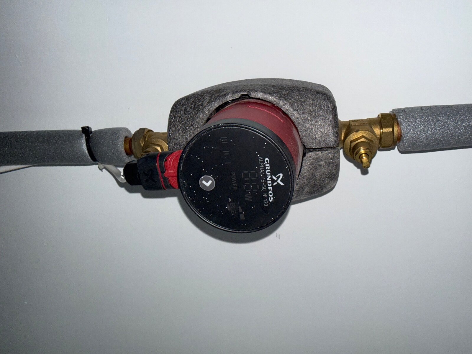

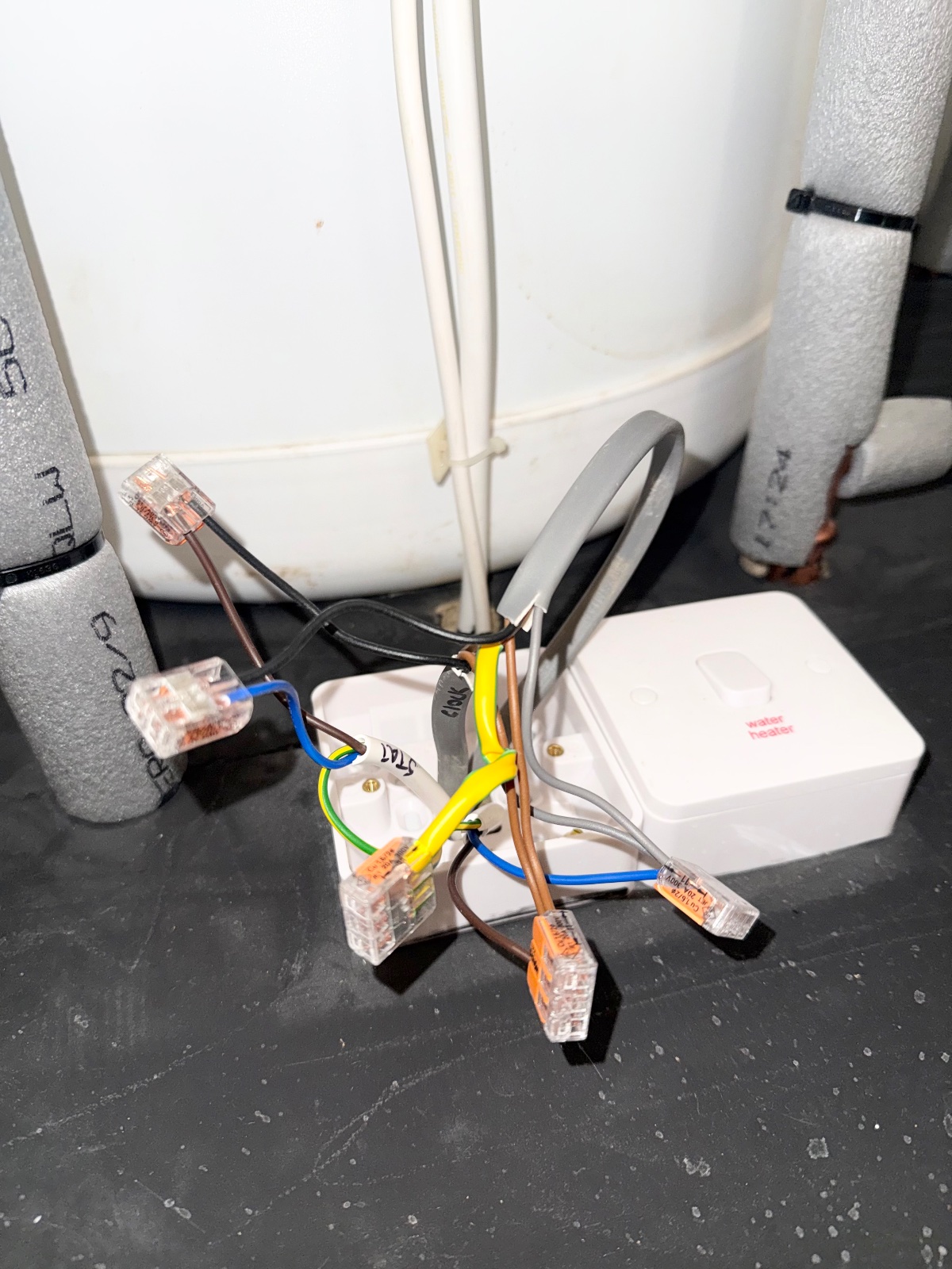

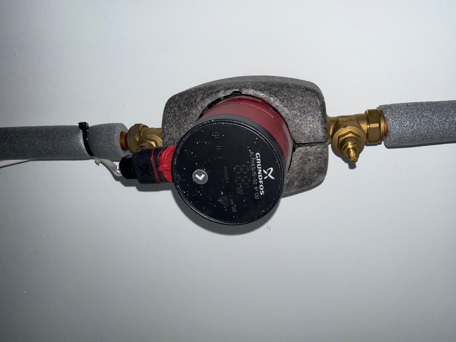

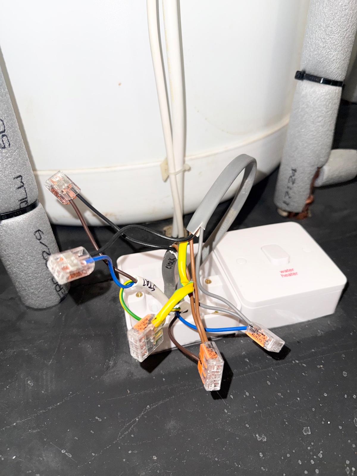

How would we know if we have a y-plan? We also have the following cable in the hot water tank which seems to power the programmer, a Grundfos pump, hot water tank thermostat.
Currently the pump is coming on when the hot water is turned on/boosted from the hive app.
