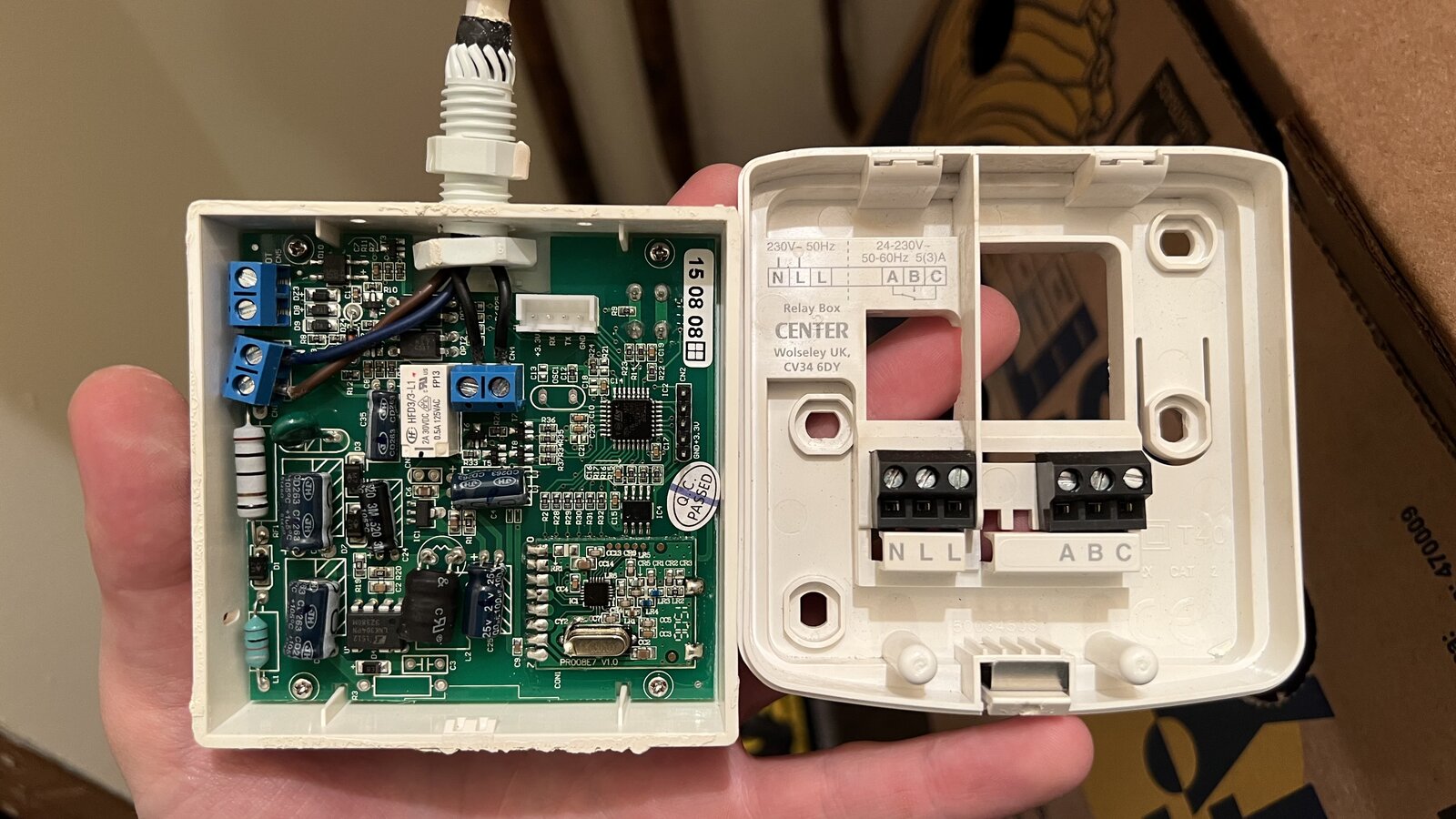

Hi guys. Needing some help again. (@RandomGrinch may be able to assist me again :P )
Switching wireless thermostats from left one (Vokera) to right one (Center).
Boiler is a Vokera Compact 28 SE
Age old question, which wires go where?
Many thanks.
Blimey, is this a hobby now! ;)
Blue to N
Brown to L
Blacks to A and B
(doesn't matter which way around)
No other links necessary.
