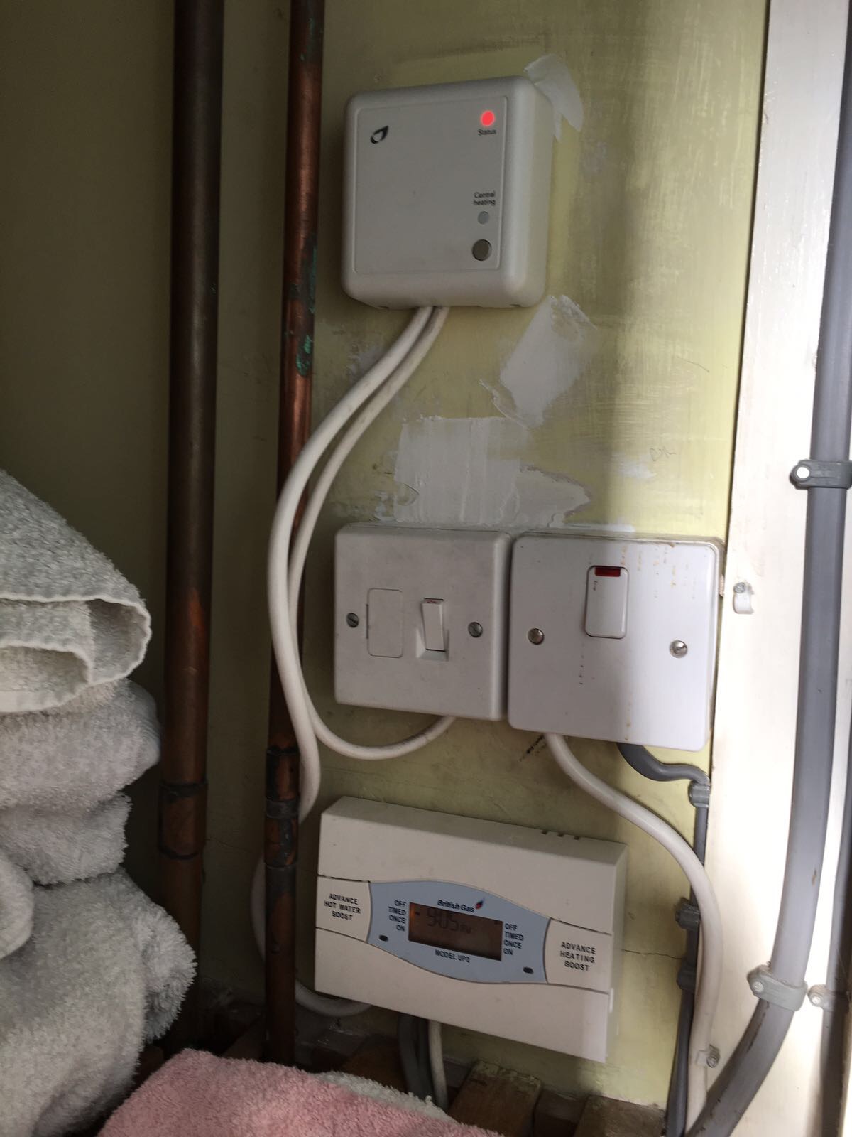

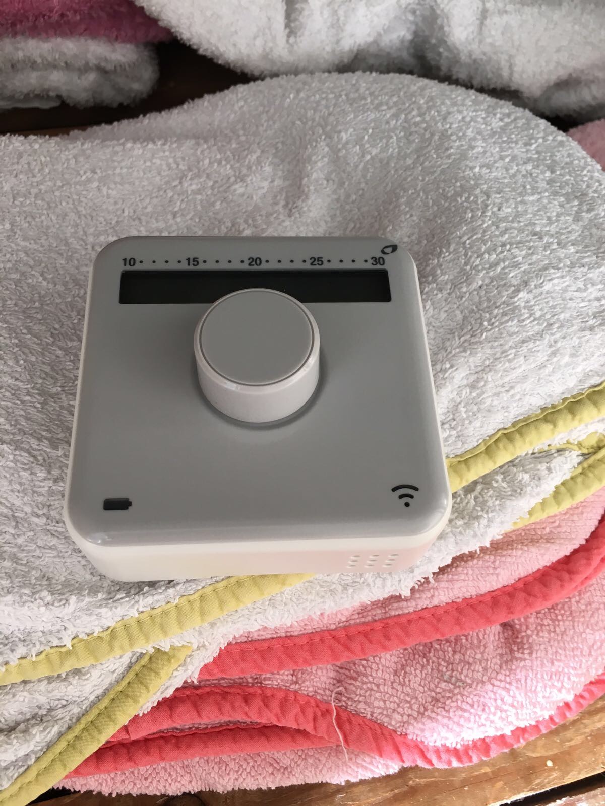

Hi there,
I recently moved into a new house which has a British Gas wireless thermostat. I believe the model is WL2. Im able to turn the heating on and off without any issues (as long as it the setting was set as 'on' within the main UT2 single channel timeswitch) however if the programme is left on timed, the heating just doesn't kick in.... even if the desired temp is higher than the room temp shown on the wireless thermostat.
I wasn't sure if it had to be synced again so I took the batteries out of the thermostat but then spent about 2 hours getting the two things to actually sync back. Sometimes it sync, sometimes it didn't. Just been a nightmare.
does anyone know how to get the system to work if you've set your main unit to timer?
Any help would be great!!!! Pics should be attached.

So I went to bed last night after finally getting the thermostat and the receiver to pair and set the heating to timed thinking itll never work (as it didn't before). Lo and behold I woke up this morn to find it had actually worked and thehearing now works on timed. I'm glad it's now all working but annoyed why it just wasn't doing it before!!!
