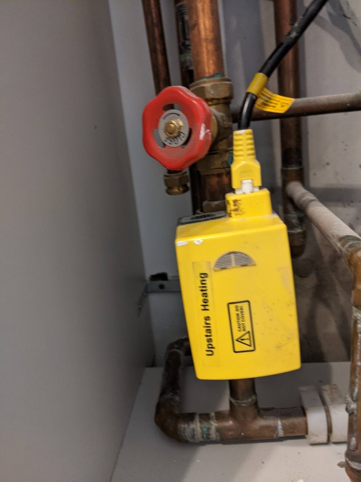

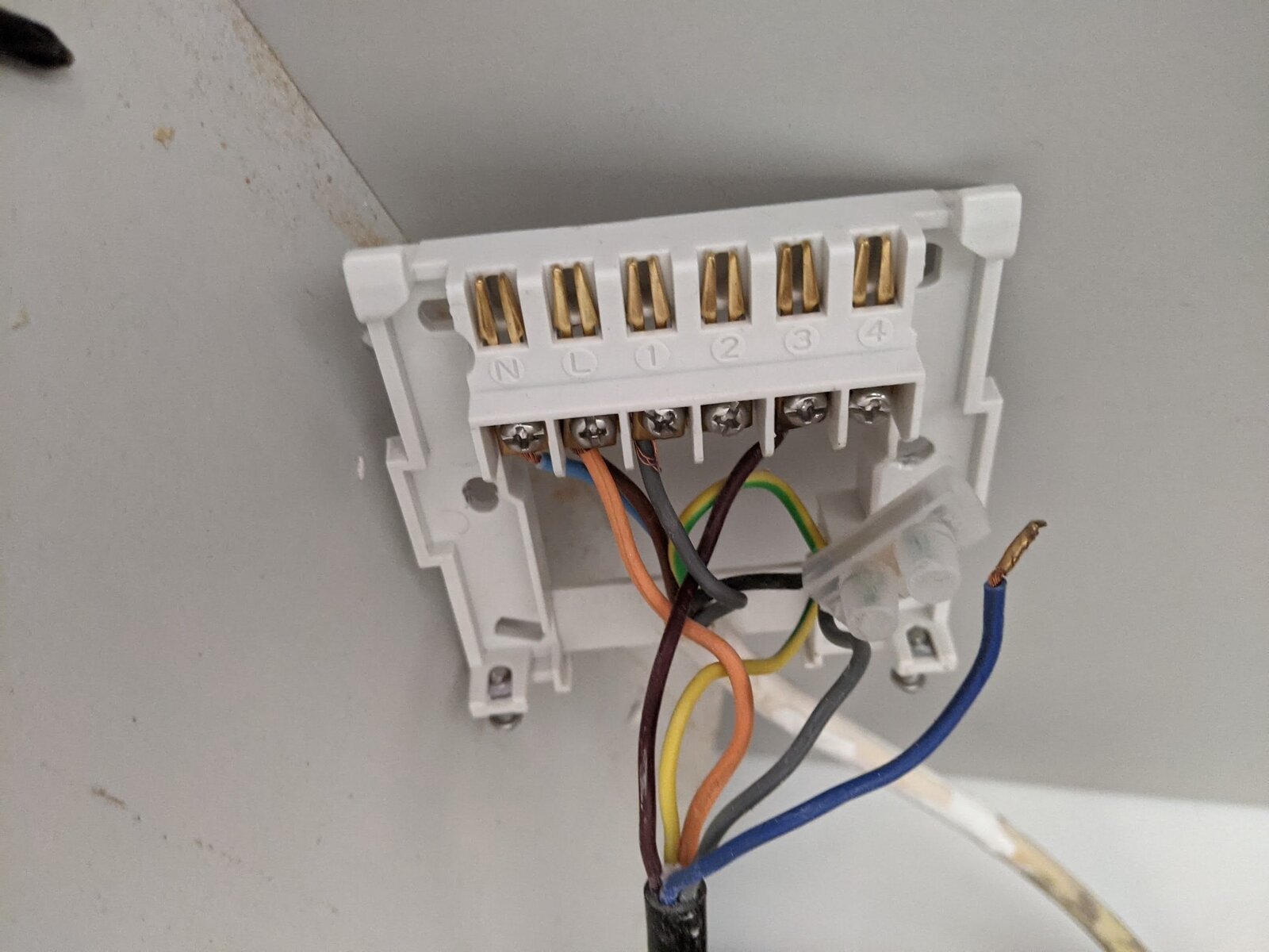

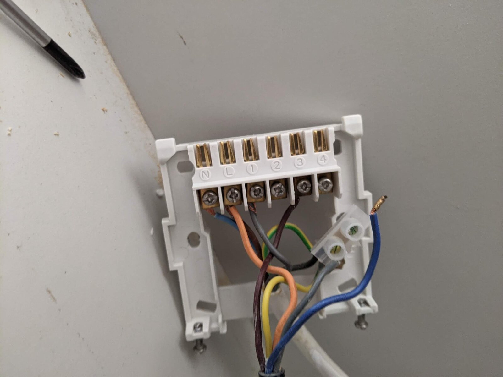

While moving my Hive single channel receiver one wire has come loose and I dont know where to re - attach it. See pictures. Black cable is from the 2 port valve (detach pro) and the white cable is from the Baxi combi boiler 830. Central heating not working though hot water is fine.
Does the blue wire need to be connected to Neutral on the receiver?
Any advice gratefully received.

Yes Blue is a Neutral for the 2 port. I think your orange and grey are opposite, but doesn’t matter.
Usually as follows:
Grey - permanent live
Orange - switched live
Green/yellow - Earth/cpc
Blue - motor Neutral
Brown - motor live
The whole thing looks wrong, not just that loose wire. Should be...
Blue to N
Grey to L
L linked across to 1
Brown to 3
Orange to boiler switched Live, not directly connected to Hive
Earth to earth

Thanks you very much CBW, I connected the loose blue wire to neutral and the central heating is back on. Very grateful.

Thank you very much muggles for the very helpful advice. I reconnected the blue wire to the neutral and it is working. I am not confident of correcting the other wrong connections as you mentioned, but will get a qualified person in at some point.
