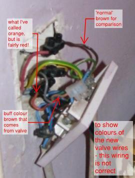

I'm trying to replace a sunvic SM5203 2 way valve with a honeywell v4043H motorised zone valve. The colouring of the sunvic wires and honeywell wires don't match: sunvic had: earth, blue, orange, yellow, and white. honeywell has: earth, blue, orange, buff, grey.
Are the wires equivilent with buff = yellow and grey = white? and also, when removing the wall plate the orange wire must have come loose, and there is no obvious gap that it came from.

the leads on the valves are
sunvic
blue= neutral
yellow =live to open
white = live to close
orange = switched live from valve when valve is open
honeywell
brown =live to open
blue =neutral
orange and grey =internal microswitch
Matt

so I will need to connect earth to earth (ashes to ashes),
blue to blue
presumably the brown must go to a (red) live coming up from the control panel.
but, when you say internal microswitch for orange and grey, these wires come out of the flex - what should they connect to?
also I don't really have brown like in other circuits, this is a very light skin tone colour, rather than brown?

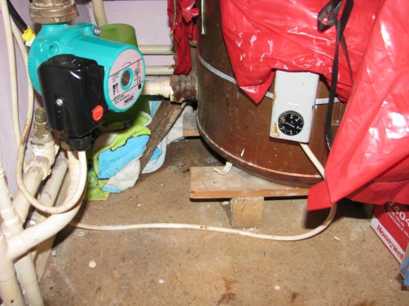

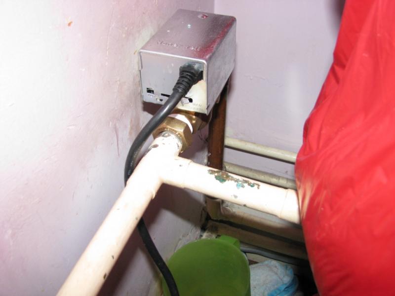

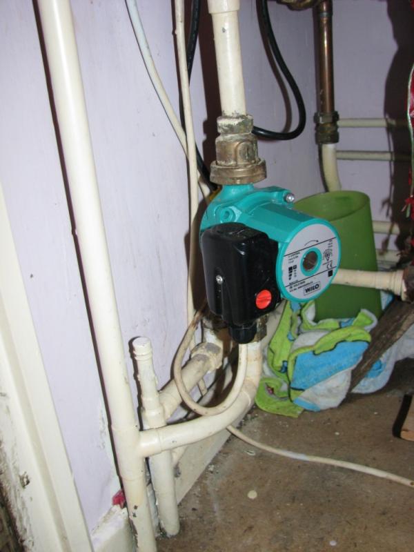

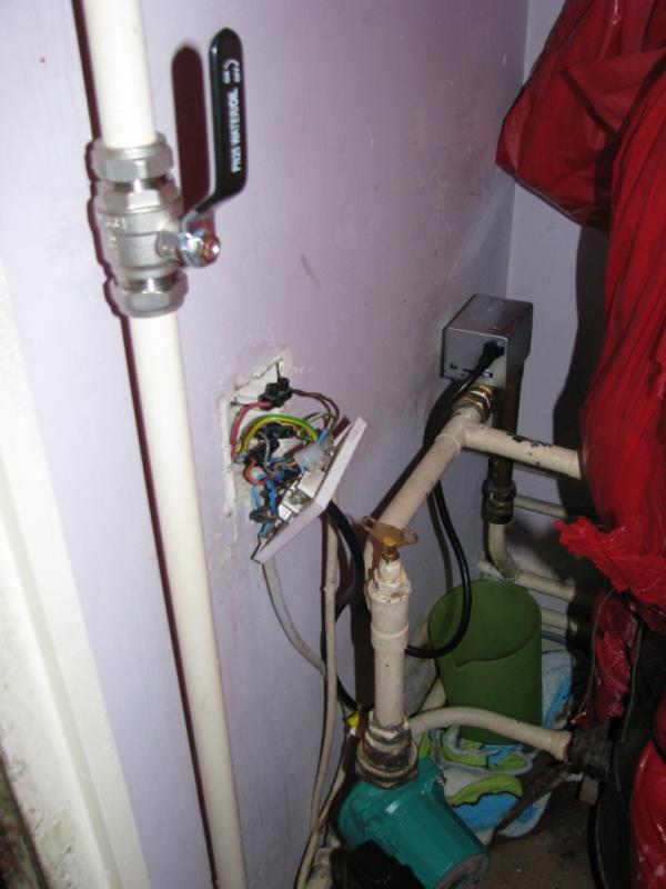

There is certainly only one control valve - it is after the cylinder so only opens/closes the CH circuit. We have never been able to set controls to have CH without hot water (so in winter tend to just have hot water set to off and the CH fires up regularly enough to keep the cylinder topped up. - this does lead to not having hot water when spring comes and we dont use the heating though!). perhaps when I've wired the valve in correctly the pump will be turned on from either the cylinder thermostat or the CH thermostat (although if all the doors and windows are open on a cold day, the cylinder could overheat?).

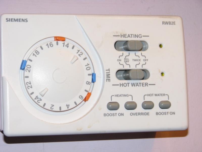

Matt - here are some photos of the system. They show the new valve and my bad guess at wiring. I've also included the thermostat and control box in case that is useful. The room thermostat (in the kitchen) is Sunvic TLS and the control box is Siemens RWB2E.
