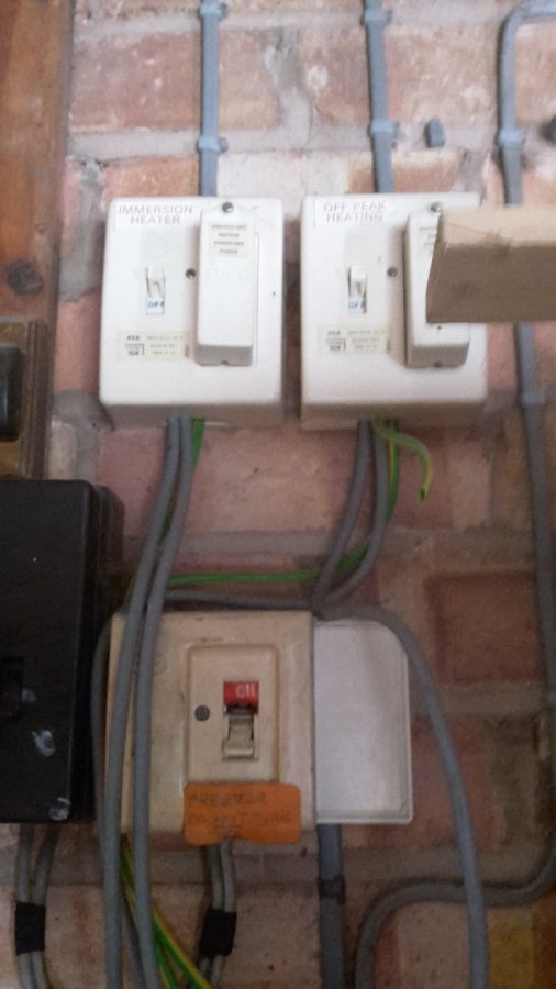

There are two disused Independent Switched circuits I could potentially use, one was for some old off-peak heating system.
I do not understand this, if it is an old off-peak supply, you'll only get power to the shed after midnight. That may not be what you want.
What is an independent switched circuit. Picture might help.
route on to this nasty switch
NAsty switch, what do you mean? More pictures, please.

There are two independent circuits each isolated by an old 45A switch fed directly from the tails effectively by-passing the main fuse board.
It looks like these used to be used for an old immersion heater and Off Peak heating (they are labeled as such).
Need pictures of this. And the associated wiring.

Here are some photos of my fine example of modernity....
You can see the two independent circuits with 45A switches side by side, fed directly from newer tails provided through the Henley Block below.
The other switch below is for the Boiler Circuit, that seems to be fed from some wires coming out the bottom of the main fuse board, maybe they're just taken straight of the live feed in, who knows?
The supply to the boiler is less of a concern than the feed to your main consumer unit, thats rough as!
That can be no more than a 10mm² supply, if you're lucky, could even be 6mm², hard to tell. Floating earth block is always nice to see

I can't see an earth to the MEM switchfuse (the one with the orange label) which feeds the socket below (which seems to be for a freezer according to the label) and the boiler
@op generally what you have is a bit of a mess, ideally it could do with sorting out, but if you just needed the shed supply on now with a view to sorting out the rest later. The way to do it would be to fit a small 1 or 2 way unit or switch fuse off the henleys. SWA would be glanded straight into unit, not messing around with an external box. So when you lay the cable in drill at a downwards angle and leave long enough. Don't even attempt to connect it yourself, to make the henleys dead requires touching the service fuse which can be hazardous.

I can't see an earth either, although I've never looked until now, that is a worry.
Okay, Adam thanks for that, it is a bit of a mess, I'm not about to touch anything which I cant isolate (safely), I think I will call an electrician.
